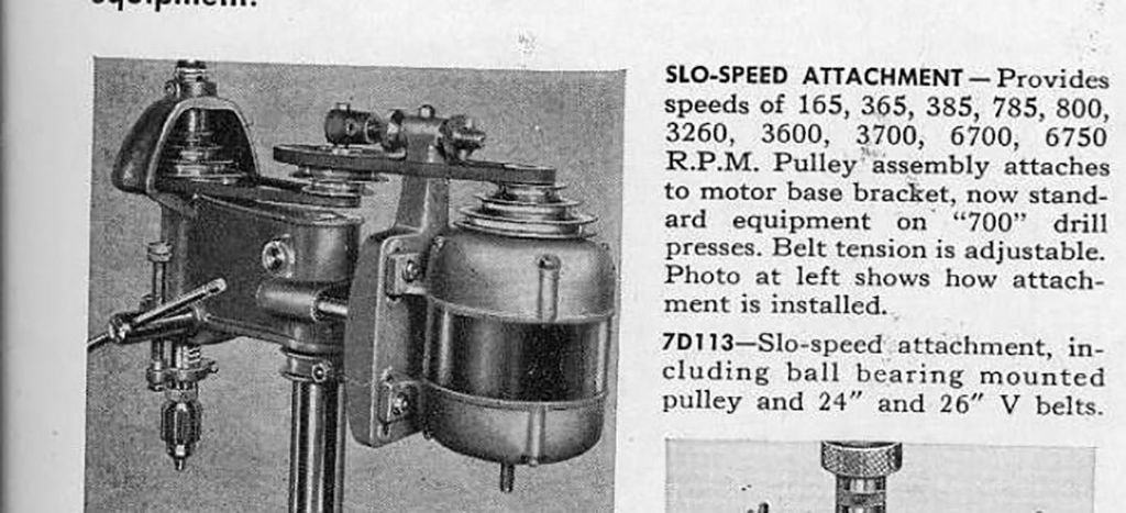

                    #315022
                    mark smith 20
                      @marksmith20
                      Without knowing the model of the drill or how the pulley attaches ,this is what they sold which included the spigot attachmentment to mount to the motor bracket. Some models already have this way of attachment.
                      #315023
                      Clive Foster
                        @clivefoster55965
                        Mark
                        Interesting picture of the official slo-speed attachment. Looks an incredibly cumbersome way of doing things with a very strange set of speeds. Probably a bit of belt threading and un-threading involved to get them all.
                        Reference I found, on Practical Machinist site with no dissenting views from the usual folk who would know, said that the slow speed set-up was to invert the motor and use an auxiliary shaft with a single speed reduction set-up. No pictures that I could find unfortunately. Wonder if there was another version or perhaps an aftermarket kit.
                        Clive.

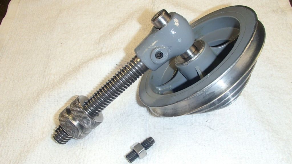

                          #315035
                          Adrian R2
                            @adrianr2
                            I've been pondering the same for my recently acquired Buffalo. There's a nice idea here for a planetary gear pulley:
                            http://www.homemodelenginemachinist.com/showthread.php?t=21309
                            Edited By Adrian Rose on 03/09/2017 15:43:30
                            #315044
                            mark smith 20
                              @marksmith20
                              As far as i know if your drill has the right motor mount its just a matter of replacing the original standard speed pulley on this contraption with this pulley but im not certain as i dont have the drill press and the original poster hasnt stated what model and year his drill is. I think the belt length has to change as well.
