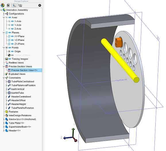

  • #735559
    David Jupp
      @davidjupp51506
      Not all that difficult to model in Atom3D – with some (probably incorrect) assumptions for items not clear in Nigel’s image.
      Assembly(sized)

        David J. –
        Thank you! That’s not ever so far off but I could not see the CAD possibilities as you can.
        The two large cylinders overlap by about half an inch, joined by a channel-section ring with holes for pipes through it, but I’d not represented these on my drawing. The top of the outer cylinder also has a large hole – for the chimney – holding a funnel-shaped fitting, also yet to be added to my partial drawing.
