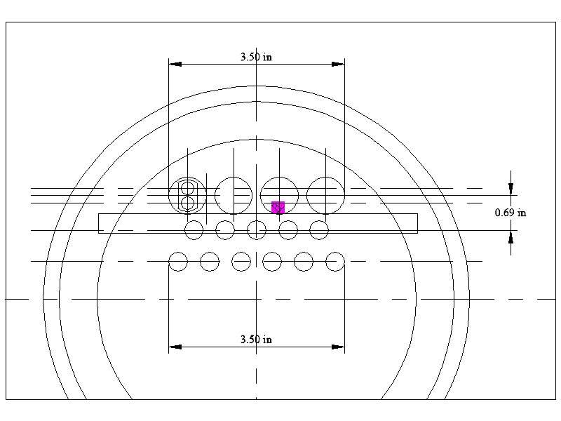

I don’t know what those diagonal crosses on the eccentrics are. They appeared when I copied the drawing across.
There no Blocks in the drawing. I don’t know if ‘Blocks’ are something to do with 3D work, but the tool-bar sign implies they are related to the ‘Explode’ tool that irreversibly breaks figures into separate lines. So are dangerous to try!

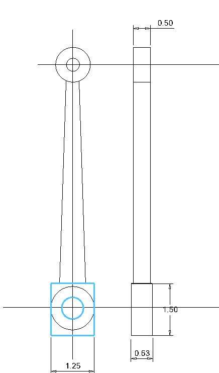

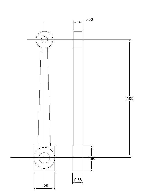

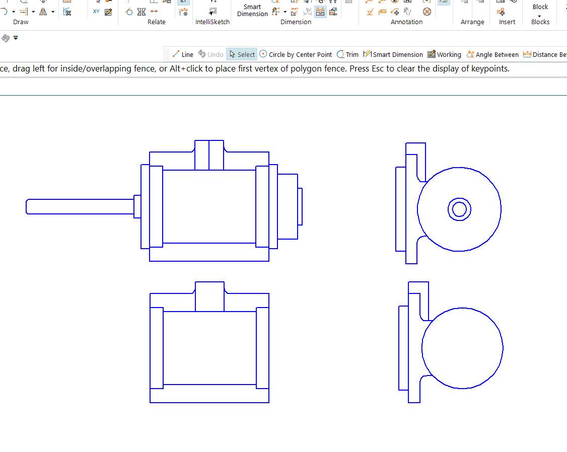

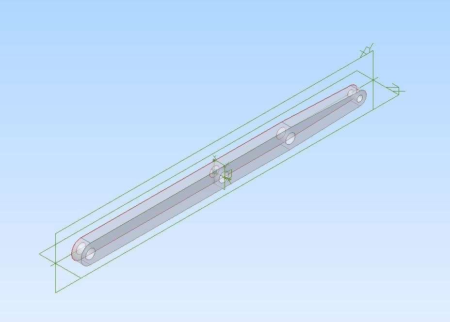

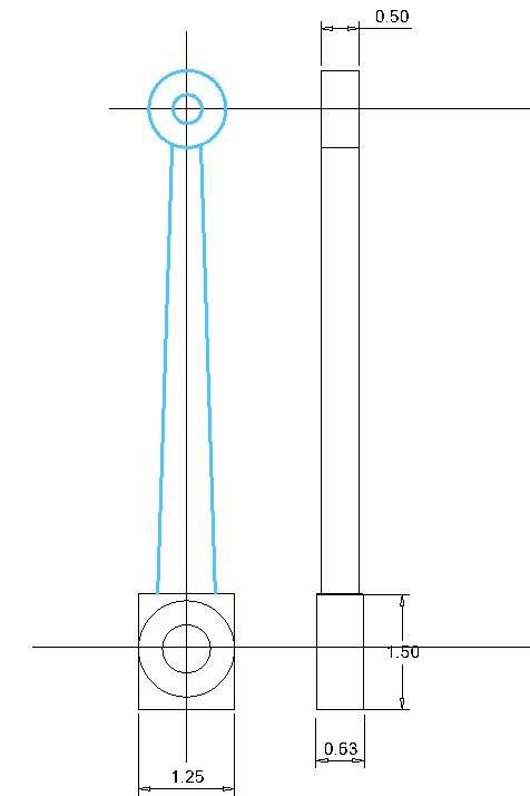

I asked Nigel to send me the file with the arrangement of his wagon’s engine, he sent it as the Alibre drawing file he shows in his earlier images.

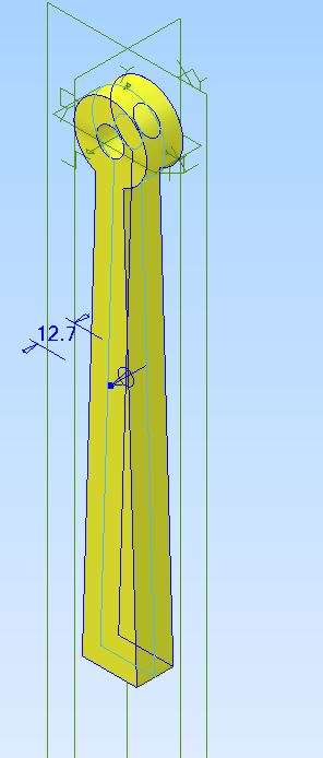

To show that rather than being useless the imported 2D file can be used to produce the 3D parts without having to start from scratch I picked one of the two conrods which are at the far left of the image.
Firstly I clicked “activate 3D Sketch” which is top left of the screen and then while holding down the shift key clicked on some of the lines, circles etc which turned them blue. I then clicked copy which put these blue lines into my clipboard.
I then opened up a new part file, clicked activate 2D sletch and clicked the plane I wanted to sketch on, in this case the XY plane. I then selected the “paste Stamper” and pasted the copied items to start the sketch of my part. I had to add a line to join the bottom of the tapered lines to close the sketch and also trim the unwanted part of the larger circle between the two tapered sides for the same reason (See later comments)
I then extruded this sketch mid plane to 0.5″ wide as per the dimension on Nigel’s file. I could also have taken other dimensions off his file if they were not shown
I then basically repeated the process for the big end, copy the rectangle and circle
Paste as a second sketch in the new part file, I also added the 7 “dimension to make sure it wa spasted in the right place.
Then extruded about the mid plane to 0.630″ wide
And there you have the basic conrod, I have not had to redraw or size the basic shapes, just put in a dimension for the extrusions.

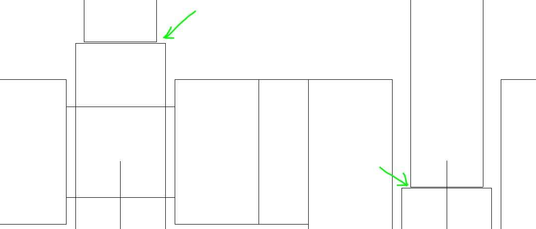

However having been able to look closely at the imported drawing there are quite a lot of issues with it that would probably mean it is better to start again modeling the parts from scratch. A couple of examples follow:
This is where the tapered part of the conrod meets the big end rectangle there are twin lines and they are different either side, I don’t think these are specific features more just an issue that was on the original Turbocad drawing that has followed over.
And when looking at them on the section through the assembled engine they are different again with the tapered rods not even connected to the big ends

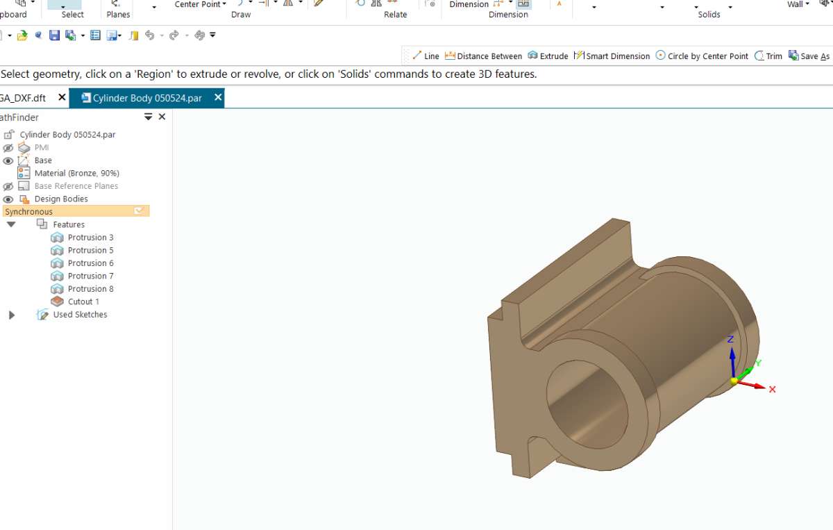

Lastly similar done with the basic cylinder, rectangle and holes copied and then pasted & extruded

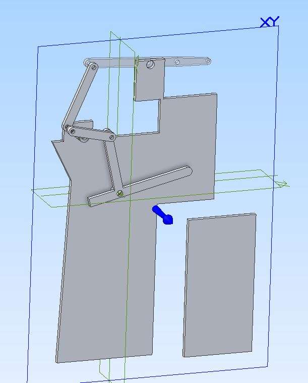

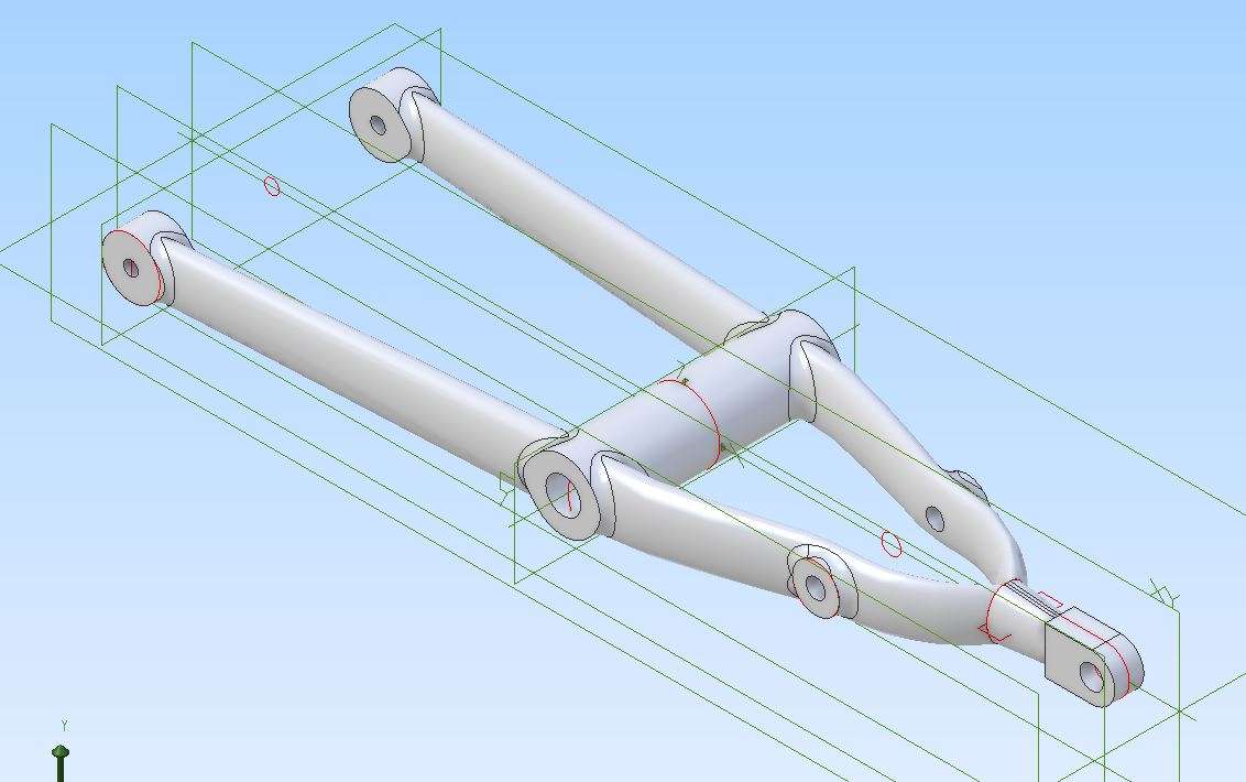

What you can do easily in 3D CAD is start with an empty assembly and add in say a couple of axes, and a plane or two – these for example representing spindle, back gear shaft, top of bed based on what you believe to be the driving dimensions.
After adding a few parts, you can even adjust the axes positions if needed or desired. It is simple to try a few alternatives. You can then design the headstock casting around the internal parts.
I’m still not averse to doing a quick freehand sketch to get a feel of a general layout before starting with teh CAd, really depends on the particular item.
If it is from a photo, sketch, patent drawing or etching thes edays I am just a slikely to import one of those images into Alibre and scale the image to the size I want to build at which may be based on a flywheel diameter or cylinder bore.
Once I have done that I’ll simply sketch a series of lines over that image which gives me the actual length and I can then base my sizes of parts on those.
I may not fully detail the part to start with, on the engien above which has a lot of linkages I first sketched them out as not much more than lolly sticks with hole splaced from the sizes obtained. Then assembled them on a rough frame that had the larger castings just drawn a srectangles.
This gives me enough to see how things move
From there I will then start to detail the individual parts so what started as the top beam sketched like this
Ends up like this after many tweaks and alterations that are needed as more parts are added and issues arrise
Until I have all the parts modeled, assembled and tried for movement which can still be overlaid onto the original image

I don’t know why that connecting-rod had those strange breaks. I’d probably drawn them as separate pieces but not assembled them correctly. The stray line could have been anything but was probably left from some change I’d made. Unless you magnify the display you don’t usually see things like that.
It’s also very easy to have such oddments lying directly below outlines, and they prevent moves like Extrude or (in TC) Join Polyline working. Fortunately the selection highlighting will reveal the little varmints so you can delete them.
I’ve found an equivalent in Alibre: minute black dots on the screen that magnifying reveals as teeny-weeny line trimming fragments sometimes quite a distance from the outlines. I am not sure how they happen but they prevent switching from Sketch to Model.

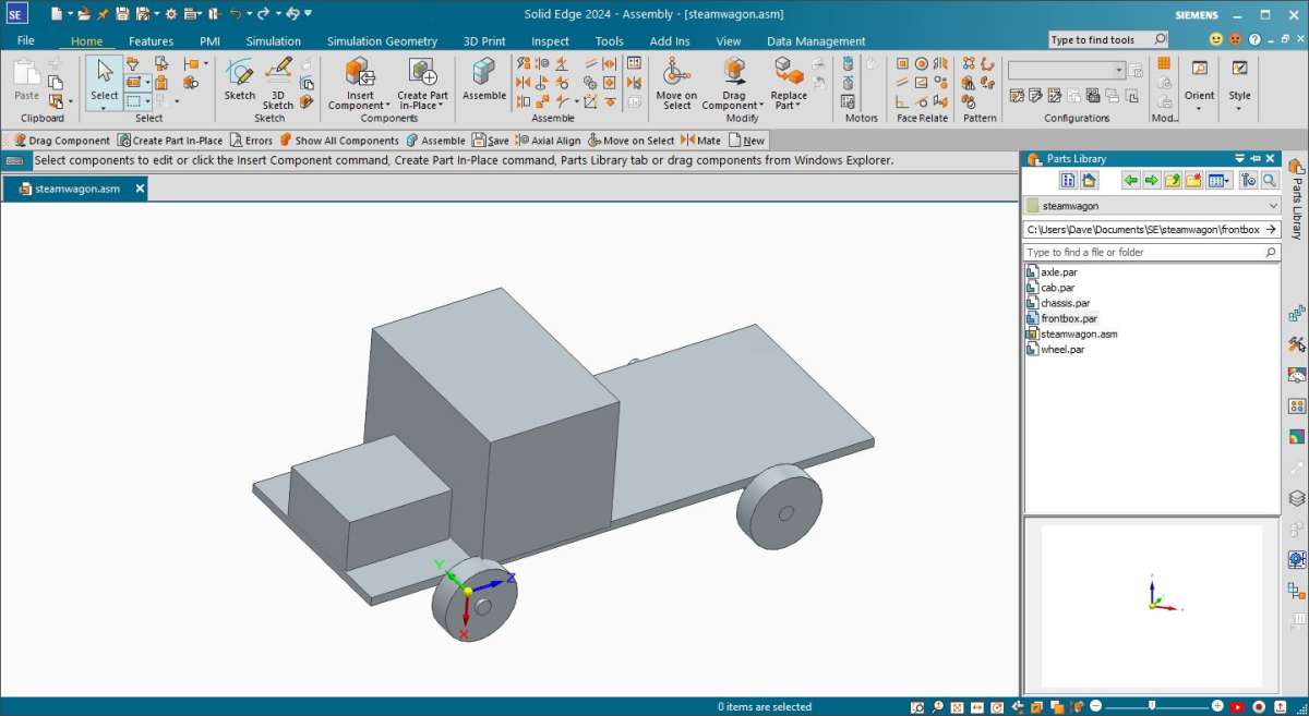

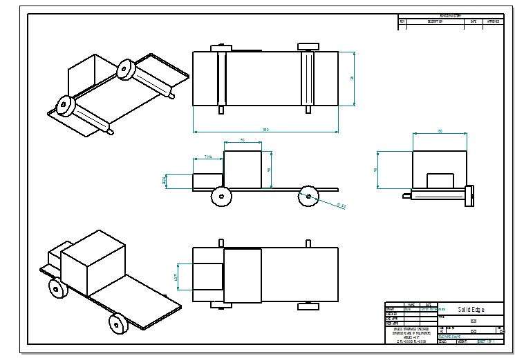

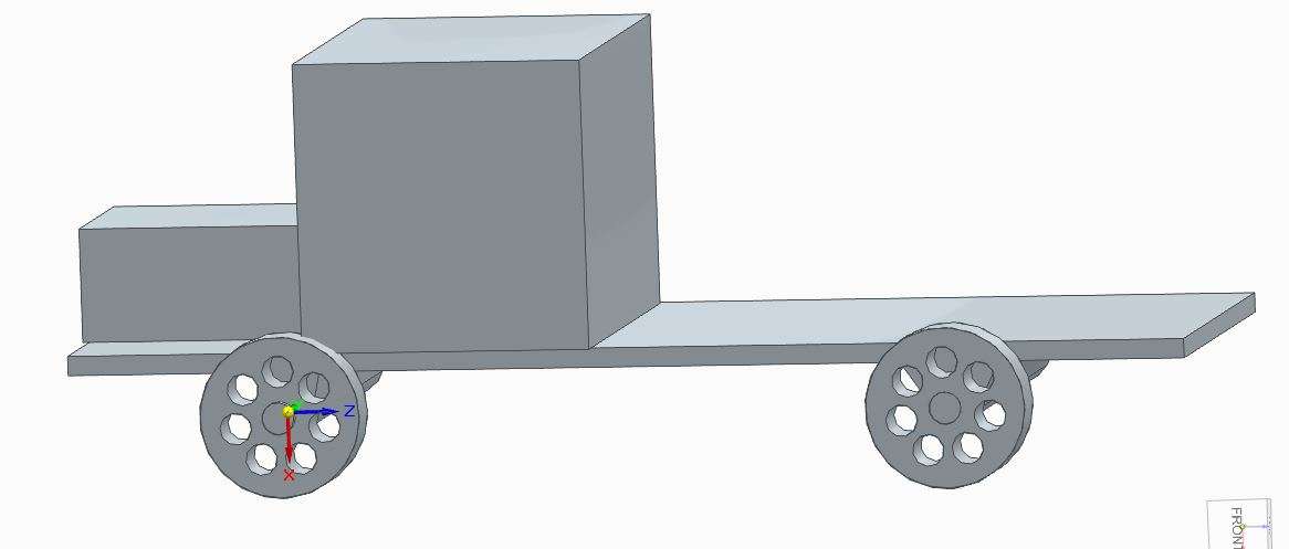

Nigel – that’s the really big benefit of 3D CAD.
Yes you start of with some assumptions/guesses. When you find out as the design develops that some of those initial guesses need to be adjusted, it is relatively easy to do without having to start from scratch.
I once did a project for a commercial builder of bodies for lorries – the basic design had to fit on several different chassis – some had flared chassis rails as you mention, some didn’t, the location of the flare varied, as did overall body length.
The finished design was driven by about 6 numbers – a quick edit of the numbers, then go for a cup of tea whilst all the parts regenerated was all that was needed to adapt the design to a different vehicle. Then the 2D drawings were refreshed from the model, were printed and passed to the fabrication shop.

Here’s a general arrangement of the Duffer Steam Wagon I knocked up this afternoon. It’s an assembly, very deliberately kept as simple as possible. It’s purpose is to identify the main dimensions of the layout, and avoids a great deal of work by ignoring detail. The wheels are discs, the axles are rods, the chassis a platform, and the bonnet and cab two boxes. It concentrates on the bare essentials.
The model isn’t a drawing. It’s an assembly of 5 simple 3D models: wheel, axle, chassis, frontbox and cab. At this stage they and the assembly only represent the outline, but they are all dimensioned, and can be changed.
If required, a 2D drawing is generated by the software from the model, either of the whole assembly or the individual parts.
Step 1 of the design is to manipulate these very simple parts to get the overall proportions and placements about right. At this stage, even though they might be known I would ignore details like the cab doors and windows, and position of the chimney etc. They waste time when the important thing is establishing the initial GA. Save adding details for when the individual parts are refined later, perhaps right at the end.
Just as an example though, my current design uses the same wheel throughout. As the wheels (only two fitted, but could be 4), are all derived from the one object, changing the wheel object automatically updates the assembly.
Much like a real steam wagon, my 3D CAD assembly consists of parts that can be updated later. Potentially, I could take this crude starting point all the way to a fully polished design. The block approach means progress can be made without me having to design anything in full, in fact it’s best to defer detail design for as long as possible. When I come to add wheel details such as a bearing and connection to the axle and suspension, provided it fits into the space available, the rest of the design still works. Fairly obviously adding the suspension will change the chassis, as will the prop shaft, but that shouldn’t upset the cab and bonnet significantly.
I didn’t need to draw a GA by hand, rather I created one on the fly direct in 3D based on guessed dimensions. I started with a wheel, added an axle, then the chassis, and finished with a couple of boxes! Working with blocks avoids the time it takes learning how to CAD model detailed objects: that joy can be saved for later.
Although CAD makes it easy to start with block representations of parts that are refined later on, which pays off big time as the project grows, the same block approach can be done with pencil and paper or balsa wood and cardboard. Less efficient than CAD because it takes longer to change, but no need to learn to drive a CAD package. Not everyone gets on with CAD!

On this occasion I wanted a simple but accurate elevation I could draw directly, of the salient area of an assembly too difficult for me to represent by any 3D-first approach.
I attach it below.
It is the tube-plate of my wagon’s boiler, surrounded by the smoke-box nearly two inches larger in diameter. I have to solve forming the superheater elements and headers without obstructing any of the tubes and the sizeable petticoat-pipe. The latter, not yet drawn and hard to draw, is very close to the tube-plate, with its “hem” about level with the tops of the flues. The two steam pipes will lie along the shell, under the lagging, and enter the drum through the ring between it and the boiler at about the 9 and 10 o’clock positions – also not yet drawn.
The horizontal rectangle is a trial header location I can move, delete or copy more easily than in Alibre.
There are of course more fire-tubes than that: forty-four total, I think! I need show only the top two rows for this purpose.
I will need develop the drawing further, including adding the side elevation and perhaps plan, but the print so far is to help me gather the remaining details for that, from the project so far.
The flues are very close to the top of the shell because even the lowest water-level is some two or three inches above that: Hindley’s patented boiler design is intended to cope with steep hills.
What the heck is that purple square…? It just happened, perhaps by me accidentally pressing one of TurboCAD‘s umpteen mysterious ‘SEKE’ (combination-key) commands.
I have no idea what the figure is for, it cannot be moved or deleted, even closing the programme does not clear it. Magnified, its internal squiggle is a squared-off letter ‘B’ on a ramp, outlined in little black squares – totally, weirdly meaningless!
