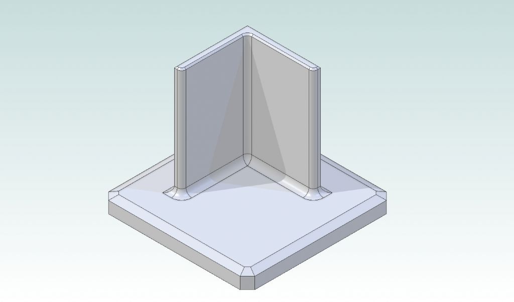

                                                #640288
                                                  TC does seem so long winded or you are not going about things the right way. Fillets and chamfers are quite easy with Alibre and F360. This bit of angle and plate have various internal and external fillets including the weld fillet joining them and the plate ha s45deg chamfer corners and a 2 x 5 chamfer to it's top edge. Some were added at the 2D sketching stages others directly to the 3D model.
