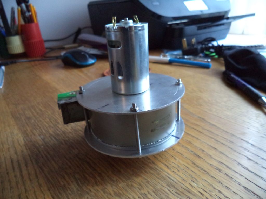

      Making a steam raising blower from Tuna Cans
      #448206
      Stewart Hart
        @stewarthart90345

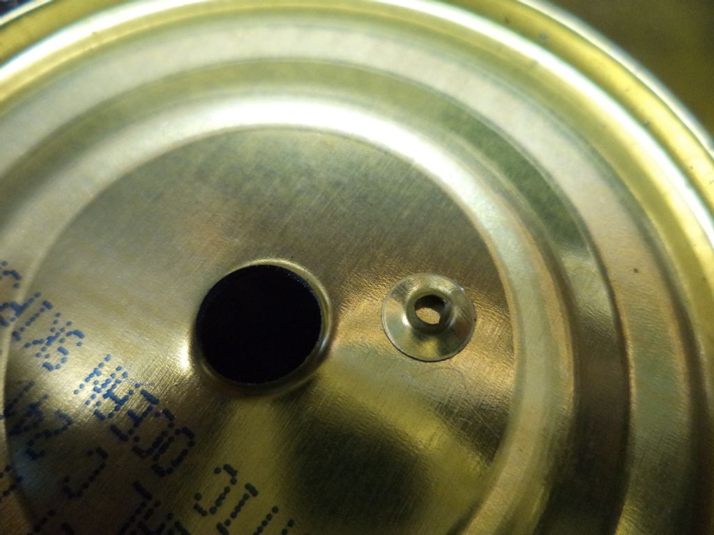

        Why do they call steam raising blowers when they suck ?. laugh

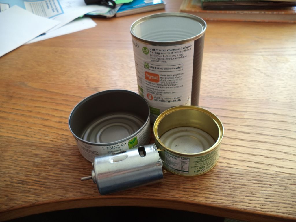

        On with the mater in hand, I've tired various blowers and I found the best to be the ones made from 24V ex-military radio cooling vans you could get these quite cheep at one time but with scarcity they are getting expensive. And as is my natural curiosity I've stripped a fair number of blowers down. Then when making myself a lunchtime Tuna sandwich I looked at the empty tin and had the idea of making a blower out of it, I took the empty tin with us when we next went to the supper market looking for a suitable tin to make the inner fan out of to me delight I found that the smaller tins of Tuna they sell would just fit the bill. 24V electric motors are easy to obtain of the net.
        A few manufacturing shot
        Material

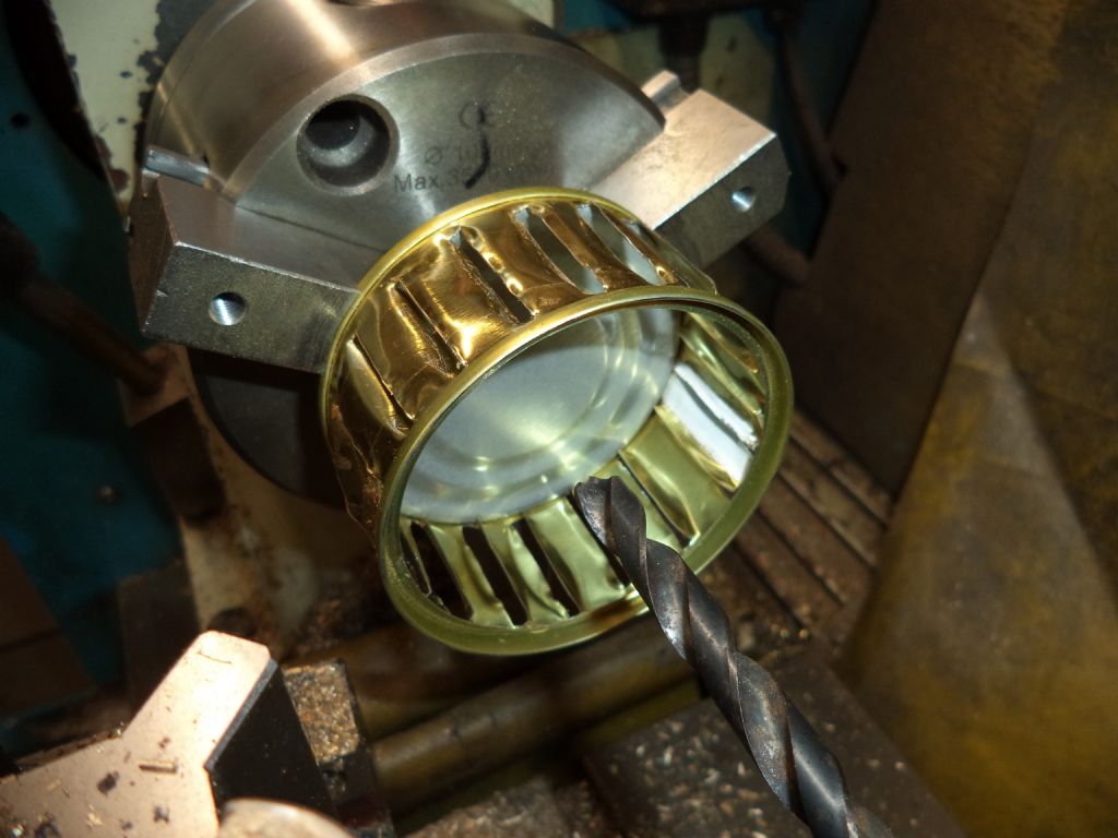

        Drilling the base of the fan the vanes were put in with a wood chisel whilst the inside was supported by a lump of wood.

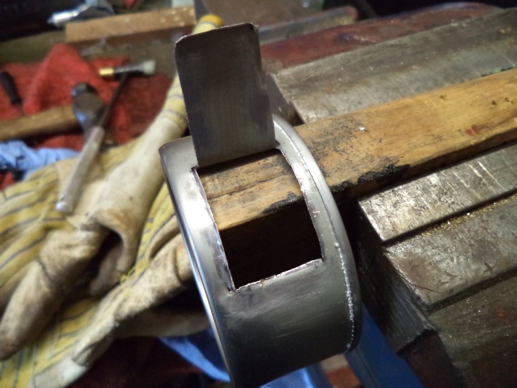

        The gap for the exhoust vent

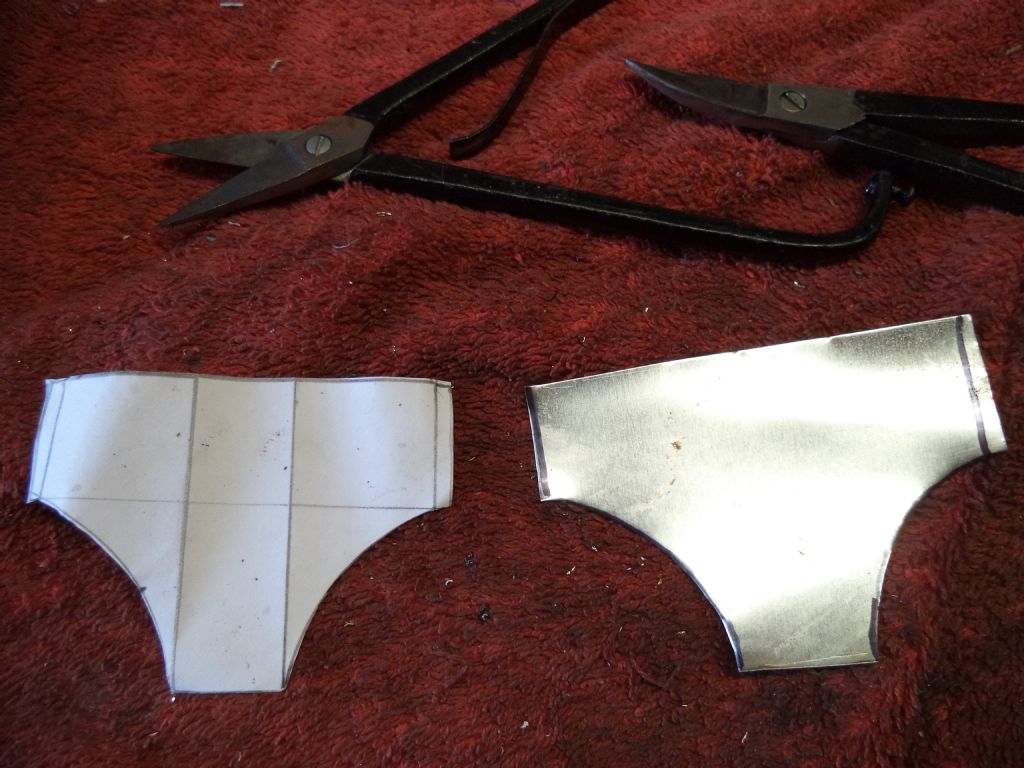

        The exhaust with its paper pattern

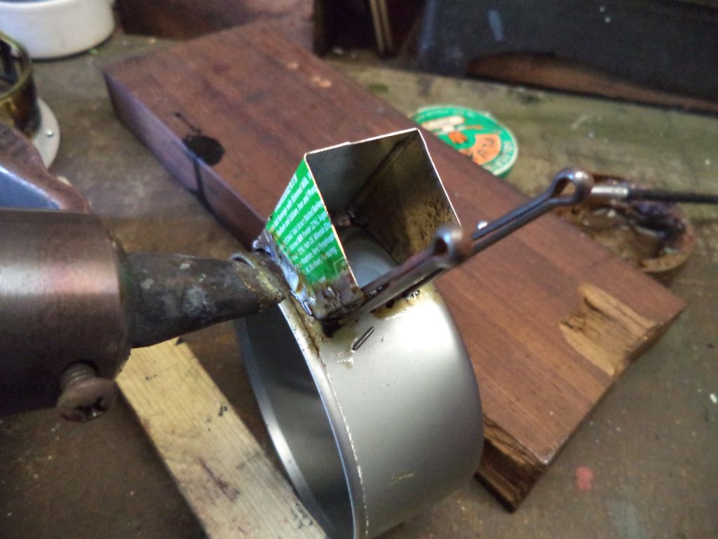

        Soldering the exhaust

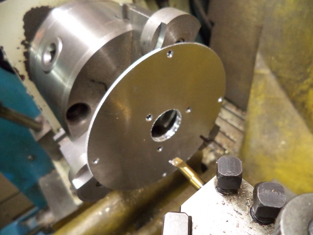

        Machining the top and bottom plates these were made from 100mm dia ally blanks bought of the net.
        Completed blower
        And yes it does work I recon at that size it would be fine for smaller 5" gauge and 3 1/2, 2 1/2 locos
        If you need a bigger blower you'd just have to find some bigger cans.
        Stew

                      Great design and build Stewart! Well done. I chuckled when I saw your soldering photo with the cotter pins / split pins used as sheetmetal clamps. I've used them the same way.
                      Usually it's too bad when something you made really sucks, but in this case it CAN be perfect! smiley

                            Looks like you are into making metal underpants at the same time, see photo number 4 !
                            #448273
                            Hacksaw
                              @hacksaw
                              Granny knickers

                                Posted by Bryan Cedar 1 on 22/01/2020 18:02:44:
                                I had the same thought Bryan it does look like a pair of Y fronts smiley
                                Thanks for your interest gents and comments smileysadlaughlaugh

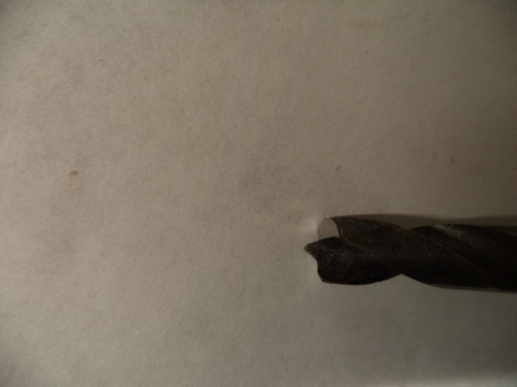

                                  Just to add a bit more interest to the thread, when drilling thin sheet with a normal drill you can run into trouble with a ragged hole or even worse.
                                  I was shown this little trick when I was an apprentice, grind a drill up with a little teat and a slightly undercut flat, this way the teat acts as a pilot and the under cut means that only the edge of the drill cuts, it cuts out a washer out and you end up with a nice clean hole.
                                  Stew

                                      Very neat Stuart, and a basic answer to "Why do they call steam raising blowers when they suck ? "
                                      Called blowers because the air is pushed (blown) by the centrifugal action in this case, causing a reduction in air pressure on the inside of the rotor. The atmospheric pressure pushes air into this space to achieve equilibrium.

                                        Do you know – does anybody know – if it would work with a lip-and-spur drill as commonly used for wood, or are they too soft for metal?

                                            More likely because they take the place of a conventional stem blower which pushes steam up the chimbley to create a draught?

                                                  As an industrial fan engineer of some 60 odd years (still working) I can throw some light on the blow/suck question.
                                                  Firstly any fan blows and sucks and vice-versa. Names such as fan, blower, exhauster are frequently used as loose terminology. In the industrial fan industry a fan is generally considered to be a medium to high flow at low to medium pressures. Likewise a blower would be a low flow high pressure. High and low of course are all relative terms but in the fan world pressures don't generally go much beyond 400 mbar for multistage units. Above that comes into the compressor category.
                                                  In terms of application there are blowers and exhausters or a bit of both.
                                                  So strictly speaking a steam raising blower is actually an exhauster by virtue of all or most of its pressure is on the inlet side, pressure in this sense being negative pressure (relative to atmospheric pressure)
                                                  Interested to see your home made fan Stewart, well done. Thought about making my own but need to finish my loco first, see if i can be bothered then, Saw those ex military blowers? some years ago, they were quite cheap, should have bought one then.
                                                  Hope this helps.
