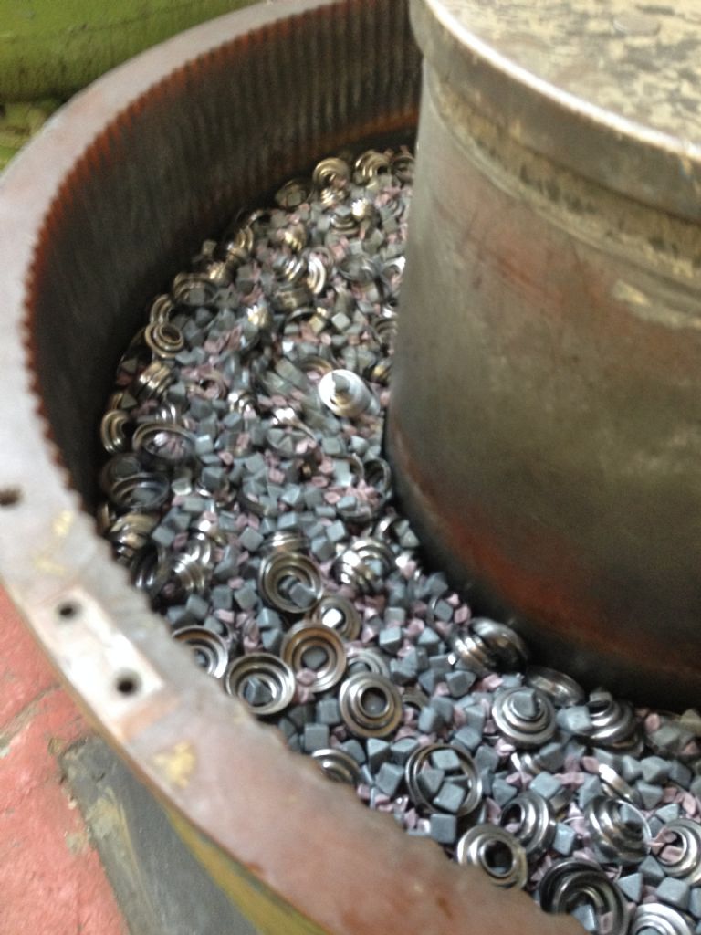

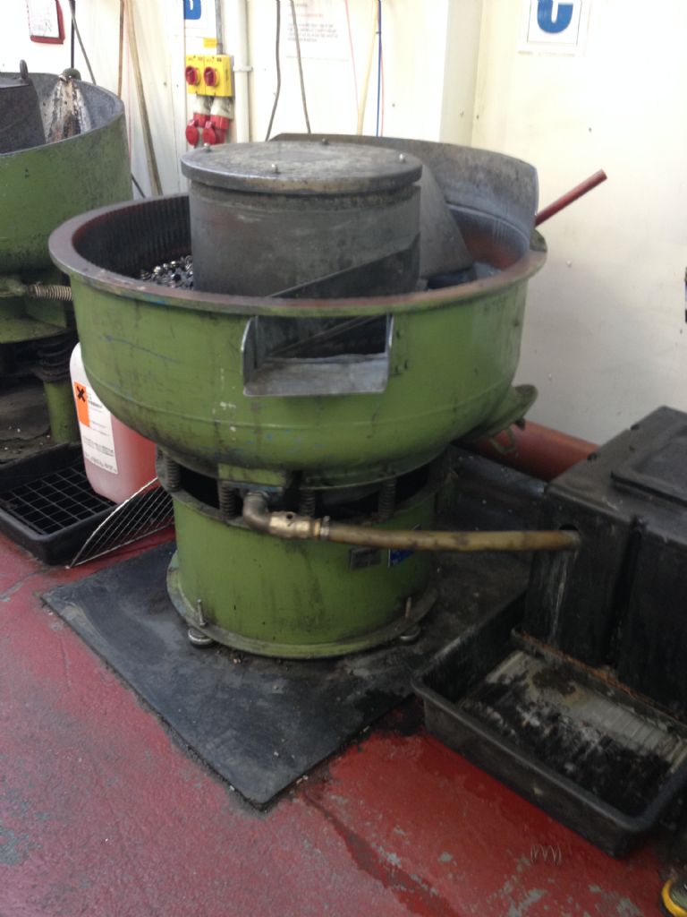

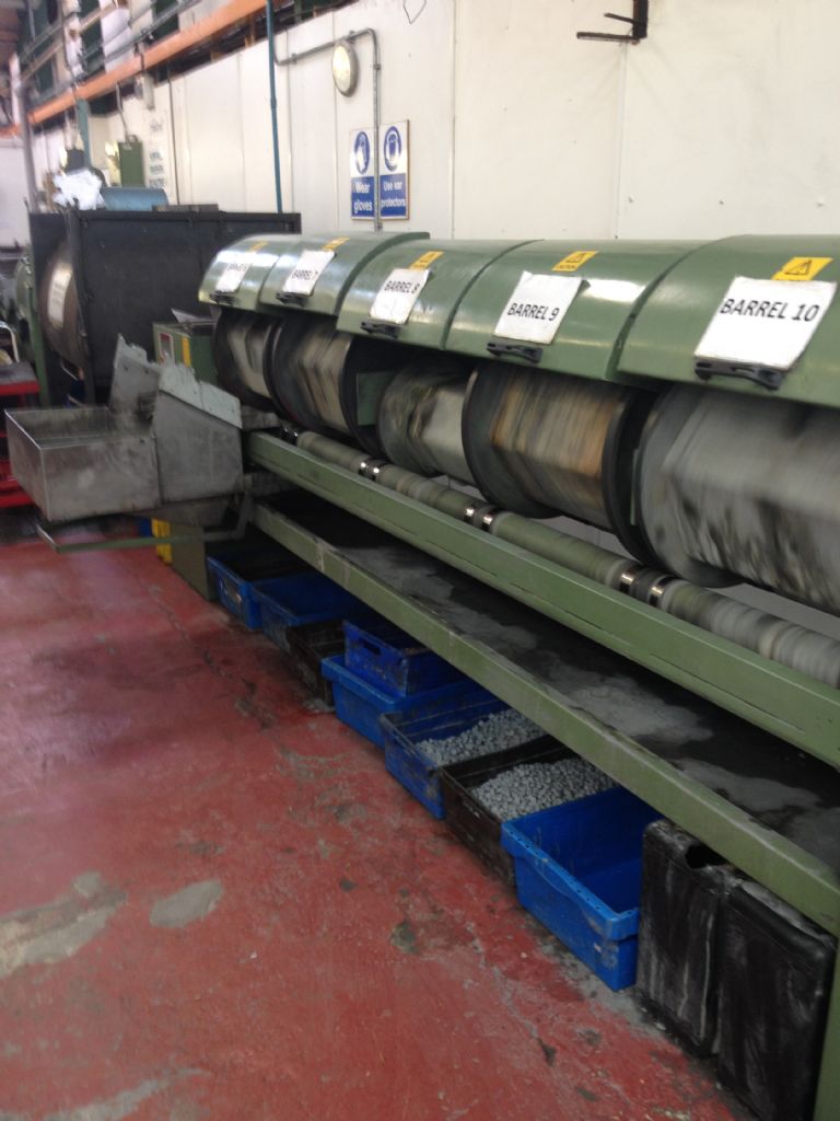

              Here are some pics of the shaker and tumbler deburring machines at my place of work. You can see the ceramic media.
              Shaker
              Shaker
              Tumbler
              Murray
