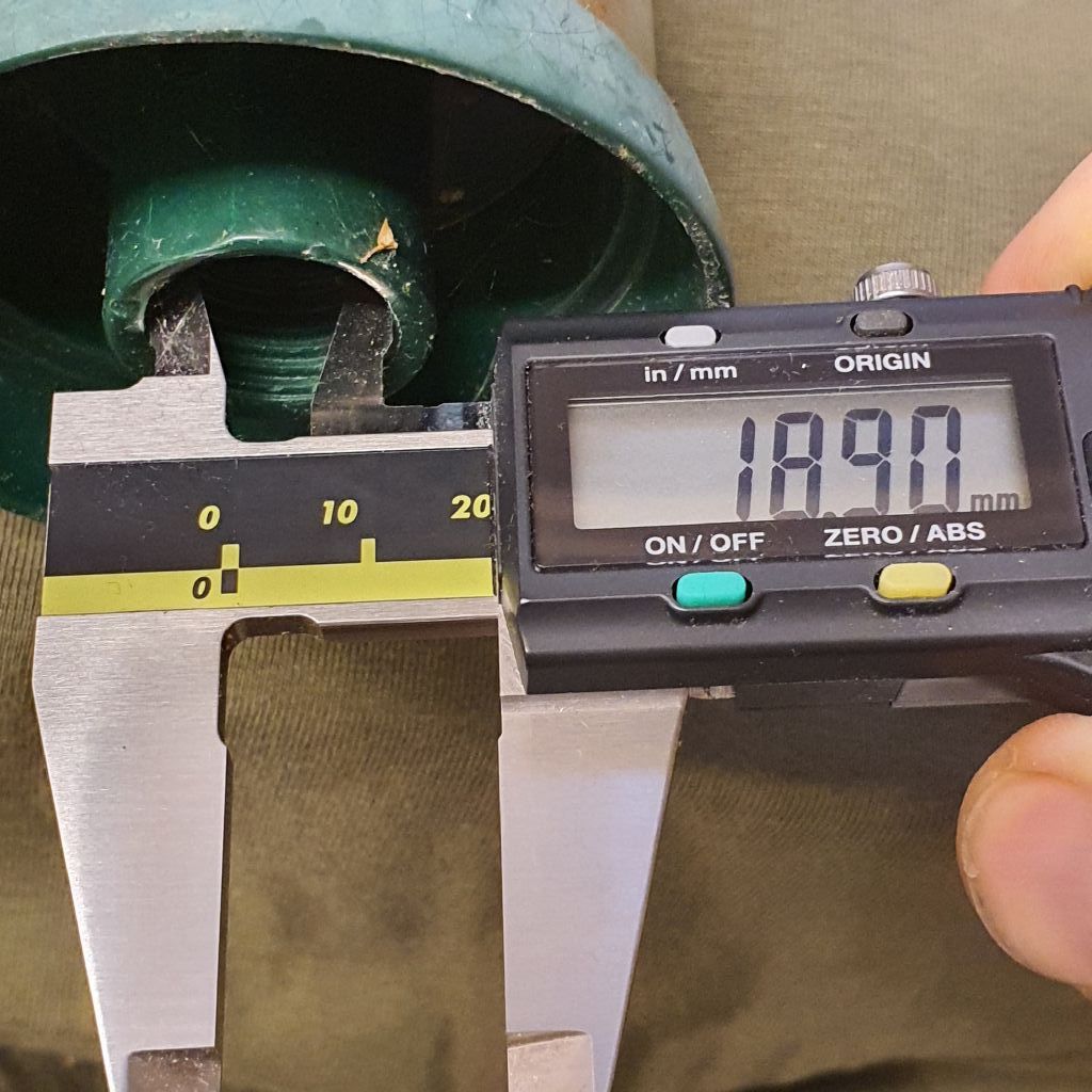

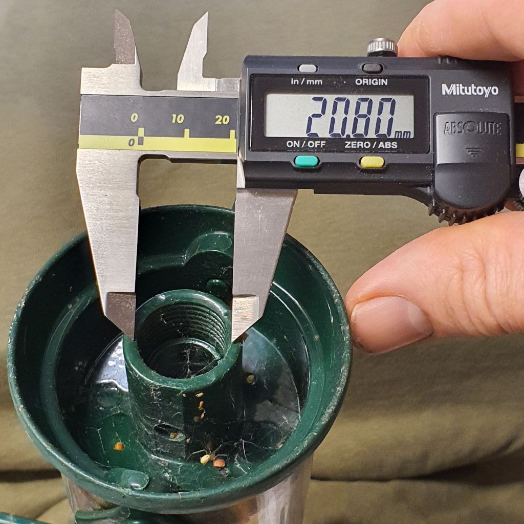

      Just to confirm, it is die-cast. I found a 1/2" 'pipe' tap at work today. Will check when I get home.

            I need to eat humble pie for making a momentous mistake.
            The green component in these two photographs had, to me at least, every appearance of being a polypropylene injection moulding. As Ed has indicated, it’s actually a metal die-casting.
            I stand corrected.

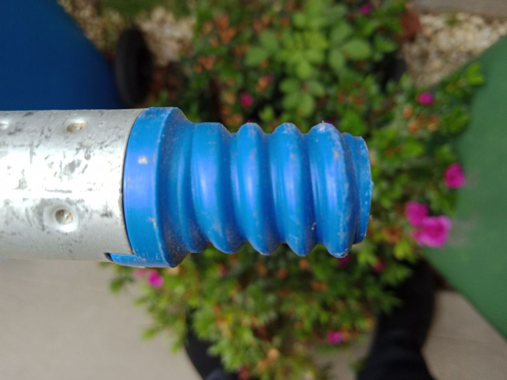

            For those still not bored with my interjections, here’s ‘Your starter of ten’…
            "Specify this thread!"
            It's fitted to the end of a domestic broom/brush handle.

              Posted by Sam Stones on 20/09/2023 22:09:45:
              This page (https://softsolder.com/2013/04/01/broom-handle-screw-thread-replacement-plug/) from "The Smell of Molten Projects in the Morning" has some details on plastic broom handle threads – potentially biased towards the US but nonetheless, enough to be going on. Ed's daily blog is well worth going through as well as an aside.

                In the plastics industry, there are many threads that are non standard, as they make the tooling nominal sizes, and the shrinkage alters it. They also make the tooling with a guess of the calculated shrinkage , and will then tune/change the one that is either easiest to either change the diameter, or to make another with compensated pitch.
                Glade that you have solved this one. Often I have made a cast of the thread, then measured it. just plaster of Paris works fairly good too.

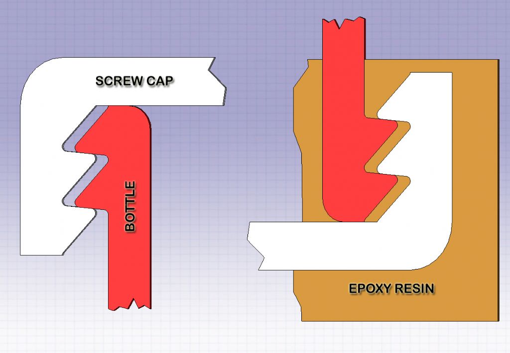

                      Mr Lickfold, Neil, how dare you mention shrinkage? devil
                      Actually, I found it a breath of fresh air when you touched on (mould) shrinkage, with its many ramifications.
                      Upon reflection, it feels as if I spent a large chunk of my working life dealing with the subject, often against the flow of a few controversial 'recommendations'.
                      As for potting (either in plaster or epoxy), I ran a bit roughshod over Raphael Golez’ Macro-photography thread with this interjection …
                      **LINK**
                      Particularly potting in epoxy resin.to determine how two (M&F) threads aligned.
