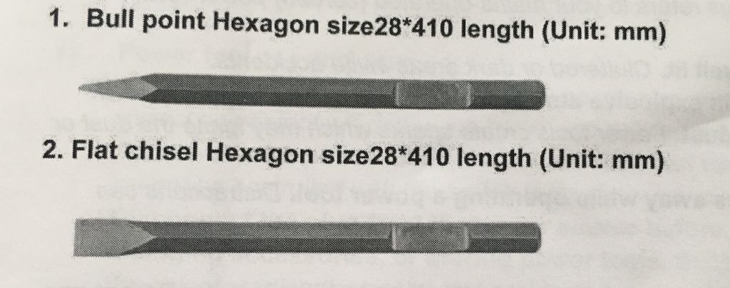

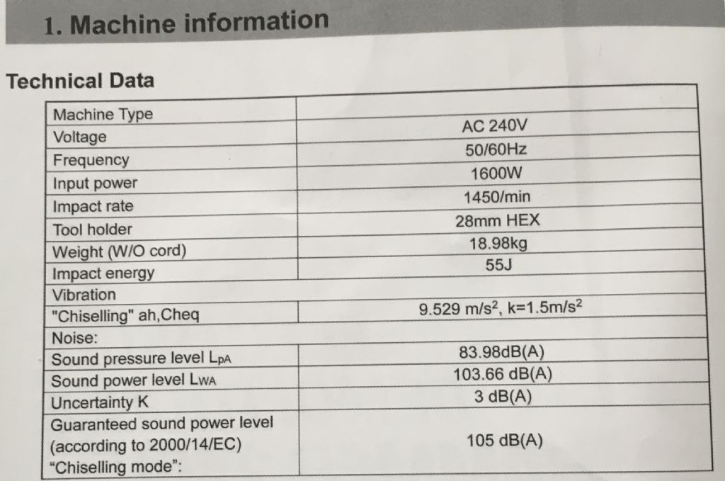

        My recently-purchased ‘Electric Demolition Hammer’ [call it what you will] is proving very effective, but I don’t really understand the performance specification, and am hoping that someone versed in such matters [maybe Duncan?] will educate me.
        It claims to deliver an ‘Impact Energy’ of 55 Joules to a chisel with a 28mm Hex shank, at an impact rate of 1450/min … but how would that translate into familiar units of something like “bloke using a lump hammer
        Grateful for any enlightenment.

          Presumably the 'impact energy' is the kinetic energy of each blow of the internal hammer, delivered to the chisel. The mass (inertia) of the chisel will have an effect on the performance, but the mass of the machine itself, being huge in comparison, isn't really important in practice. How this compares to a bloke + lump hammer system depends on the bloke and the hammer, but your breaker will go on for longer, without having to stop for tea, and will achieve its results by thousands of light strikes, which will cause less collateral damage (usually…).
          If beer hasn't addled my maths, 50J is about one quarter of the muzzle energy of a typical .22 round. So, if the breaker doesn't do it, shoot it – lots of times…

              My math says it's equivalent to dropping a 1kg weight from a height of 5,5m. Not sure if that helps.

                Interesting question. It's been many years since I did dynamics at uni as part of my engineering studies, but I think the answer would be that the impact energy multiplied by the frequency should approximate the input power minus the various losses. So, 55J impact at 1450 impacts/minute is 79.75kJ/min which is 1329J/sec which is 1329W, which is about 83% of the input power so not an unreasonable figure.
                The effectiveness of this input energy in dislodging material would then need to be assessed in relation to the mass of the moving parts, the velocity at the time of impact, and the effort provided by the person holding it. There would seem to be too many variables there to allow a simple comparison with a lump hammer but someone with more recent experience than me might be able to calculate it.
                A simple approach suggests that if the machine weighed the same as the lump hammer, and if the velocity at the point of impact was similar, then a similar result would be expected. For how long would be subject to the fitness of the man with the hammer.

                    No idea of the equivalent figure for bloke with lump hammer but personal experience based on trying to break up a concrete path with chisel and 7lb club hammer, then going out and hiring an electric breaker of, probably, similar spec to that of the OP, is that the breaker was around 1000 times better than me with hammer. At least. And by a very considerable margin. 10mins with hammer and chisel left a few gouges in the concrete. 10 mins with the breaker left a considerable length of broken concrete fragments. Heaviest bit of the job was carrying the breaker and its bits out of the car, round the house, and up the steps to my back garden and back again an hour or two later. Would have been less but I stopped for coffee…

                      I'll give it a try…
                      Joules is kinetic energy which is measured as force times distance.
                      Joules is Newtons times meters. (1 Newton force will accelerate a mass of 1 kg at 1 m/s/s)
                      To work in lump hammers we must convert to English units. Plenty to choose from, I suggest foot pounds
                      55J = about 40.5 ft.lbf
                      So a 3 lb lump hammer falling 13.5 feet would arrive with 40 ft.lbf or 55J of energy.
                      Wow! smiley

                            Perhaps a more relevant comparison: 55J is the same as dropping the 19kg machine 3 inches.

                                  What though does this mean, on the ratings plate:
                                  "Chiselling", ah Cheq.
                                  Followed by two accelerations, the first of touchingly mathematical niceness. (Sorry, I can't edit the superscript size here). Presumably of the hammer, but are they even relevant to the user? :
                                  9.529m/s2, k = 1.5m/s2

                                      It's been covered above in terms of dropped masses, but that's not what the machine is doing. I don't actually know how these machines work, but if we take an analogy a device which compresses an internal spring, then releases this spring to accelerate a striker mass (m) to a velocity (v) to impact the chisel. The force exerted by the spring is equally exerted onto the mass of the machine (M) and so the machine is accelerated in the opposite direction to a velocity (V). Conservation of momentum means that m*v=M*V, so making the machine heavier increases the velocity and hence energy of the striker mass. Trying to type the maths into this thread is challenging. However, any additional mass would need to be very rigidly attached to the machine, human leaning on it has lots of flexibility and damping.
                                      To answer Michael's original 'how does this compare with a man with a lump hammer', I have no idea. I think it depends at least in part on the skill of the man. My dad was a stone mason, he could split a stone exactly where he wanted by looking at it, not quite but he certainly used a lot less effort than I needed, and his split where he wanted it to be.
                                      #651817
                                        As others have calculated, Michael's Jack Hammer does about 1.3kW of work, which is roughly equivalent to six fit men, or ten weedy ones, and each blow contains as much energy as Robin's "3 lb lump hammer falling 13.5 feet".
                                        Can't be doing with nasty old imperial measure, but that's about 55 Joules hitting the target at about 7 metres per second. The pressure is spread over the area of the lump hammer, rather than concentrated at a chisel point, but enough to deliver a nasty injury.
                                        The Jack Hammer's acceleration figures suggest the speed of it's chisel blows are much the same as Robin's falling lump hammer. Speed makes a big difference. The amount of energy used by a human to push a car slowly won't damage the car. But if the same amount of energy is delivered quickly, the car and human are both damaged. If the human applies the energy with a spear, or hammer, then the car will be damaged badly. Pushed objects have time absorb the energy and maybe move out of the way. When a struck object doesn't have enough time to absorb the energy, the material it is made of is displaced, resulting in cuts, disintegrations and penetrations.
                                        Jack Hammers are designed to deliver sharp blows at the chisel point without wrecking their internals. I believe it's done by the motor slowly storing energy in a flywheel, that operates a faster but still relatively slow moving internal hammer, that delivers all it's energy into the chisel point in a rapid series of short sharp blows. Although most of the energy is dissipated in the target, the chisel point is replaceable, the internals take a beating, and the motor won't last forever!

                                          If a man can use a hammer at a rate of, say, one blow every 5 sec, i.e. 12 blows per minute, and each blow (see a previous post) is around one-half of a single breaker blow, then we are looking at something of the order of 2000 times more energy dissipated at the chisel tip. No wonder the concrete just gives up.

                                              Impact energy is the energy required to make a standard test piece fail. It is somewhat meaningless in this instance unless you know the size and composition of the test piece used. However if the test piece was a block of cheese it would not be so effective if it required 55 Joules to make the cheese test piece fail. Silly example but I am sure the learned throng will understand.

                                                Robin, I think force times distance is the work done. The speed the distance is covered gives the rate of doing the work which is power. Kinetic energy is ½mv² where m is the mass and v is the velocity.

                                                  An interesting definition, Mike
                                                  … I have located it in reference to the Charpy Test
                                                  I must admit that I had taken the words more literally i.e. Impact Energy = the energy of the impact
                                                  … But yes, I see that ‘perfect’ transfer would require [to borrow a term from elsewhere] ‘impedance matching’

                                                      Depends on context, I see nothing wrong with using the words to describe the kinetic energy of the chisel at impact.
