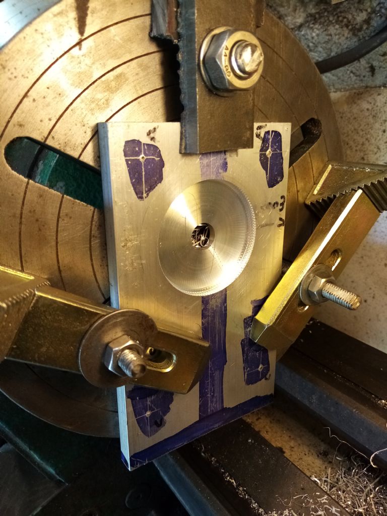

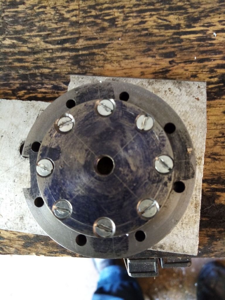

                                          Arthur Goodwin
                                            @arthurgoodwin45738
                                            Hi all
                                            Not got round to assembling the cylinder as Ineeded to prrpare the base for it.
                                            This is were I hit a problem. The base measures 7.5 X 3.5 inches, when I mounted it to my face plate and centrslised for the counter bore, the throw was 6.5 inches and fouled the bed. My lathe is a 5 inch denford.
                                            The only way forward was to saw off 1.5 inch.
                                            Now looking at this with hindsight (a grrat thing) what i should have done was make the steam chest cover the same diameter as the S C and use the same bolt circle to fasten them both dowm see pics.
                                            Any reason why Bob would not img_20200519_143218.jpghave chosen this option?
                                            #473108
                                            Arthur Goodwin
                                              @arthurgoodwin45738
                                              #473111
                                              Arthur Goodwin
                                                @arthurgoodwin45738
                                                Meant to say, why not do that and do away with counter bore.
