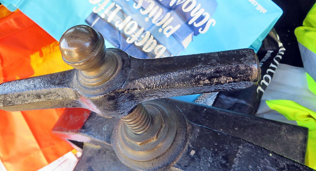

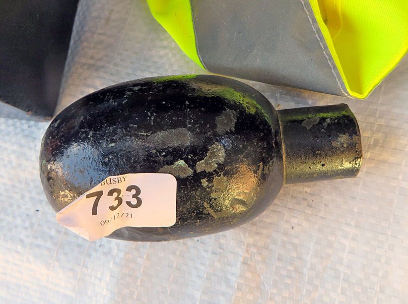

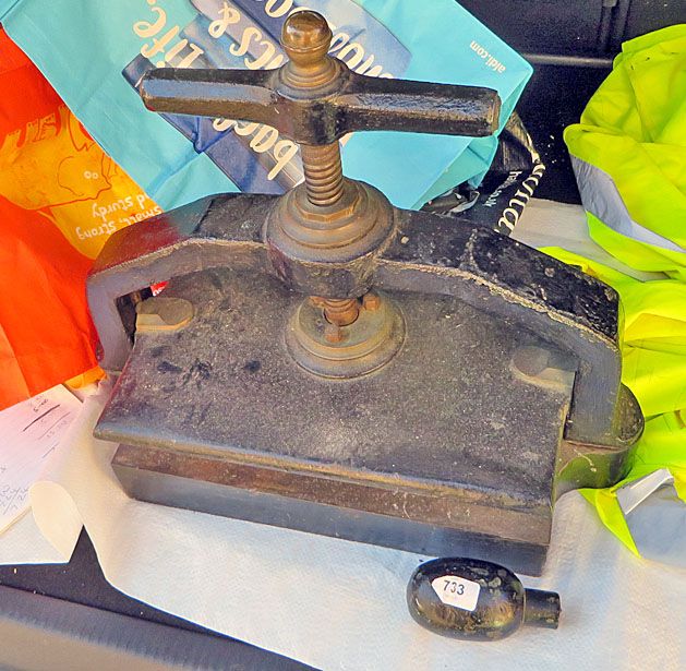

      Hi All,
      Just picked up this nice DRYAD book Press bought at a local auction, good price because of the damage to the handle.
      Handles are sometimes REALLY hard to remove but this one will come off OK.
      I would like some suggestions as to the best way to hold this awkward shaped piece in order to square the ends and drill centrally along the axis to allow the fixing of whatever new handle knobs I decide on.
      These may be modified brass door knobs or bought in round or egg shaped hardwood items.

          @ianparkin39383
          Didn’t you do one of these a year or so ago Martin?
          have you a a lathe with a big enough bore to slide the handle down?
          otherwise grind (with your belt sander )them square and carefully marking out and drill for a piece of threaded studding to fix new knobs

              Could you find a piece of tube /pipe to just fit over the handle,then fill it with a hot melt glue ? This can then be gripped in a 3-jaw and melted off later in boiling water.repeat for opposite end.Just an idea.
              #574927
              Howard Lewis
                @howardlewis46836
                Like Bootlegger, I was thinking in terms of putting the remains of the handle into a tube and filling it with a low melting point alloy, such as Woods metal, so that it can be held more easily to be faced, drilled and tapped..
                The fun bit may be popping the exact centre for alignment in a 4 jaw chuck! maybe leaving a little protrudin from the tube and clock that?

                  I'd make use of that big hole in the middle to bolt it to an angle plate or vertical slide

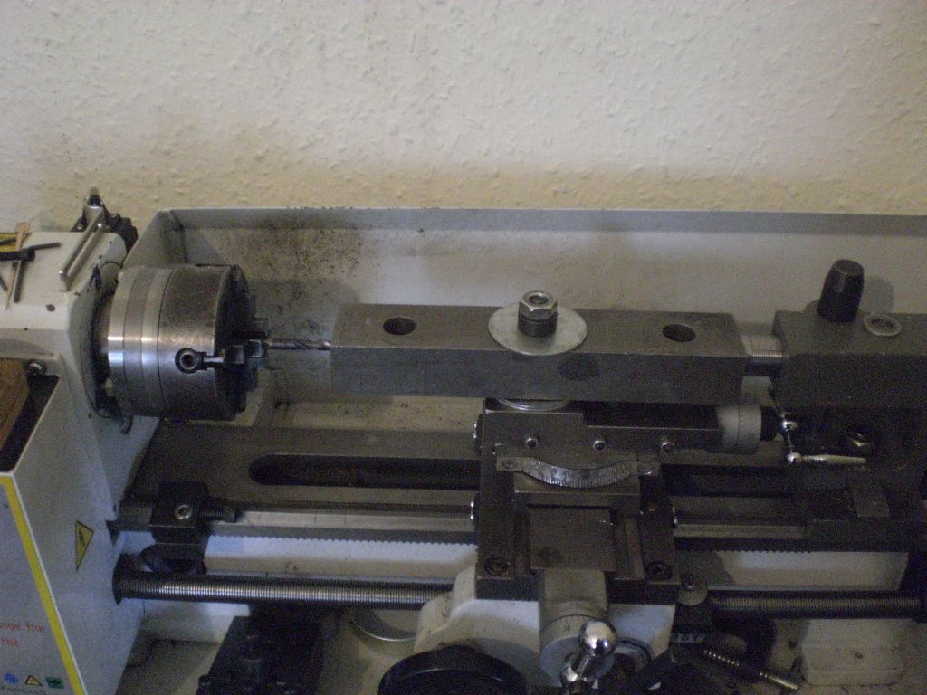

                      Hi All,
                      I will try Jason.s method for squaring up the handle ends. Have got a nice beefy angle plate.
                      I only have a very small pillar drill with no room for something this size.
                      Even if I can get the handle in the 4 jaw on my Myford I cannot hold the outboard end safely? Certainly no room in the spindle.
                      Cheers, Martin
                      #574990
                      John Haine
                        @johnhaine32865
                        Take the tailstock off your Myford, and clamp down on the cross-slide using a bolt through the hole in the middle with packing to centre height.

                            Hi Martin, I don't know how long your handle is, but maybe you could use JasonB's idea of using the big hole in the middle and set it up on your cross slide and using your tool post bolt to hold it down, as in my mock-up below to drill holes for threaded rod, and you could use your tailstock to push it, even as an assistant to push it with the leadscrew.
                            Regards Nick.
                            Edited By Nicholas Farr on 11/12/2021 11:14:20
                            #574996
                            Martin King 2
                              @martinking2
                              Nicholas,
                              I like the look of that idea! Will try that after I have squared up the ends using Jason's suggestion, many thanks.
                              Cheers, Martin

                                          You could make several passes with a small cutter on the mill, if it is on an angle plate in the lathe the up or down load from a larger dia cutter sweeping the whole face may move the part. One reason I suggested a vert slide as that could be used on the lathe to take a few passes by raising and lowering the work.
                                          The other advantage of the lathe is you can use the chuck jaws and tailstock barrel to eyeball the part to the axis
