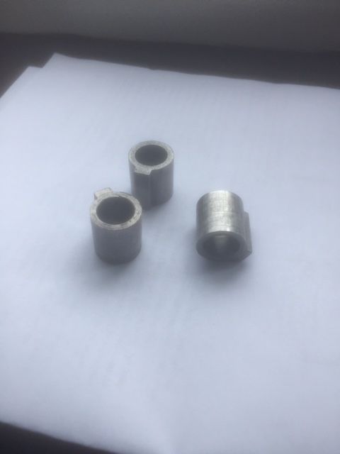

                            Andrew, are these what you are after, 10 mm bore, 14 mm O/D , 15.2 long with a 5 mm key? PM your address if want them.

                              They are indeed the bushes that I am after. A picture is much better than my poor description! I will send you a PM.

                                How would they have been made in the factory? Diecast? Extruded? Sintered? They look an awkward and wasteful piece to machine from the solid.

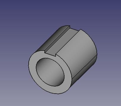

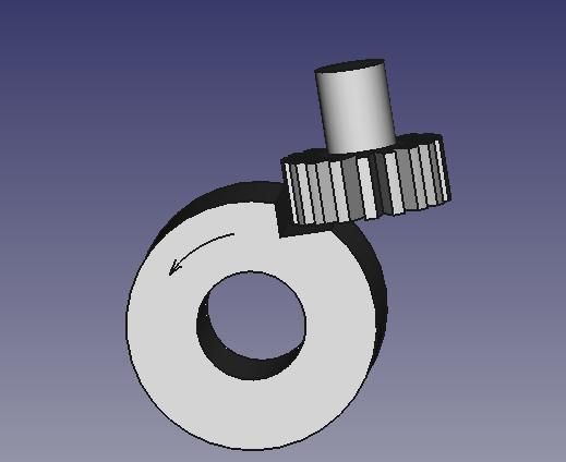

                                #545567
                                  Posted by Tony Pratt 1 on 17/05/2021 09:12:18:
                                  Tony's kind offer solves the problem, but what's the best way of making an object like this?
                                  My first thought was to turn a tube, then mill a slot, and braze or loctite a key into the slot:
                                  Looks good except the joint is weak because the slot cuts into and thins the bush. The arrangement is very weak when the key is pushed longitudinally, so it's unsuitable if there's any end thrust. (I think a keyed bush made this way is fine for lathe change gears because they don't transmit much power and the thrust is all rotational.)
                                  Could a stronger version be milled from solid by rotating the blank against a side cutter?
                                  Although a solid bush would be stronger, I'm not sure if the finish would be good enough on the round part, and it would be harder to turn the radius accurately. Is milling from solid a good idea?
                                  How else could keyed bushes be made? I'm wondering if the commercial items are extruded rather than machined?

                                  Tony Pratt 1
                                    @tonypratt1
                                    Definitely not machined, on careful examination I think possibly extruded.

                                    Tony Pratt 1
                                      @tonypratt1
                                      Posted by Tony Pratt 1 on 17/05/2021 11:03:10:
                                      Tony
                                      Or sintered & 'sized' using dies.
                                      Tony

                                      Hopper
                                        @hopper
                                        Extruded would be the "low cost hobby market" option most likely. Are they then aluminium or Mazak etc and not steel? Would explain why they wore out already.
                                        SOD: I dont think there would be enough wall thickness to cut a keyway unless it was made very shallow, say 1mm. Might get away with it for change gears in low power situation. I dont think you could mill it and get a smooth diameter without making a million passes at tiny increments etc.

                                        Tony Pratt 1
                                          @tonypratt1
                                          No not ally or Mazak as it's magnetic to a degree. End structure looks porous so I'm thinking sintered with some sort of ferrous material but has a polished looking surface on all external features either from the sintering mould or a sizing die.

                                          Andrew Tinsley
                                            @andrewtinsley63637
                                            I think they must be sintered as they are definitely steel. Extrusion would be perhaps far too expensive for such a low cost lathe.
