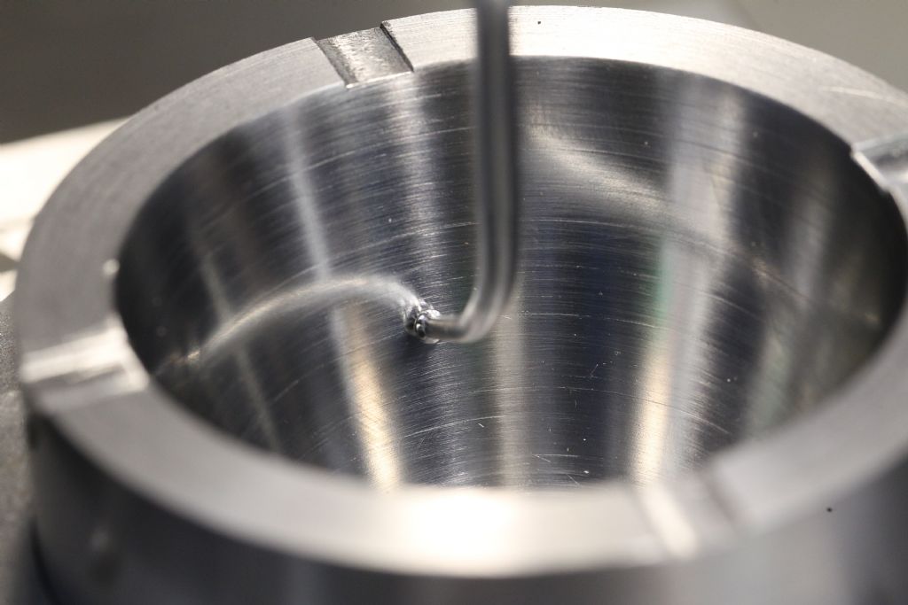

        Max Tolerance
          @maxtolerance69251
          For many years I have used a similar method for tramming my mill head, except that instead of turning a piece of steel I use a large bearing inner ring. The one I have is around 220mm diameter and came from a scrap taper roller bearing at work. Needless to say these rings are ground to a very close tolerance and they are also hardened which is a bonus. The inner rings usually don't have any numbers engraved in them so there are no indentations to throw the readings out. Also of course you avoid the T slots in the table.
          #662710
            Max, you should get a good reading as it sounds like you ar eusing the edge of the bearing but Chris's method uses the side of his cone wich will make any error unreadable unles sit is massive, all he is doing is centering his spindle to the hole.

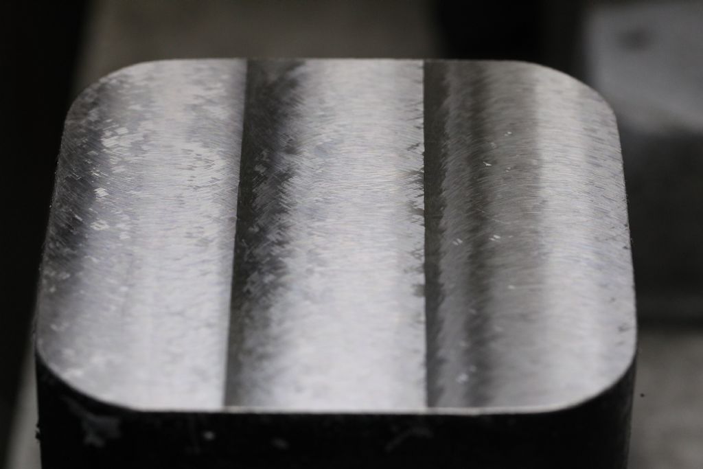

              Jason, here is added photo, I cut 3 rows right to left(X-Axis) and back over same cut, similar for other two.
              -The cutter have 6 inserts and the cut was .65mm. See if you can make something from it.
              -I can remove 5 inserts and cut again and see how that looks.
              -I can recut same depth from the Y-Acces the same way.
              -I cannot feel the rifs one see in photo, neither measure it with an .01 indicator.

                    Chris just try what I said either putting a 0.1mm feeler gauge under one edge of your come or now using the traditional way of swinging a DTI.
                    The first I don't expect you to notice a difference in the amount of movement of the co-ax indicator needle yet the cone will be at an angle.
                    The second will confirm if your cone is giving you the results you think.
                    Yes I have said it several times you can only average things out tram is usually spindle axis in relation to the table but head/knee axis and quill axis are unlikely to be the same, quill is hardest to check as there is movement in it and a very lightweight hobby machine may even flex a sthe quill handle is pulled down.
                    Video I did a few years ago spindle to table is good, head not bad and quill showing more deviation.
                    Edited By JasonB on 04/10/2023 07:45:05

                          Ok, one thing led to another(S):
                          1-I made a double indicator tram setup, using 1-2-3 blocks and/or just to bed/table. I found the Y1-axis side a slight problem as decribed by others, where as I undestand the geometry of the Y1-axis around the centre of the spindle is not similar to the X1/X2 axis(Y2=OK), due to head/Slide adjustments. Interesting changes happens to the Y1 & Y2 points if I adjust those two nuts extra on head which other similar mills probably dont have. I will have to chew deep on this one.
                          2-Using it I dicovered the spindle moved up & down and sideways too much for any liking. I could have a good tram say 2 out of 10 times turning the spindle, its not reliable.
                          3-I made a tool/setup to replace the bearings, the inner sides as well as outer sides in quil, minor mods same tool for both. I did this after local Case TRactor shop broke race of the larger Timken bearing, bought another one.
                          4-Removed Quil/spindle. Removed chinese bearings and replaced today with Timken made in Poland roller tapered bearings. I noticed to preload the bearings is not that difficult in this case…You press last small bearing in with spindle in quil till it feels like tentioned..If its too much, you just tap the end back with an aliminium hammer(Or other safe hammer)…You then righten the in this case one locknut & washer locked. The locknut can be used to apply load after the bearing initial seating by pressing it in..I played around between the locknut/washer & tapping to get the preload I am happy with.
                          5-The relief of this was a pleasure, zero play up/down or sideways, I was happy with preload and no play. I expect to see a different cut pattern now.
                          6-This brings me to the looseness of original chinese bearings.. Could it be due to tapping out the MT4 tools.. In beginning it was hard tapping, but after a tip from this forum I made a handwheel, similar size to an old Singer knitting machine with socket to tighten drawbar with hand, since the the knock loose was not an issue as to feel…….Now that I assebled the spindle/quil myself, it would be easy to detect if knocking out the MT4 tools is a problem.
                          I took photos and will post it later. I am busy reassembling everything again, and will tram it again to see the difference in feel of doing it.

                                Zan
                                  @zan
                                  I cannot see how this will work.   Let’s say the outside of the device is machined concentric with the cone ( at the same time)
                                  So the cone is set exactly in line with the spindle axis using the outer face
                                  the indicator in the taper shows the head is out of tram and needs to be knocked say clockwise
                                  so you thump it clockwise and get zero on the indicator  head square  (?)
                                  BUT the bottom of the indicator has now moved to the left and is no longer on the axis of the spindle  and clocking again on the outside will show an error.
                                  so move table to left  to centralise on the axis
                                  oh dear. Not true again when testing the taper………. Thinks…..the head must be out
                                  i tram mine by using a new brake disc and a dti on an arm. The disc is perfectly [ for me] flat and eliminates any error when the dti drops and lifts when crossing the t slots
                                  JASON , a theoretical point. your explanation of back cutting and flexing.   On a long workpiece [ greater than the swept dia. Of the cutter), a single point cutter the cutter will flex up  then do a scrape cut on the back cut.. however if there are two cutters mounted at 180 to each other when the front one flexes up the back one will be forced down.  So the result is a flat   But as soon as the initial cut passes over the end of the work, the back cutter is no longer being forced down so wil in effect lift clear of the work. Result, not flat. So the pattern on the work different….
                                  im ready to be shot down in flames over this!

                                        Chris Mate
                                          @chrismate31303
                                          Photos  in order……See difference in finish before and after bearing replacement with no play……With the play up/down and sideways it delivered a sorts of an arty polished finish which felt smooth. After it delivered a different finish also smooth to the touch. Showed bearing fitment tool(Scrap metal used, I dont have a press yet) which actually gave me a nice control screwing the bearing in. It works on spindle and minor additions in quil as well. I used a split washer which provides nice control making sure bearing parts are  lined up well before screwed in place.
                                          Unfortunately site does not allow me to show images here with post, look at galary.
