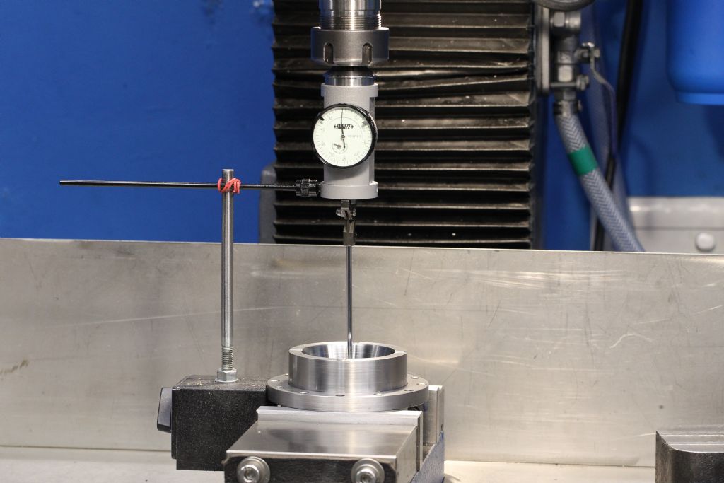

      I am aware of the current methods used to tram heads with up to two indicators used, and I can do that, but I like how the coaxial indicator works and dont work, really jnteresting.
      From that my theory is:
      1-You take a block of round bar say 70mm wide by 60 mm in height, put it in lathe and machine the outside diameters, for this case the outside does not matter much.
      2-Now you bore it out except you left a bottom of say 5mm not bored out, with a wall thickness of say 15mm. Do not remove from chuck now till finished.
      3-Now you drill a very small hole in the bottom centre without removing it from lathe chuck, this is to centre this piece under the spindle using the coaxial indicator with its punch adaptor, this would be like a flat plane start.
      4-Now you turn a steep taper of say 15 degrees into this hollowed out bar to near the bottom with concentric hole. The use of the taper would be to "multiply" the effect of it head is out of tram similar to the lenght of bar used with conventional methods for leverage. The taper will give the leverage now, as the coaxcial probe will not run in a perfect circle around the taper if your head is not 100% 90 degrees vertical(Spindle to bed).
      5-You can see this as a jig made once to use with the coaxcial indicator to square up the head/spindle to bed(Tram).
      I dont want to compare this with the other methods, just opinions in theory regarding this idea. I do see some sort of a simplicity in it. What do you think of the idea in theory-?

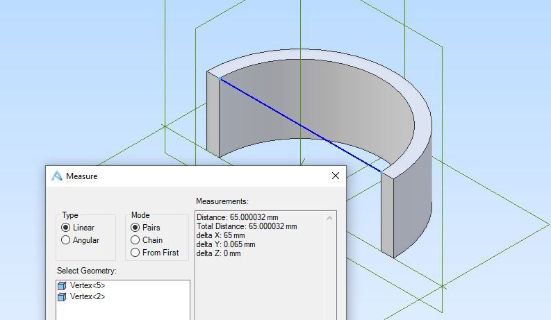

            Just sketched it out in CAD
            If we assume the widest point of your cone would be 65mm dia then applied the equivelent change in shape corresponding to 0.1mm over 100 of tram error you would be looking for 0.000032mm on the coax. One is easy to read the other you won't read. Given that most would want something like 0-.01mm or better over 100mm then you will never see th eneedle move on the coax
            I drew it as a cylinder, sliced the top off a 0.1:100 (0.06deg) and then measured the major axis of the elliptical end.
            You can also see from the Y delta that by measuring over 65mm dia even if done the traditional way your reading will be smaller, half of less of what can usually be swung across a mill table.

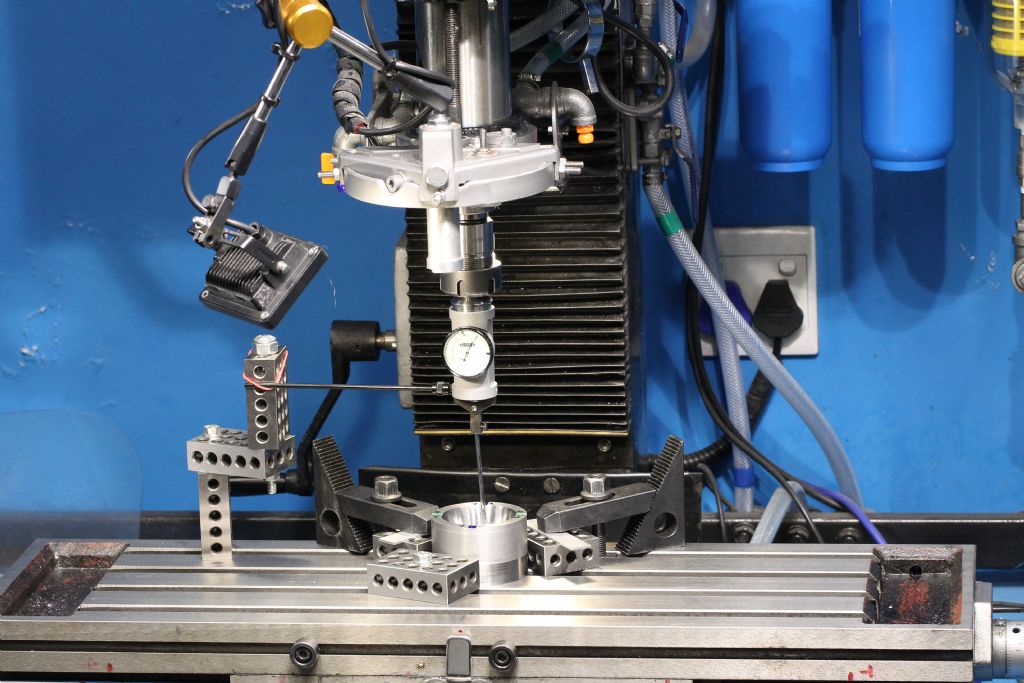

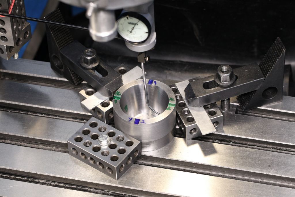

                Ok, thanks for info. This morning I decided to make the "jig" clamped to mill table. Decided to cut the inside to 18 degrees due to height of round block. At the bottom I left material, then drill a small hole which is concentric to the taper. This hole was drilled with the smallest centre drill with short taper for the punch bit from the coaxial indicator.
                I then installed it to the centre of the mill bed. I played for two hours with it. I think I like it for now, must still prove if it has the practical value I want from it, and that is to have something simple enough to tram the head so I can get a smooth cut backwards and forwards in all directions by slight adjustments, and with this I monitor all 360 degree in one sweep, I like this.
                1-So I 1st centred the spindle with Coaxcial Indicator installed in 10mm collet/MT4.
                …I ligned up the punch bit from indicator so it ran true as possible, this is now at the bottom of "jig" right on bed. I know that depensding on head this may not be 100% yet, but a start.
                2-I then fit a longer bit to coaxial indicator and chose a spot around the middle of the taper height.
                ….Now from here I marked the Y-Axis(Short one) as Y1 and and Y2 on opposite side.
                ….I then marked the X-axis on "jig" as X1(Left) and X2(Right). So now I have 4 points to concentrate on to make adjustments moving the Bed a bit.
                3-I got the Y-Axis which was shimmed by factory and it has "tention" like bolts on top for a slight adjustment which I used after I got the mill. Not all mills has this feature.
                …Off the batt I could see I dont have a problem aligning it to the Y-Axis.
                …I could also see I have a probem with the X-Axis get it to alighn, I could not initially. I then loosed the 3 head bolts slightly, place the degree box on the quil extented, head adjusted to the top of travel.
                ……Only after I adjusted the head slightly, the quil now show 90 degree to bed(This of cource is not 100% accurate , but at least an idication),.Only now I could get the coaxial indicator set 100% by adjusting the X-axis more thabn the Y-axis(Very slighty) by moving the bed under the spindle.
                ….What surprises me the most is that the coaxial indicator stay on zero through the 360 degrees around the taper, with bit of oil on tip. This as a surprise.
                At the moment I like the fact that I can monitor 360 degrees turn with one indicator in one sweep around.
                I am pretty sure the head is now 90 degrees as close as I can get it, tighning of 3x bolts included.
                Note: Using the coaxial indicator with a boring head, I never thought of the importance of the head to be 100% 90 degrees to bed to get it set up well. At least I learned something from this around the whole plot of using a boring head.
                I will take a photo tomorrow to illustrate the setup. Everybody may not like it, but if it allows me to adjust the head slightly to give me a good cut backwards and forwads over the work under load(Not boring head use but normal milling), thats where I am heading, hoping if I have to adjust it slightly off, it will not cut an oval hole with the boring head when that is used, or if it workd for normal milling head slightly off to one side, it may have to be corrected if boring head is used..
                I have a good quality shoulder mill with 6 inserts from Walter to proof it for normal milling.

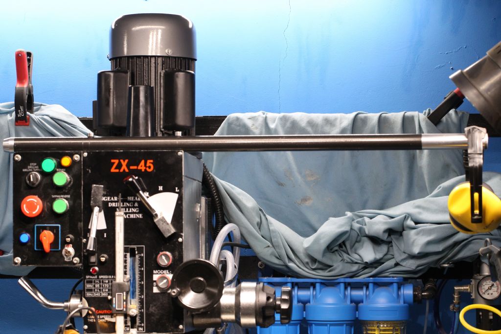

                          Biggest issue with this tramming game I have found, on both a Warco VMC and a Wabeco 1400 which both have variations on swivellling heads, is less about how to measure any errors and more about how to move the head under control to remove them. Usually ends up with soft-faced hammer on a non-critical part of the head, but it's not something I like doing to the machine, especially when there is a DTI in place to show the movement. And then re-clamping without the head moving…
                          #662308
                          Chris Mate
                            @chrismate31303
                            Hi Neabb, I did bolted a long thick aliminium bar to the top of my mill head to assist in moving the head, and it does help a lot making it easier, the leaverage is such I can bump it wih my fist, however I see in future I will make something "fexable" to adjust it accurately with two opposing bolts, like I do with vice and zeroing the X-Axis swivel function, no bumping.
                            Here are two photos added:
                            Edited By Chris Mate on 01/10/2023 12:24:52

                              30mm x 90cm aliminium bar bolted to head to make it easier to move, tap with fist.

                                                      I re-indicate it with coaxial indicator today at the top with quil extended everything locked-Ok
                                                      I then moved quil up, and lowered head to bed, check indication and it was off X-axis.
                                                      I then installed vice, re-indicate it in vice and it was spot on all directions. I took a cut ar flat piece of steel with shouldermill with etal inserts. I can see the 3x cut lines like in CNC work, but could not feel or measure the lines with -.01mm dial indicator. I also had the level box at 90 degree on left side of head, and it did not change from 90 degrees the whole time, not 100% accurate, but at least it did not move withing its limits of 1 degree either side of 90. I am happy with the front and back cutting as it cut forward(Conventional) and backwards(Climb milling).
                                                      This crap mild steel block, so it was not a mirror finish like I get with aliminium on same cutter.
                                                      So my next step is to buy/make a short arm for attaching a dial test indicator in spindle to the taper as well and see if I can determine if the coaxial indicator is more sensitve in visible movement per line as the test dial indicator .01 will show. I can see if I wind the quil down, the tip of lever touching the taper seems to move half the distance as to one line on coaxial indicator to next line. Will have to see how that compares to the test dial indicator.
                                                      What I do like is dialing it in in X1/X2 & Y1/Y2 points is actually quick and easy after chosing a position on taper, and you get all directions in one go while the indicator stay facing you. So it looks like the verical area around the vice jaws are ok till/if proven wrong by dial test indicator
