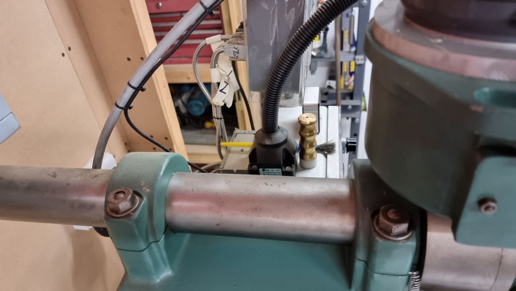

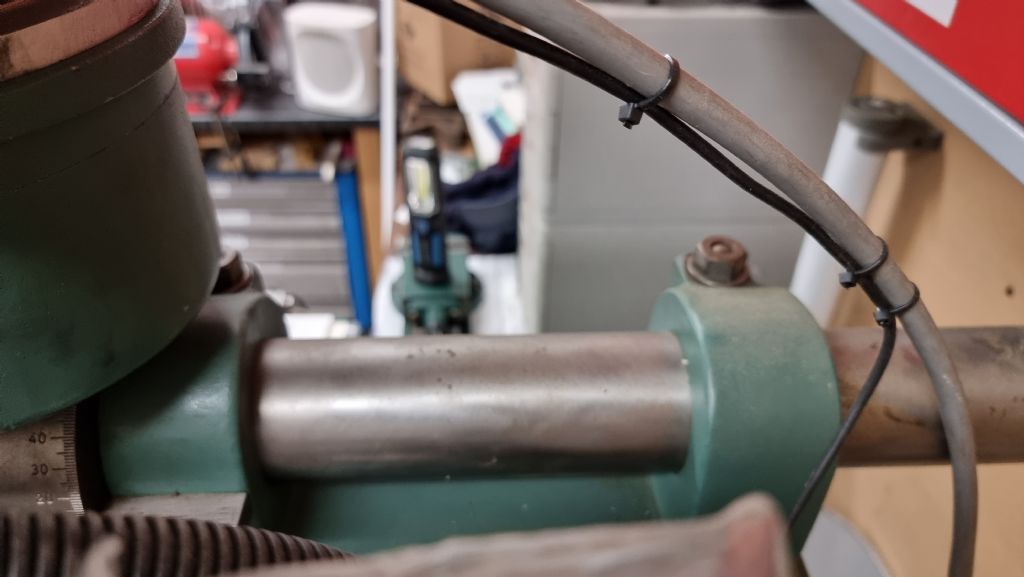

                Hi Old Mart. I think some are misreading this problem that is pretty unique to the Tom Senior.
                I found to get it right i had to have the tram out a few thou. Trial & error & then nip the 2 bolts It took a while. No matter how much you secure the head it still moves when tightening the 2 single bolt clamps.
                Pics to explain.
                Steve.
                #609274
                peak4
                  @peak4
                  Posted by Steviegtr on 11/08/2022 22:32:19:
                  I appreciate the problem as the Dore Westbury can be a bit of a pain, though the bolts are in a different place.
                  The reason I posted the photos of the tramming device, is that you can see what moves as you tighten things up.
                  Hence if you notice it always kicks, say 5 thou anticlockwise, you can set it up the same amount clockwise, and it might even out to zero as you nip up the bolts.
                  Bill
