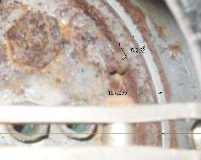

      Yes, comes up about 5.2mm so araond 5g
      Certainly is rail practice with the feed going down to the cylinders
      5p2

        Bill –
        Unfortunately being a coded welder would not be enough. That boiler is essentially irrepairable because the worst welds are in the least accessible place, and raise doubts about the condition of those elsewhere.
        The engine is recoverable but only with a lot of expensive work(new boiler), and a lots of designing and sometimes-heavy machining to replace the lost mechanical parts.
