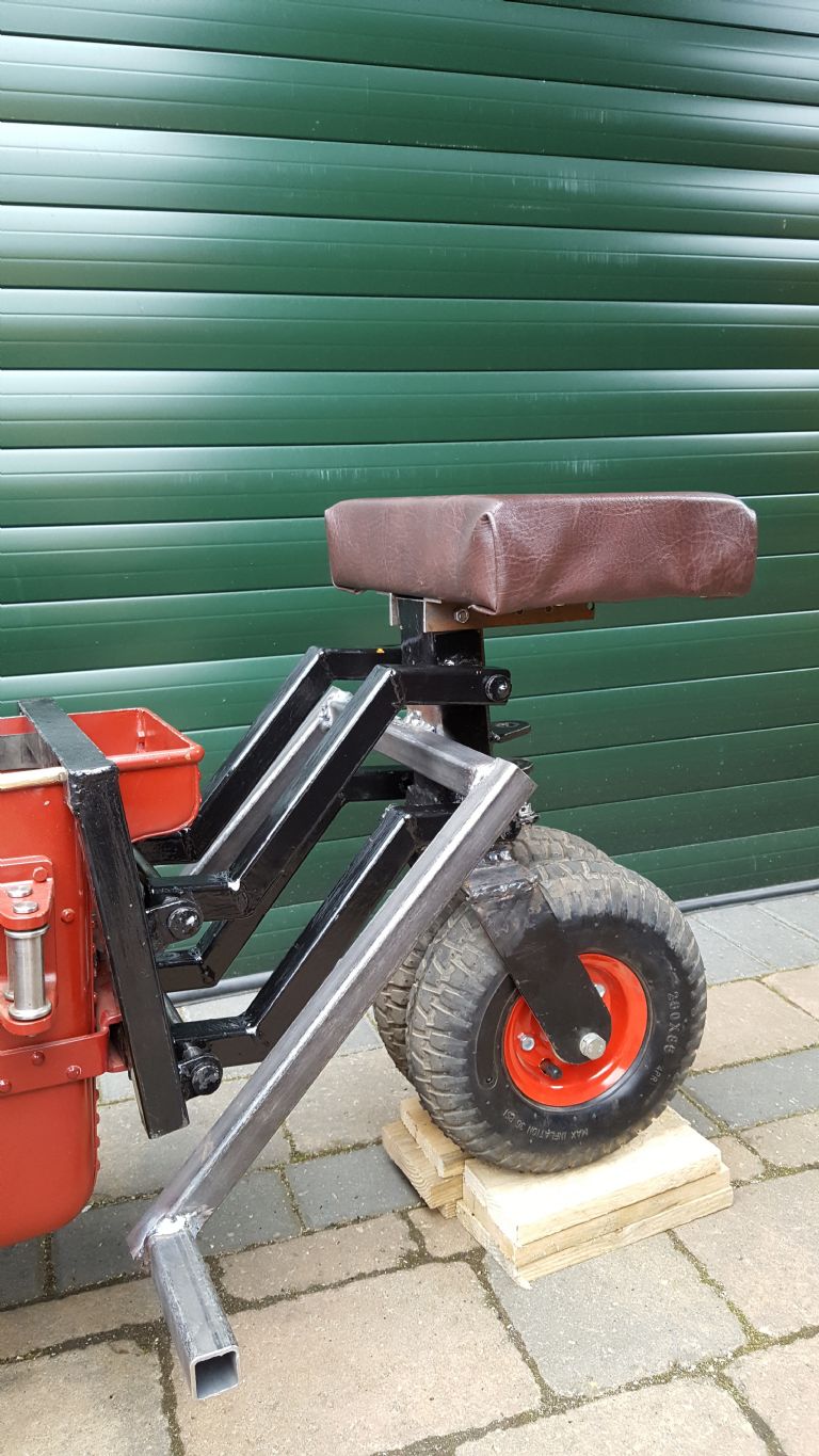

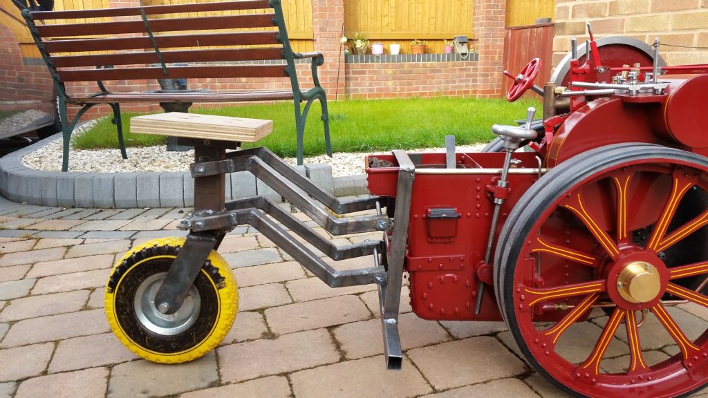

          I've not got a design but have built one for my 4" Ruston Proctor SD,
          Mk 1 Driving Seat
          This is Mk1 with a puncture proof tyre, this wheel was not man enough for my 12 stone. Steering on hard surface was good but on loose surface very poor.
          Mk 2 Driving Seat
          Mk2 Twin pneumatic wheels and footrest position changed, engine raised on blocks with scales under the front to check the downforce changes. The seat can also be moved for and aft to position bodyweight. Working better but still a little light at the front on a loose surface.

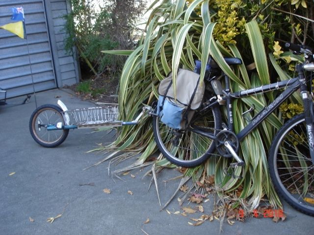

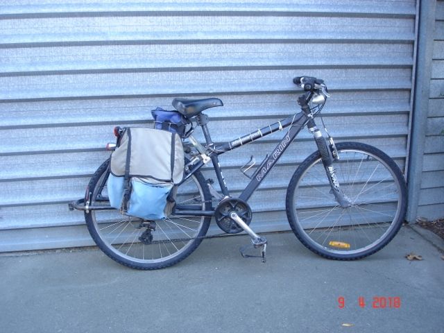

            dsc01365 (640x480).jpgA better point of suspension would be further foreward on the rear axle, I'v just done this for the trailer hitch on my new bike, the hitch on my old bike was from behind the rear wheel, and as the load on the trailer went up, so did the front wheel/ well it got very light.
            This is the old bike
            Ian S C
