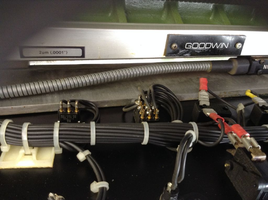

        I wonder if members might be able to advise me on a tricky problem please… I have an old edm machine, made c 1990. One of the switches has failed, but I can't work out which one as all the wiring between contactors, power supplies, logic boards and relays are all black and not numbered. There are about 50 wires in a bundle in one section, all the same colour! I know which contactor is not activating, and can prove it will work with power. So I know where the wires start, but can't prove the ends with a simple continuity tester as it is all pretty well inter connected so I just get false readings.
        Is there any other way of isolating a circuit like this, perhaps sending a pulse or signal down the wire?
        Any suggestions gratefully received. John

            I will post a photo – just for fun- showing just one bundle of wires – these go to some switches including "Start" – although I think the contactor in question may be powered via a relay – there is a huge board with loads of them on it.

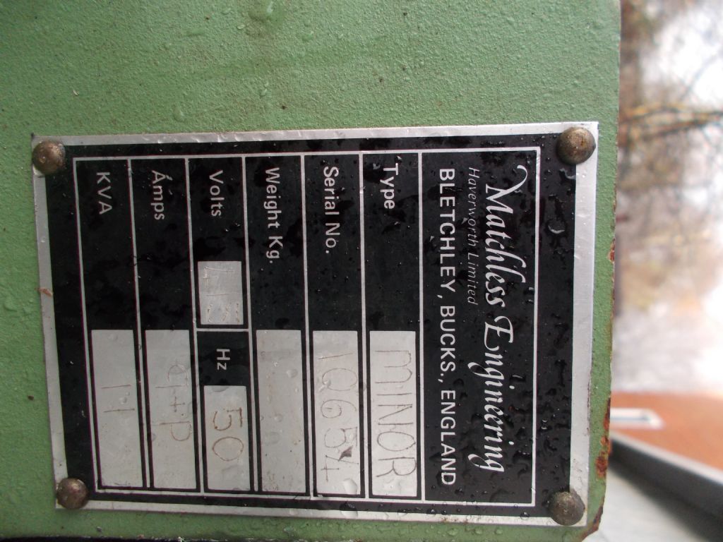

                              Chris, The machine is a Mecrode Minor. I have scoured the web to find anything on these, without success. If you know any means of getting to the "logic" of the machine that would be really helpful.

                                      You will see I have posted some pictures now.
                                      #232646
                                        John,
                                        I see from your pictures that it's modern enough that they used plastic cable ties.
                                        … On the bright side: at least you won't be cutting that lovely lacing that they did way-back.
