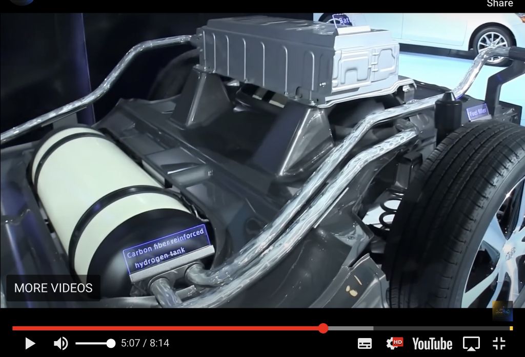

      Years ago I was paid to look into hydrogen powered aircraft (at a very basic level). What came out was that to achieve equivalent long range to existing aircraft the fuselage needed to be doubled in diameter to contain the liquified hydrogen. No room fo passengers and no account taken of the additional weight for the extra fat fuselage and its ncessarily robust construction.
      The point I'm making is that, if we just look at earthbound vehicles, hydrogen, even if pressurised to the point of liquifaction, requires significantly more space and structure than current fuels to contain it.
      … and yet it is claimed [whether truly or falsely], at about 05:10 in the video that I linked, that Toyota’s H2 can travel up to 300miles on 5kg of Hydrogen.
      #648216
      Robert Atkinson 2
        @robertatkinson2
        Posted by Michael Gilligan on 11/06/2023 17:46:58:
        Posted by ChrisLH on 11/06/2023 16:40:19:
        And at STP H2 is 0.09g/l so 5kg = 55,555 litres A pretty big tank. Even liquid is 0.078 relative density so 64 litres for 5kg, That does not include volume of the cryogenic insulation……

          Thats 21 MPG for liquid Hydrogen frown
              Hydrogen has nearly 3 times the calorific value of petrol, so this might equate to 100 mpg. I see no reason why it should be more efficient, it's still a combustion engine, so perhaps optimistic

                The plot thickens …
                Noting, of course, that Toyota is only claiming 300miles on 5kg for the little engine, not the V8
                Edited By Michael Gilligan on 11/06/2023 21:45:04
