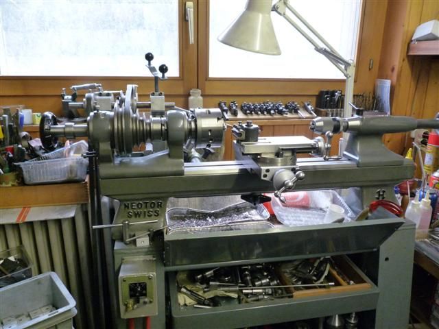

                  Versaboss
                    @versaboss
                    Posted by chris stephens on 16/02/2011 12:32:27:
                    Hi Versaboss,
                    Could you tell me which lathe you have that needs its top slide to be set parallel, I can think of lathes that do not have top slides, but none without a saddle. Or is it that you are you talking about watchmaker’s lathes, which I think you will agree are a special case.
                    Twelve degree cones are a little limiting for most model engineering purposes, but if needs must.
                    chriStephens
                     Glad to oblige, Chris. It’s this one:
                    Hooray, seems I managed to insert a pic directly… if only I culd do that with links also…
                    Not quite a watchmaker’s, but I agree you have a point here. My other one has a saddle who can move around! and even stop when it hits a stop!
                    Greetings, Hansrudolf

                      Thanks for that, now I see your problem. Should I recognise the lathe or is it something particular to your location?

                        Tony Jeffree
                          @tonyjeffree56510
                          Posted by chris stephens on 16/02/2011 23:57:39:
                          Hi Hansrudolf,
                          chriStephens
                          Remarkably, Neotor doesn’t appear on Tony Griffiths’ website, which seems to have info on all (other) lathes known to Man…http://www.lathes.co.uk/index.html
                          Regards,
                          Tony

                            Tony Jeffree
                              @tonyjeffree56510
                              Posted by Versaboss on 16/02/2011 22:28:22:
                              Hi Versaboss,
                              chriStephens
                              Hi Hansrudolf –
                              That lathe looks as if it just came out of the factory…is it original condition or have you refurbished it?
                              There are some rather tattier examples of this lathe on Tony Griffiths’ site:
                              I’m sure he would appreciate any info that you could send him.
                              Regards,
                              Tony

                                Hansrudolph which side are your gib adjusters on the top/compound slide. Your side ot the other? I made something for  an old friend of mine.  Problem is he is over 1000 miles away

                                  Richard, you don’t see the screws do you? Well there are none. Both slides have tapered gibs. The topslide has it on the back, adjustable from the left side. The cross slide on the right, adjustable from the back side.
                                  Tony, I have no informations of value for T. Griffith. What I know about this lathe is just that it (she?) started life as a special machine in a button factory (clothing’s, not toolmaker’s!). A friend of mine, who is unfortunately no longer among us, rescued it from the scrapyard and rebuilt it. I think he did a spray job then also, and he used a really good quality of paint. The tailstock was new then. That was over 30 years ago and it was possible to get parts from the factory. Because of that special history the bed is not scraped as usual in that kind of machines, but simply ground (and quite scratched now). The chip tray was made by me. I also added a countershaft (but only with 2 pulleys), and a (ex scrapyard) motor with integral stepless gearing. First I had a very worn Schaublin toolslide on it, but later I could get a new original Habegger at a good price.
                                  Naturally, over that long time I collected and made lots of accessories. Chucks, collets (W20), spindle dividing gadget (GHT adaption), lever operated tailstock with tool turret, lever operated collet closer also.
                                  ME content: that old Schaublin slide I want to convert (after rebuilding, new screws etc.) to CNC. PC, EMC, steppers, drivers all ready, only my time is missing…
                                  Btw, Neotor (type) is to Habegger (factory) what e.g. Student to Colchester.
                                  OK, that’s it, in a (large) nutshell
