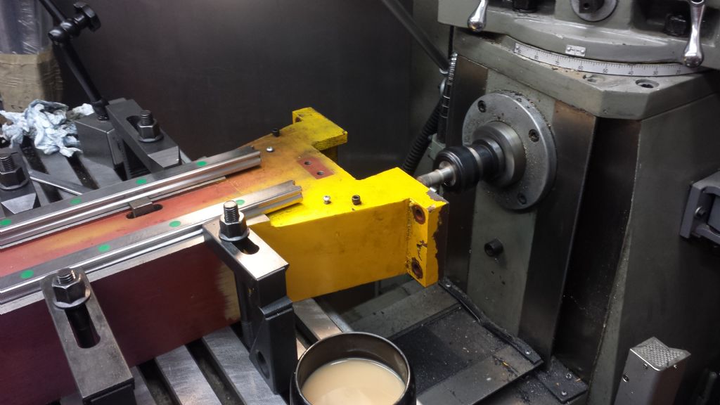

          From personal experience with my Syil X5 Plus, I would suggest staying as far away from Syil as possible.

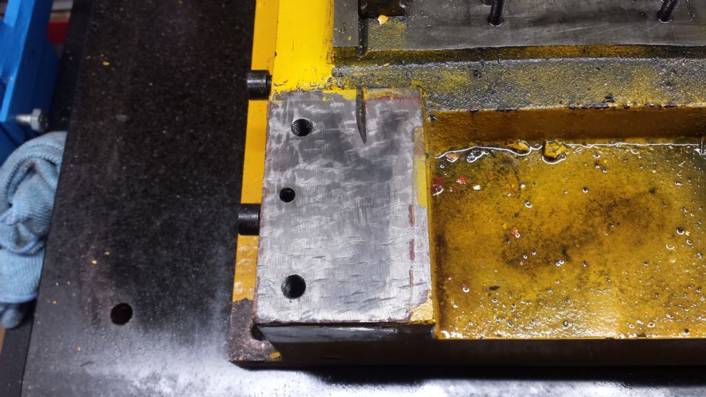

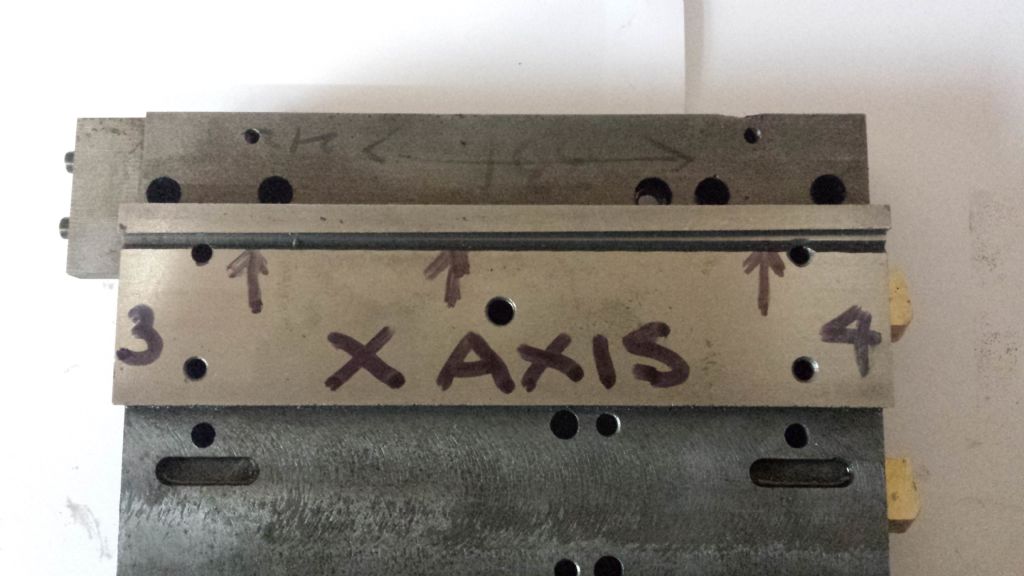

          The X and Y Axis were not perpendicular to each other by approx 0.8mm over the Y axis travel of 160mm.
          The cause was abysmal machining of the Saddle, with obviously no QC at the assembly stage:-
          Saddle Fault

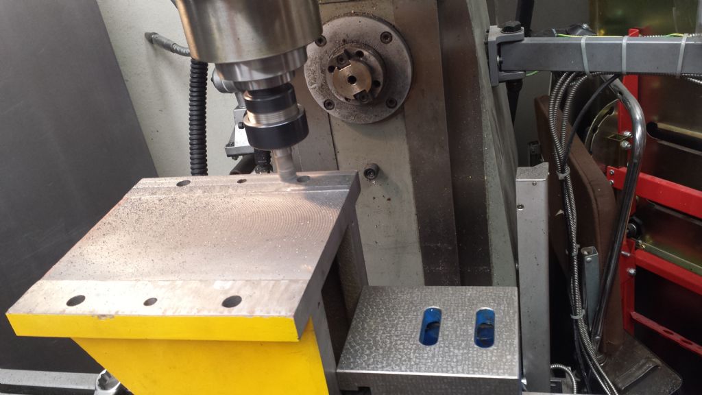

          Then there was the Fore – Aft and Left – Right leaning of the column (Z Axis), again caused by crap machining and the comical scraping, that appeared to be done with a hammer and chisel, to disguise the angle grinding bodging:-
          Pad Scraping As Supplied

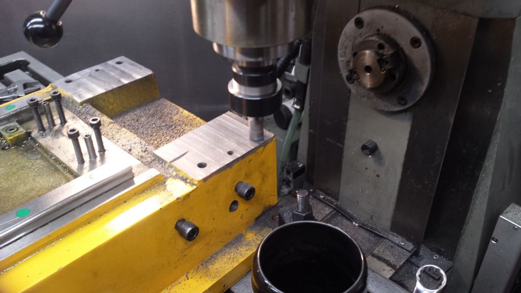

          As the spindle was also not parallel to the Z Axis, again by a considerable amount, i ended up re machining almost everything and in conjunction with a precision Granite Square, managed to get everything geometrically aligned to within 0.01mm.
          Machining Pads
          Machining Column Base
          Machining Head
          Not to mention the total lack of support from both Syil UK and Syil China (although to be fair, I think Syil UK suffer from the same problem with Syil China).

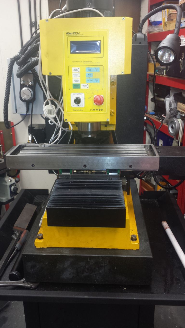

          Edit:- Because the base casting is so flexible, I had to mount the machine on to a cheapish granite surface plate, before then mounting it back on to the stand, to prevent twisting as it was bolted down:-
          Machine On Granite
