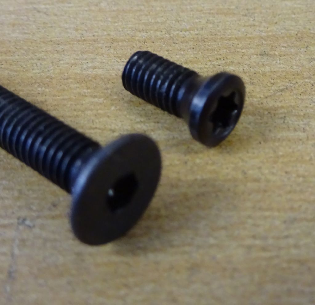

                                just wondering, but why are torx better than hex CS screws in this application? Is the head size relatively smaller, or???

                                  Posted by russell on 05/05/2016 04:07:52:
                                  Russ,
                                  I think it"s really down the the geometry of the driver/socket.
                                  Especially at small sizes, the hexagon is more prone to rounding than the 'star-like' Torx.
                                  Head shape is also optimised for these screws, but robustness of the drive is the big feature. … Torx is better-engineered for the job.

                                  #237564
                                    -russ
                                    Head size is also substantially smaller for the same dia thread mostly due to the steeper CSK angle used BUT the key is considerably larger which helps avoid stripping of the key, these are the same size thread.

                                    #237566
                                    Raymond Anderson
                                      @raymondanderson34407
                                      russell, As far as i'm aware Socket head cap screws whether Torx ® or Hex all share the same head dimensions. [just checked a few sizes of each] so i'm not sure of the reason for using a Torx ® over a Hex. One thing is for sure, and that is the head profile must match the insert hole profile. I have in the past [due to losing one ] had to turn down a standard hex to get me out of a jam [until I got a replacement]. and it worked ok, but I do prefer to use the proper insert screw.

                                      #237570
                                        My guess is that they want as much material in the insert as possible for strength, and a torx allows a much smaller head for a given torque.
                                        Neil.
                                        #237574
                                        Raymond Anderson
                                          Just been checking with AccuGroup and even Countersunk skt screws [hex] and countersunk skt screws [Torx ® ] all share the same head sizes Insert screws, as in Jasons pic have a much smaller head but then they are not a "normal" csk screw. So yes, it must have something to do with the tightening torque.
                                          I have a few inserts / toolholders that use what at first appears to be standard skt head cap screws, and they are anything but. The underside is machined to the same profile as the insert hole. There is such a variety of clamping methods /screw sizes / profiles , The Torx® style is the most common.
