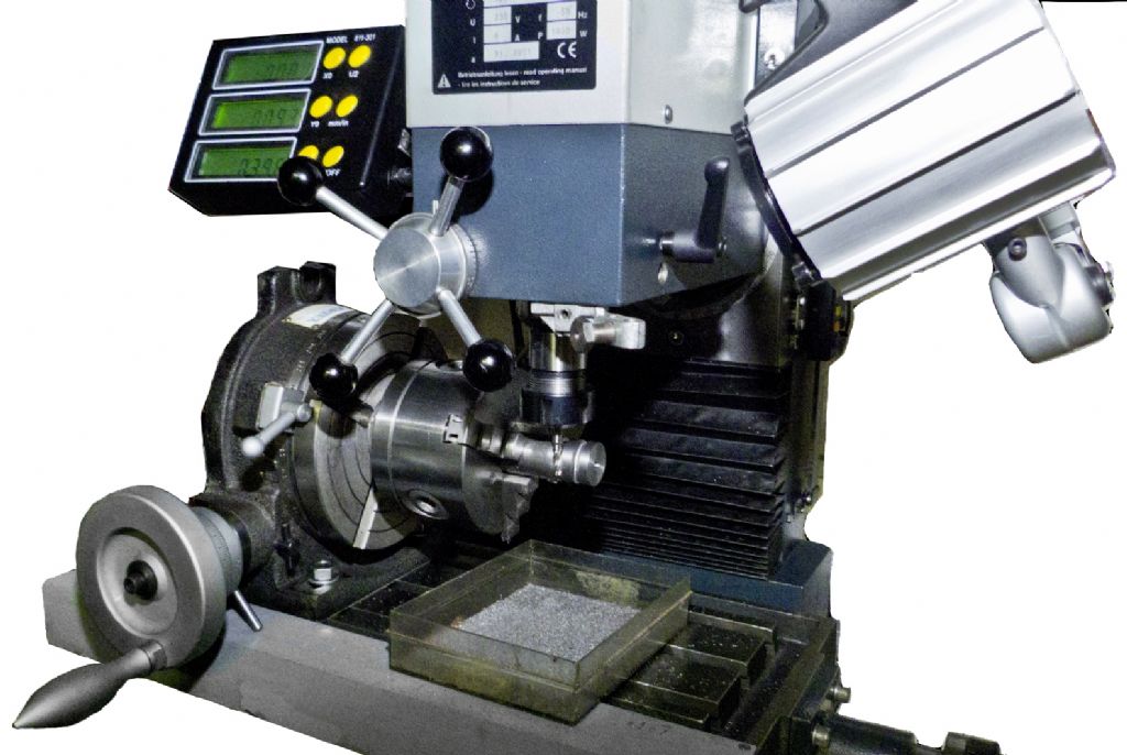

            I will be bending copper tube soon and am considering making a tool and formers.
            The formers for the design I intend use are cut using a milling cutter. The bar for the former is held horizontally in a rotary table on a milling machine and the groove cut by an end mill or slot drill while rotating the former. After a number of passes you should get a good semicircular groove.
            Take a look at https://modelengineeringwebsite.com/artisans_pipe_bender.html His bender is a copy of one that was written up in ME a few years ago. Like him, I cannot find my copy.
            JA
            The method is described in "A Review of Pipe Bending Options", MEW of January 2016, on the last page of the article.

                Alternatively we can use the milling technique that JA cites. I have not tried it, but it is a perfectly valid method, advantageously using standard cutters the size wanted.

                    Re. JA's posting (above), I went for "Artisan's" design of tube bender and have been well pleased with how it works. I also used same procedure as JA proposes to adopt tp make the various formers. Using the mill this way, it is easy to make many in a short time. I recollect making about 20 before giving up and have only ever using about 6 since then ! I think you can still get get a copy of Artisan's article on CD via David Carpenter's website.
