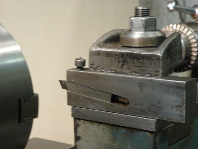

                    1/4" HSS is plenty for a Myford, cheaper and easier to grind than 3/8". Picture shows an arrangement that I copied from a Myford owner and used  for years on my Boxford. Cheap as chips. With a selection of home-made holders, tool changing takes seconds. The packer for the Boxford is a piece of 1/4" plate, about 2.5" sq. with a hole drilled for the tool-clamp stud, but might not be needed for the Myford. I later replaced the clamping nut with a permamently mounted handle.
                    Tool-holder
                    Edited By Clive Brown 1 on 11/05/2020 08:55:18

                      Posted by Clive Brown 1 on 11/05/2020 08:50:51:
                      Tool-holder
                      That angled holder looks a brilliant idea, would make it super easy to get a perfect centre.
                      Is there anywhere you can buy these? Im assuming you milled yours out to suit?

                              I milled most of mine using a vertical slide, which incidentally I'd much prioritize over a QCTP if a milling machine wasn't in prospect.
                              The angle does give "micro" height adjustment but also gives top-rake with minimal grinding, so tool-bits can last longer.
                              Material is 5/8" x 1" BMS.
                              Round hss for boring tools can be catered for by drilling the toolholder whilst clamped on the top-slide.

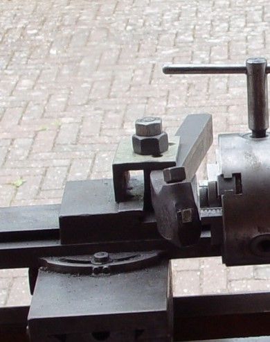

                              Dave Halford
                                @davehalford22513
                                Posted by Shaun Belcher on 11/05/2020 08:58:43:
                                Posted by Hopper on 11/05/2020 08:23:35:
                                Yes looks like it needs to be dropped a bit. You can use any strips of steel for packing. Bit of 6mm flat bar and bits of thinner sheet metal for fine adjustment might do it.
                                I don't mind the four way toolpost myself but it seems the QC ones are popular these days but you have to make sure you get the right one. Not all are great quality and not all fit the Myford well.
                                I was looking at the ones RGDtools sell, they seem to be reasonably priced and good quality, seem lots f myford users buy theirs.
                                Tool-holder
