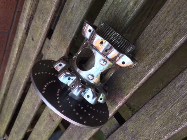

      Hi,
      I am working on a 1951 Formula 3 car and need to make a pair of new drive shafts. The inboard end is a straightforward spline that fits into the Hardy Spicer joint, the outboard end though is more complex.
      I think this is an involute spline with 19 teeth that fits into the CV joint in the hub. I suspect that the CV joints are from classic mini.
      Can anyone advise how to properly identify the spline form and suggest a source of tooling? I am anticipating machining the spline on the milling machine in a dividing head so I am imagining something that looks like a gear cutter? I don't have any significant grinding facilities to make a cutter, so I assuming I will need to purchase something.

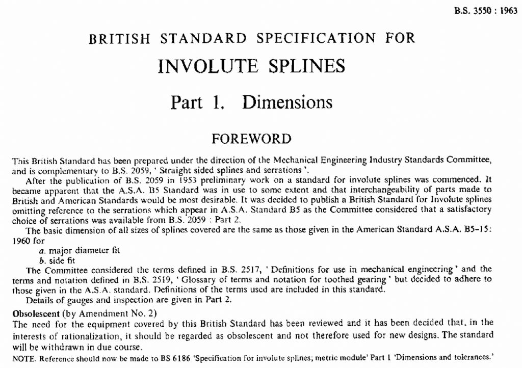

                There is a British Standard for involute splines, BS3550 (pdf copy on Scribd), but it is 1963, so a bit late. However, if you can read the introduction/preamble to it, it may reference an earlier standard from which it was derived or consolidated.

                  Posted by DC31k on 30/04/2020 13:49:40:
                  That standard [which is now withdrawn] is mind-bogglingly detailed
                  I have, however, [hoping that BSI will not be offended] copied this introductory text … which might be useful in that it cross-references American standards.
                  P.S. ___ I think a definite identification of the CV joints would be very helpful, IanH …

                    Definitive identification of the cv joint is tricky. The car originally had hookes type joints in the ex BSA three Wheeler front wheel drive hubs, but these were replaced at some point during its life with the cv joints. I think they are likely to be mini (small, cheap and available) but can not be certain.
                    If I could find some info or a spec of the mini spline form then it would be handy, but my Internet searches are not successful so far.
                    I have found Sandvik produce some tooling for cutting splines but I need to investigate that option further.
                    Ian

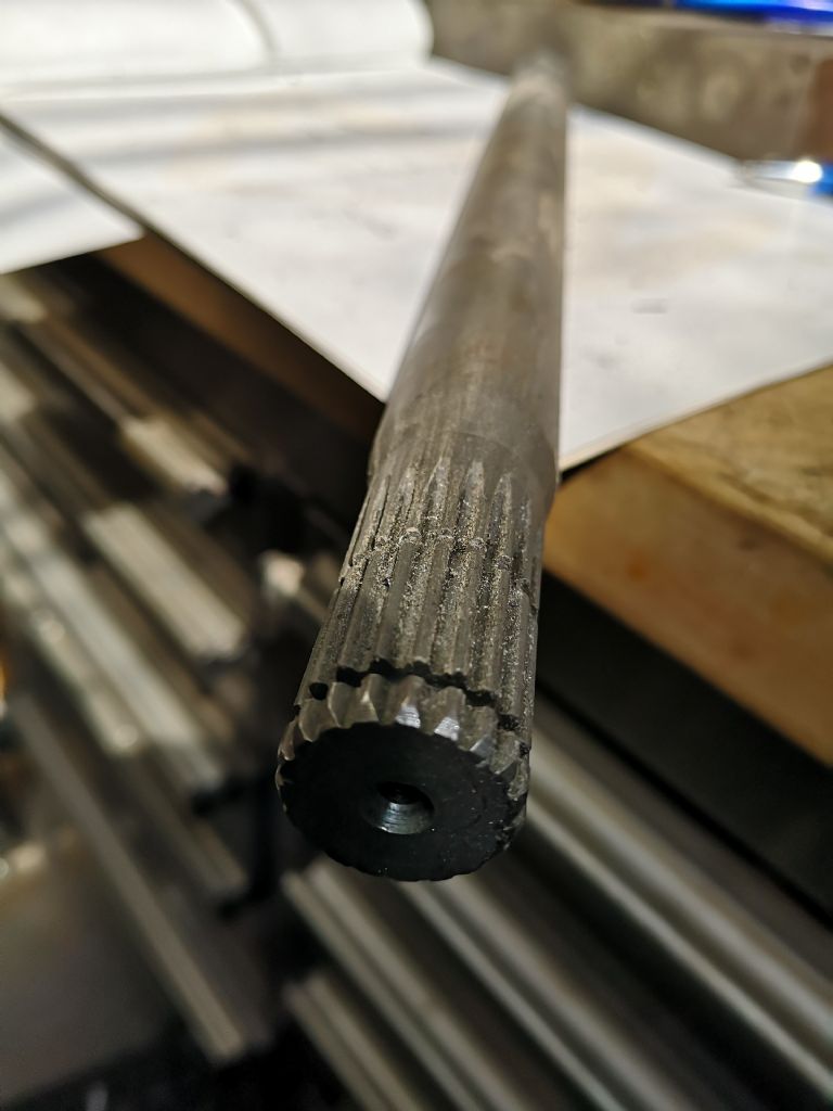

                        The problem I have is that the drive shafts that came with the car were too short. I do not know exactly how much too short yet as I have not yet built and fitted the new front driven axle (all machined ready to assemble).
                        I am assuming that I will use the scrap drive shafts to determine the lengths of the new shafts – essentially by cutting and shutting them in the assembly. There are outfits that will make custom drive shafts to your spec, but apart from the problem of specing the involute spline (other than by giving the machine shop one of the originals as a sample) I am keen to make my own if I can.

                              Just a thought……..Are you looking at a "Serrated" shaft or a "Splined" shaft ?
                              I have always described what you have in the photo as Serrations, so you might find more information using that terminology perhaps.
                              My B.S. A19 from 1941 cover aircraft Serrations, but it jumps from 16 to 20 with no mention of 19.
                              Serrations are generally straight sided, but your do look to have some curve on the sides, so maybe the involute suggestion is a good one.
                              The standard method of measurement is with two pins in the grooves and a dimension taken across them, but again with an odd number this does not make life easy. All the one listed in the BS are even numbered.

                                          If you are not in too much of a rush to complete the machining you could try a single point cutter and fly-cut the splines/serrations.
                                          #477871
                                          Mick B1
                                            @mickb1
                                            Posted by Brian Oldford on 06/06/2020 09:09:32:
                                            That's what I thought. I've done that in the remote past for a toothed-belt wheel for Ford. You grind the single-point cutter to fit the profile of the spline, finishing with a hand-stone and checking with engineers' blue. Takes a while, but it works.
