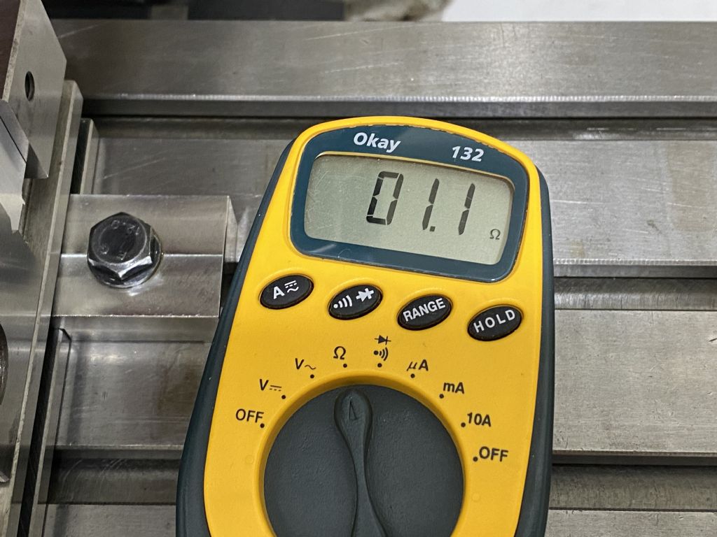

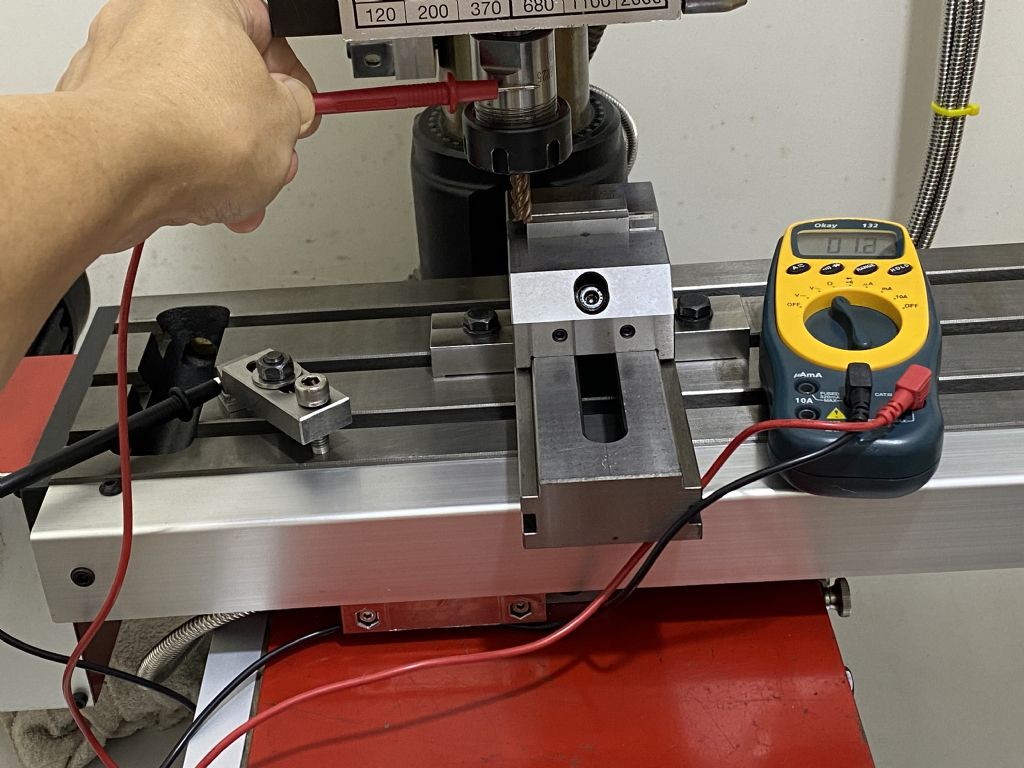

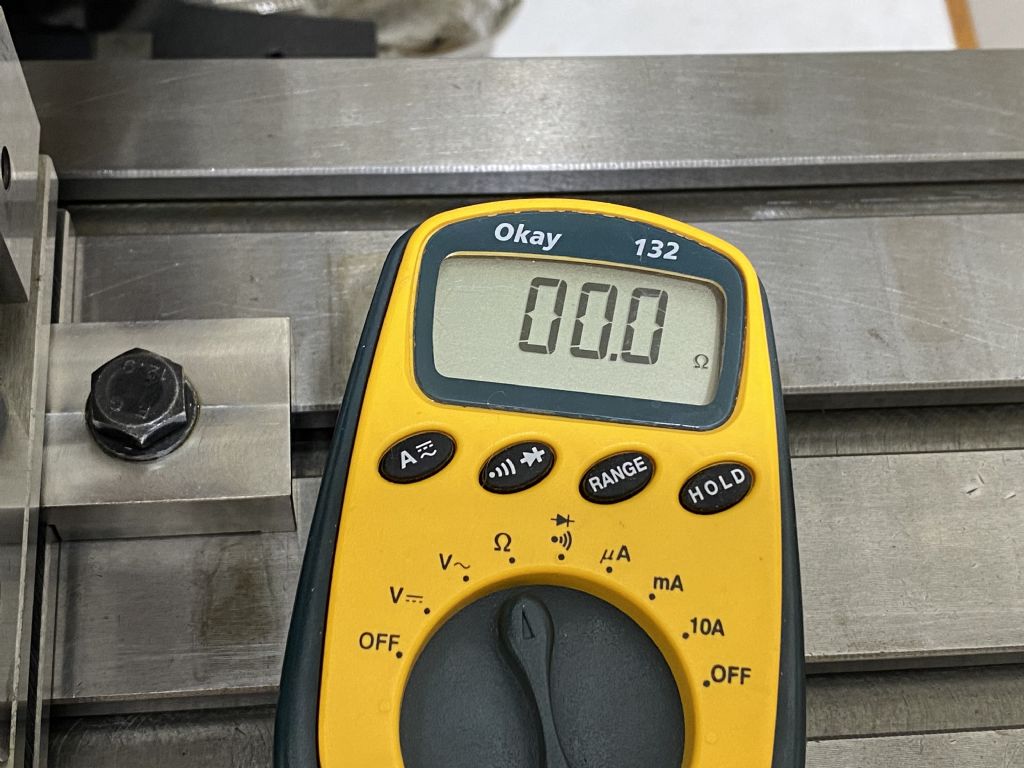

      I tried today using my 30+ year old and cheap multimeter as a touch sensor for my Emco FB2 bench mill and much to my surprise, the precision is VERY good !
      With one probe touching the table and the other touching the arbor, the resistance measured is 1.1 ohm when the tool is not in contact with the workpiece. This value varies a lot depending on the angular position of the spindle. It can go up to something close to 10 ohms but it never went below 1 ohm. As soon as the tool comes into contact with the workpiece, the reading would drop sharply to zero.
      To test the precision, I made a shallow cut on the top of an aluminium block with the end of the mill ( 8 mm carbide ) to get a clean datum surface. Then I raised the head, connected the multimeter and very slowly lower the mill head until a sharp drop in reading occurred. Then I locked the head, painted the workpiece surface with a marker pen and did another pass. The paint was not scratched a bit. After that I lowered the head by just 0.005 mm ( or 2 tenths of a thou ) and cut again, the paint was completely removed. This proves that cutter was brought back to the original Z position with practically zero error.
      I will definitely use this method a lot more in the future.

          That's very interesting. Because the the machine itself is conductive, I just assumed there was no point in electrically detecting contact between workpiece and tool, but your successful experiment shows how wrong I was. Thank you for a very interesting result.

              An analogue meter should perform even better. A problem with digital meters is they're relatively slow because the analogue voltage has to be digitised, processed, and displayed. Each stage adds a delay, which is often noticeable, plus the operator has to react to it. So the operator is likely to still be moving the head well after first contact.
              Analogue meters respond much faster, the delay being mainly the time taken to accelerate the needle and the operator noticing it's moving. Faster still is a lamp or LED, both being practically instantaneous. That leaves the operator's visual system, which is also surprisingly slow, taking about 0.2 second to respond. Ears are quicker, about 0.16s, so in theory a circuit that beeps on contact should be the most accurate. Best way of detecting actual first contact is to eliminate the human!
              I doubt the digital meter's result is really good to within 0.005mm, but don't let that put anyone off – the method is useful and potentially improves on the alternatives. I usually whisk off a bit of cigarette paper stuck to the job with a drop of oil, a method which also has accuracy reducing shortcomings! However, I think cigarette paper partly compensates for the operator's slow reactions, and might be best for some people, we're all a bit different. First contact is with the paper about 0.02mm away from the metal, so by the time the operator stops advancing the tool, the cutter is significantly closer to it. Not spot on, but good enough for most purposes.

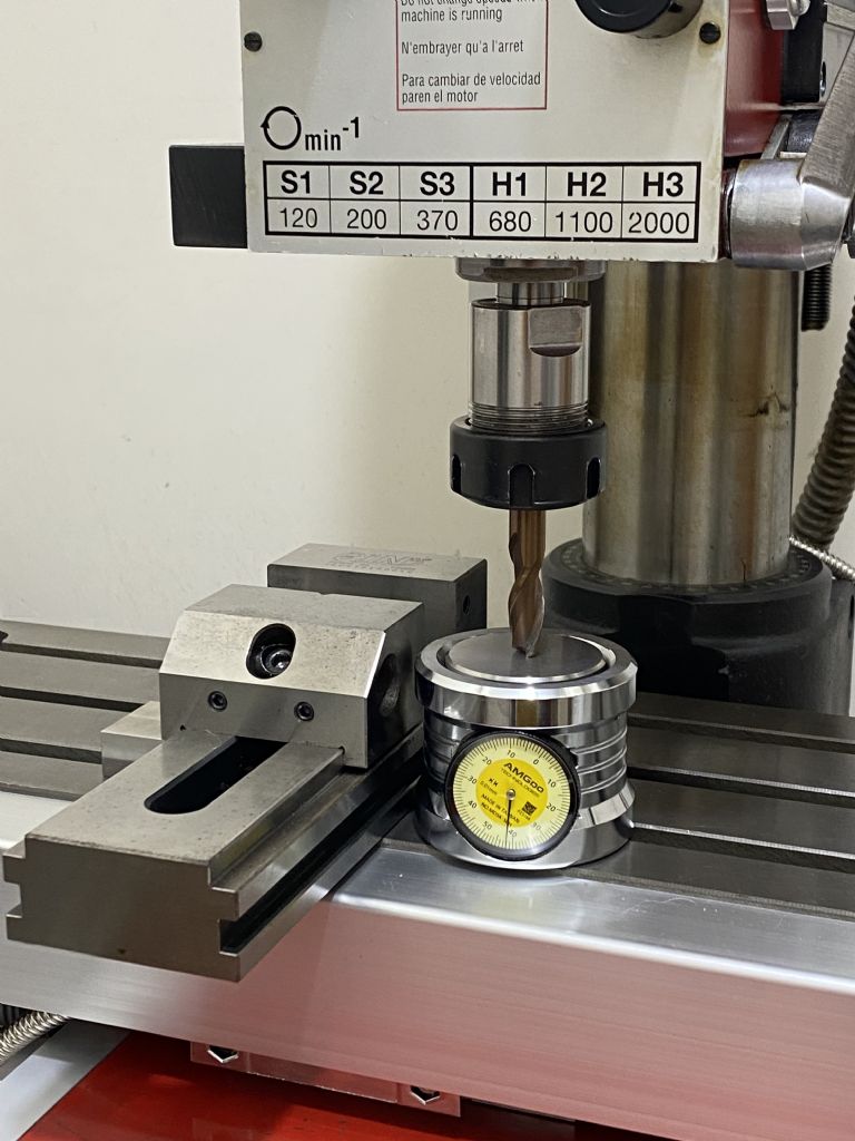

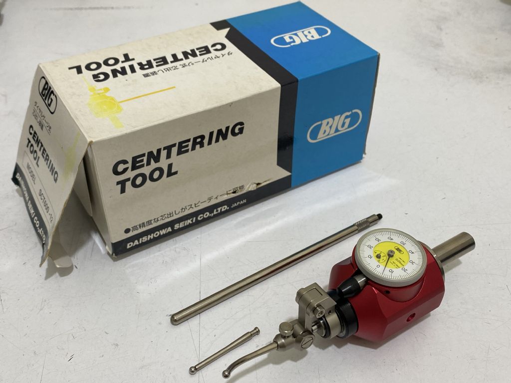

                          #601815
                          Kiwi Bloke
                            @kiwibloke62605
                            The device pictured above is an oriental knock-off of the American Blake Co-ax indicator, which was priced at $267 in 2006. I daren't look up its current price! Blake claim centring to within two 'tenths' (imperial), but I don't trust mine to better than just under a thou. Compared to a lever-type indicator on a fixture in the spindle, it's a rather more complex mechanism, necessitated by the nice feature of having the dial assembly not rotating with the spindle. The complexity must be paid for in accuracy and repeatability, and wear. A simple 'indicator on a stick' can be as sensitive as the indicator (one tenth indicators are common enough, if expensive), and there's nothing twixt workpiece and indicator to add error. However, the Blake is often quicker and more convenient to use – provided there's enough headroom. An indicator on a stick is more versatile. Of course, this assumes the 'stick' is satisfactory. Look through Stefan Gotteswinter's videos to see his in action in many and varied applications.
                            Edited By Kiwi Bloke on 15/06/2022 11:45:44
                            #601819
                            Y C Lui
                              @yclui16187
                              Posted by Kiwi Bloke on 15/06/2022 11:40:18:
                              I bought this Japanese version some 20 years ago. Very well made but I never used it because I found it to be inaccurate when I first tried it out on my Emco FB2 bench mill. Then as I learned more about my machine, I found that the error was solely due to the misalignment of the mill. Neither the column nor the spindle was perpendicular to the table so the X Y shifted when the head is moved up or down. Now the aligment issue is sorted out but I still do not use the tool because I had to move the head up by quite a lot before there is sufficient vertical space to accomodate the tool. Kind of tiring. Will let it go if anyone is interested. The condition is close to new.
