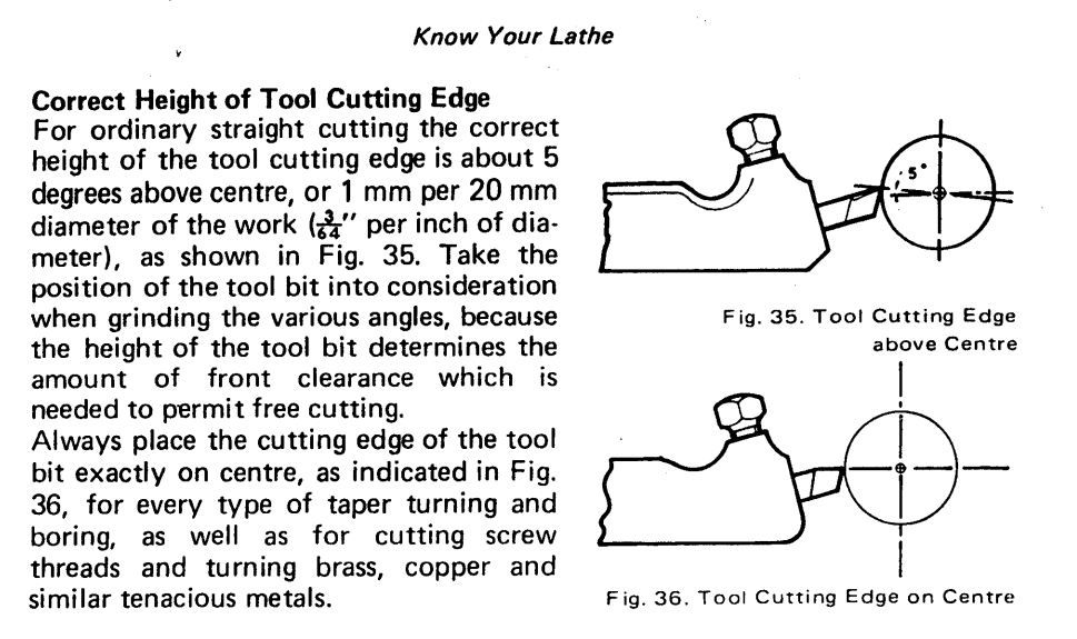

                        And to cap it all, Boxford say that for plain external turning, the correct tool height is 5 degrees above centre height. Presumably to ensure a positive thrust against the cross slide feedscrew and thus prevent any tendency for the tool to be drawn into the workpiece.

                          I can’t see where the 5º from centre height can be used. If it was a measurement, then yes, but an angle, where from and how?
                          At one time, it was always recommended that you set your tooling slightly high, but to me that comes from our distant past, where machines and tooling were always more flexible, with carbon tooling and old fashioned lubricants. You set it high, and by the time the tooling was cutting, the flex allowed the tool to end up at the exact, or very close to the exact centre height.
                          The general consensus nowadays, with the use of more rigid tooling (HSS & above) plus the fact that high pressure lubricants now have a constant film thickness whilst working (you do use the correct oils don’t you), is to set your tooling perfectly on centre height for the larger more rigid machine, and a couple of thou higher for the more flexible benchtop machines.
                          But even with that said, it still boils down to learning your machine and what the requirements are for getting it to cut correctly. I know mine cuts perfectly and to size when I set to exact height, yours might need to have it set slightly different.

                            I would presume that the 5 degrees thing would maen that the angle between a line from the tool point to the centre would be at 5 degrees above the horizontal, an awkward thing to measure other than by the razor blade/ruler method. I can’t see it working on a facing cut, since the angle would then increase countinuously until you reach the centre. Anyway, the main effect of setting the tool slightly overheight like that would be to increase the top rake by 5 degrees and reduce the front clearance by the same amount.Since the front clearance is often only about 5 to 10 degrees, this does not seem like a great plan to me
                            There was some correspondence once in ME about supposedly reducing the tendency of boring tools to dig in by setting them a little above centre height. The theory was that with the tool exactly on height, any downward cutting foce would be taking it deeper into the material. So, the theory went, if it was a bit higher, any deflection would mean it was reducing the cut. That turns out not to be the case. The tool itself knows nohing about the centre height, it is “seeing” a piece of metal go past at an angle relative to its geometry (top rake and front clearance) The direction of the forces on it will depend on the said geometry and the nature of the material, and may be such as to drag the tool into the material or to push it out. Positive top rake will tend to increase the tendency to increase the cut, while negative rake will tend to push the tool back out of the cut, but as those who have turned bronze will know, this is very material dependent.
                            So my thinking would be to set the tool as exactly on centre height as is reasonable to acheive, and to adjust  the top rake and clearance as needed for the particular material.

                                I believe the 5 degree figure is from a 1988 copy of Know Your Lathe.
                                I attach a screenshot of the relevent page.
                                Martin.
