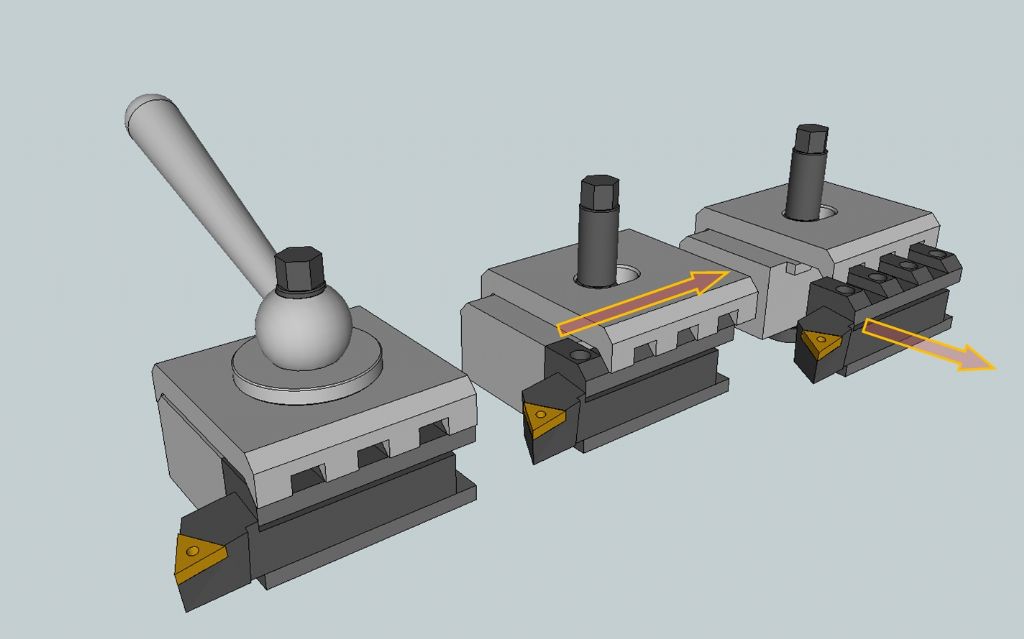

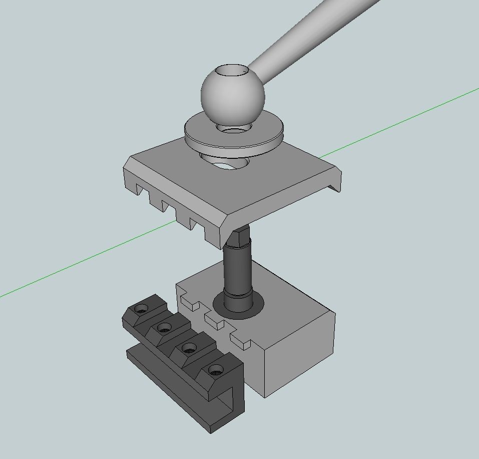

                                            ChrisB
                                              @chrisb35596
                                              This the latest amendment to the plans to allow for releasing the tool holder to the side, and without removing the top plate off.
                                              Added three tenons to the tool post block which will engage in slots on the tool holder. This will locate the tool holder for repeatability and prevent the holder moving rearwards.
                                              The top plate wedge and tool holders are slotted with matching grooves. The idea is that to release the tool holder, I release the threaded handle ( half a turn maybe) and slide the top plate rearwards ( the plate centre hole is slotted to accommodate for this). When the top plate slides back the tool holder is disengaged from the "teeth" on the wedge and can slide to the side.
                                              I guess it's not easy to explain but hopefully the drawings can make better sense…or not!
                                              The below drawing shows the tool post in the closed and tool engaged position (left). Unlocked and tool disengaged position (mid) unlocked and tool exit to the side (right)
                                              #427709
                                              Nick Wheeler
                                                @nickwheeler
                                                I think you've gone backwards: that's added a lot of extra machining to each toolholder – you need a lot of them, so that's important – that doesn't justify its existence. That's why I like John Stevenson's suggestion to reverse the dovetails on a more traditional style post, and put the male dovetail on the holders.
                                                #427712

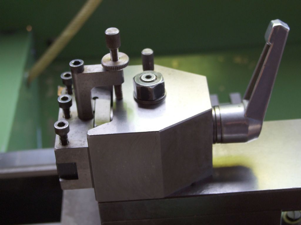

                                                  bricky
                                                    @bricky
                                                    p1040176.jpgThis is my toolholder based on the Pratt-Burnerd design p1040179.jpg

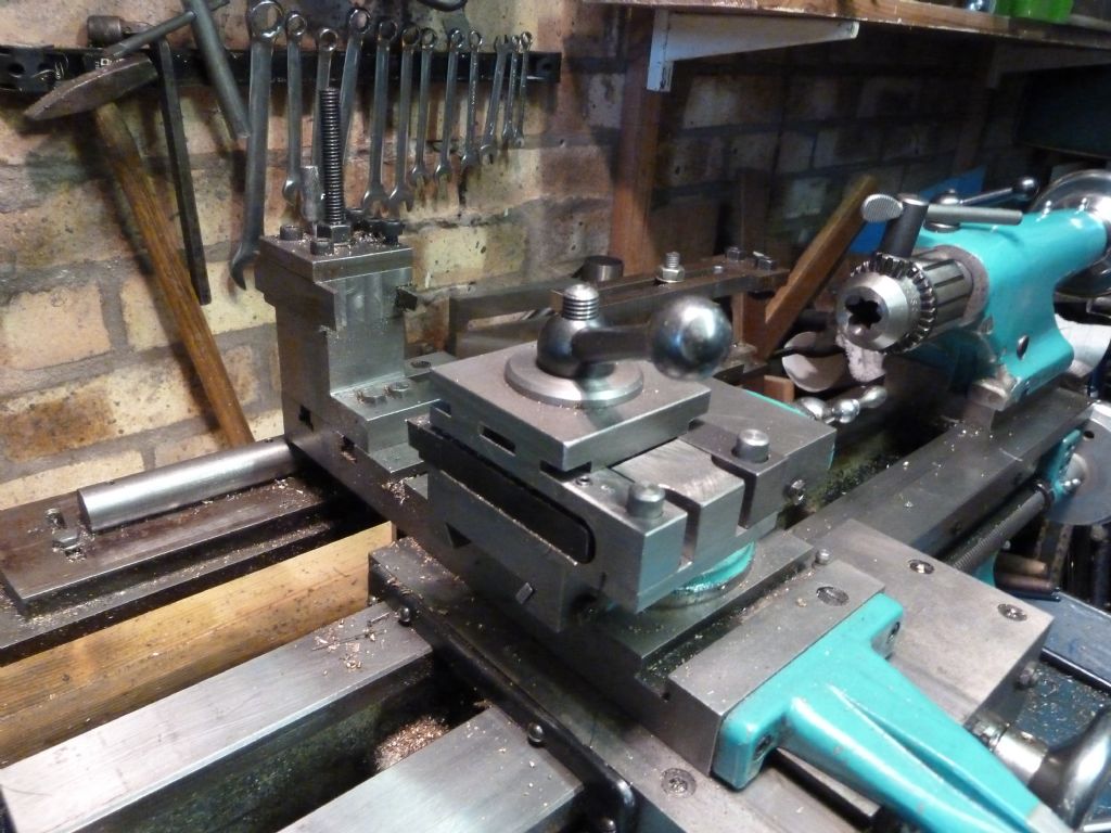

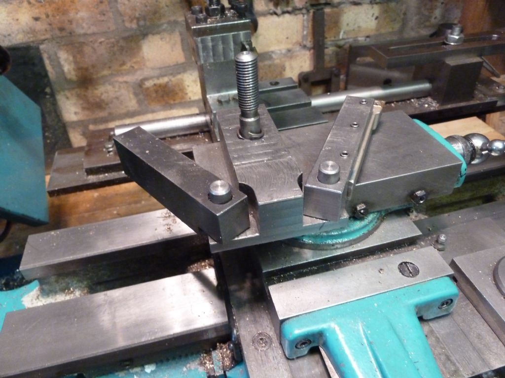

                                                    #427738
                                                    Graham Meek
                                                      @grahammeek88282
                                                      This is a solution I made in the late 1980's before going back to a 4 Tool Turret, based on George Thomas's design.
                                                      Regards
                                                      Gray,
