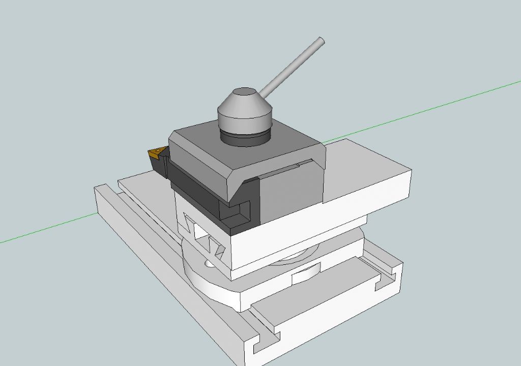

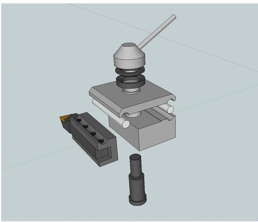

        A quick change tool post has been on my to buy or to do list for far too long now. Having researched a fair bit on the subject I narrowed the options, so if I were to buy a ready made one I would go for the Aloris wedge type tool post. On the other hand building my own is more difficult to decide which way to go – I was originally in favour of the Norman type post, then I saw Mikes's modified Norman post with expanding collet which I liked even better. Then somewhere on the forum I saw mention of a Pratt Burnerd tool post – I'm basing my build on the latter.
        The tool post will fit on a WM280 lathe, I plan to replace the top slide with a solid block later on, but I want to tool post to be interchangeable with both top slide and solid tool post mount. The tooling I use is mostly carbide insert type and I have recently acquired a lot of 16mm shank lathe tools, so the holders have to fit these tools.
        This is the general layout of the tool post as compared to the 4 way tool post (next to it) A brief description of how it works: The cutting tool is held in a tool holder clamped by 4 grub screws (not visible). The tool holder is clamped to the surface of the topslide by means of a top plate. The two round pins concentrate the clamping force downwards and at the same time prevent the tool holder from sliding under cutting forces (hopefully).
        Under the top handle nut will be a spherical washer set to take into account any misalignment so that the tightening force rest squarely on the top plate.

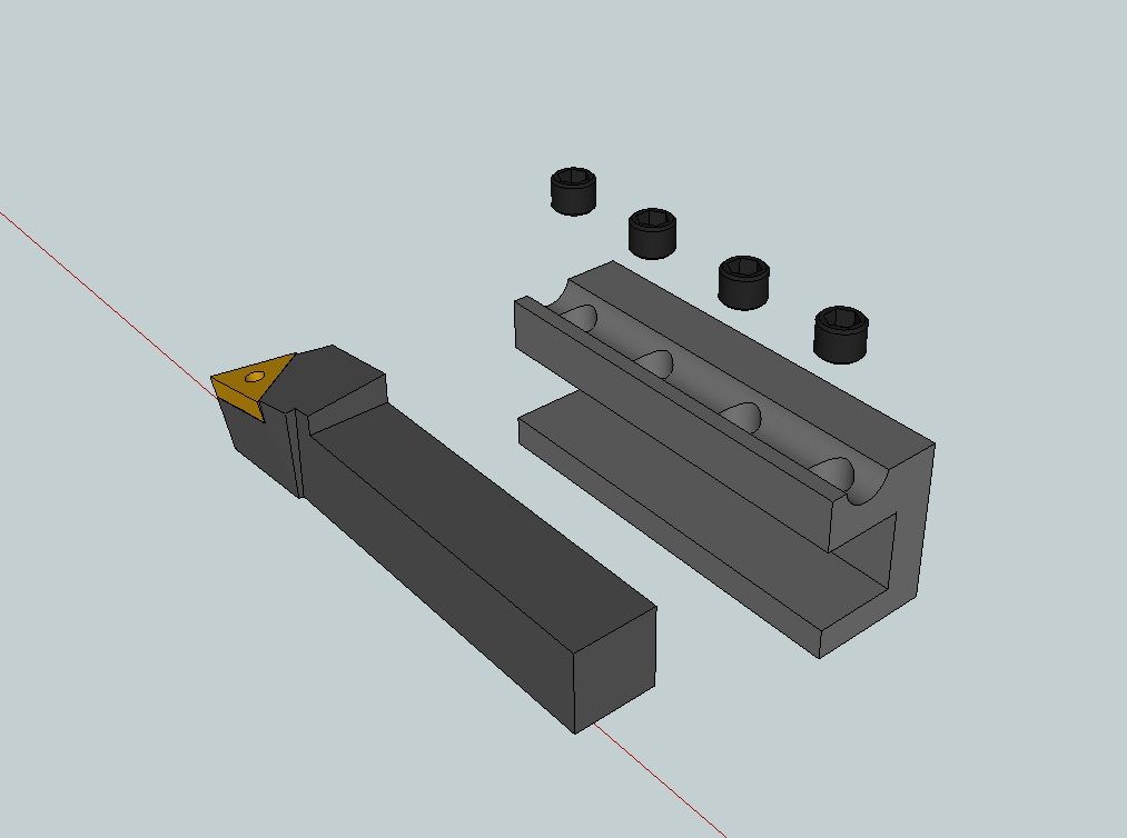

        Exploded view of the tool post. The central stud is 22mm diameter at the base, this is a direct fit to the top slide without any modifications. The top portion of the pin is threaded with a 16mm diameter – not sure of the pitch I'll use for now.

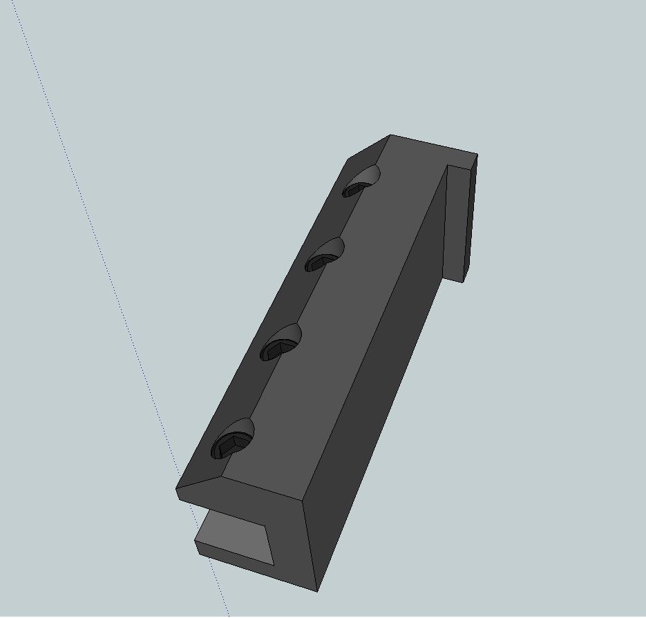

        The tool holder adjustment is not done like the Aloris, Dickson, Norman with set screws. Actually there's no adjustment as the tool holder will be machined to the correct center height straight away. As the tooling is insert tooling the center should be always the same for that particular tool in it's holder.
        I think overall, it's pretty simple to build, and should be similar to the 4 way tool post in rigidity. As for materials to build it from, I'm sot sure. The 2 locating pins will 10mm be silver steel rods, the rest I might use some tool steel ( or maybe I'll start of with mild steel to make life easier!)
        Any thoughts regarding the design and if there's some major flaw which I did not consider?
        Chris
        #426396
          Think I would have some way to index the in/out position of the holder so that if you were doing a batch of items that needed a tool change you could swap holders and be able to use the same handwheel settings rather than have to measure each time a tool is holder is changed. Would also stop the holder being pushed back towards you.
          Maybe move the half round groove towards the middle so you have more thread depth for the grub screws

            Interesting, especially since I currently making a tool system for my little WM180….
            Presumably, when the centre post is released so are th two rods..(?)…this could be inconvenient
            Also, what is the arrangement for adjusting tool height?
            Lastly, what if any, ar the advantages over the 'plain and simple' Norton design?

              Posted by ChrisB on 28/08/2019 18:20:51:
              Hi Bob, well spotted, the rods can either be spot welded to the top plate or with adhesive. It makes no sense having them running around.
              With regards to tool height adjustment, as I mentioned in my original post, I will be using insert tooling. My plan is to make a batch of holders to a standard size, and then machine the bottom surface to obtain the center height for that particular tool. As it's insert tooling once the height is set (by machining the bottom face of the holder) there is no need for further adjustments in the future. This will obviously not work for HSS tooling.
              Not sure what the Norton design is, but if you're refering to the Norman tool post, the tool holders are quite large compared to this, less material required, less machining required, and I think this may be more rigid.
              Posted by JasonB on 28/08/2019 18:39:59:
              Good points Jason, Hadn't thought about indexing the holder, but that's easy fix, can be done. Regarding the round groove, I'm afraid that moving the groove further towards the center of the tool post will make the grip on the holder less effective. I could increase the thickness of the tool holder tho so Icould use longer grub screws. As is the screws are currently M8 x 6mm

                  The four pins won’t all press onto the tool unless the rod deforms substantially. Also I think a key and key way would locate the holder, the key can be a flatted pin.
                  Rather than use two pins why not make the top with two angled faces one acting on the holder and the other on the main body. This will pull the tool holder into the body.

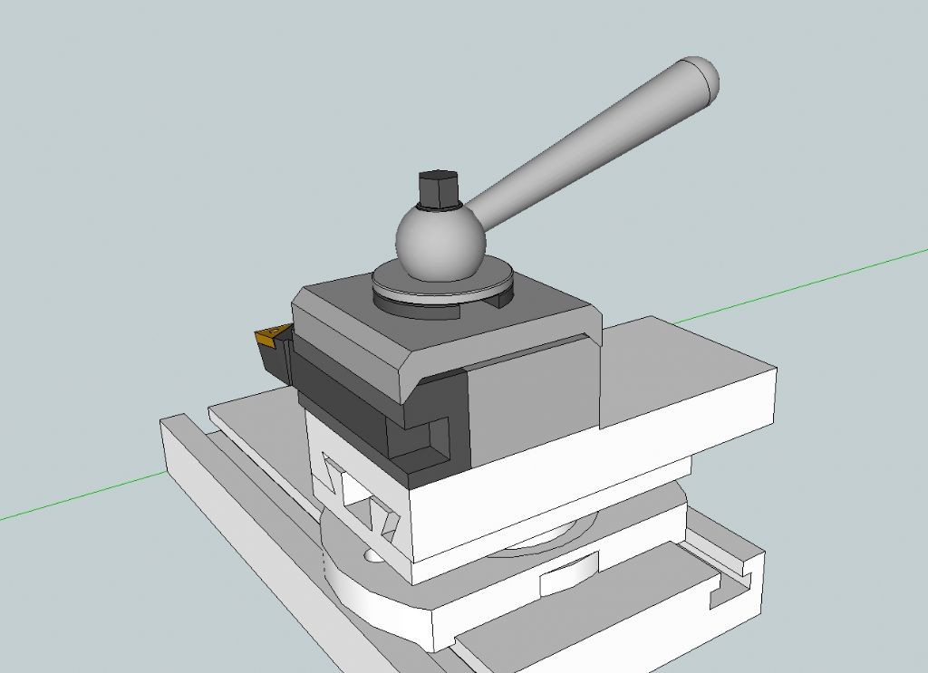

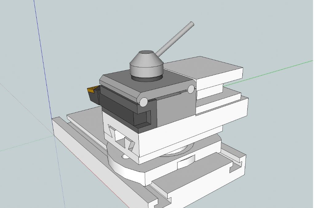

                              So I took some of the suggestions and replaced the round rods with a sort of a V – groove (a half V to be precise). Added an indexing wing at the forward end of the tool holder such that the tool will always go to the same depth. And increased the tool holder height so now I can use m8 x 10mm grub screws. Are M8 excessive? Would M6 be more suitable? Off hand cannot remember what's installed on the 4 way tool post!
                              Here's tool post version 2
                              Tool holder with beveled edge instead of the round groove. Theory is when tightening the top plate the holder should press down and in against the tool post and top slide. The extended part at the forward of the tool holder is the indexing part which will mate against the tool post. Grub screws should not extend beyond the bevel.

                                  Jeff Dayman
                                    @jeffdayman43397
                                    The proposed designs will not restrict the 6 degrees of freedom of the toolholder. You would be wise to do a Google search about restricting the 6 degrees of freedom of any element in a tooling system you do not want to move relative to anything else, and repeatably locate to other things. These things are fundamental to any toolholder, yet many for sale on the market , and many shown in ME and MEW do not achieve it.
                                    Your latest design has a further issue in that the setscrew thread engagement is short, and after some use the top of the thread will likely bulge out into the angled clamping face.

                                      Hi Chris you don't have to have an angle on the rear of the clamp you only need a step and shoulder to bear against which would be simpler to machine and more stable. You don't need such a large angle on the front side of the clamp which would give more thread length to tool clamp grub screws and then you could lessen the amount you unscrew to remove the toolholder in close proximity with job.
                                      David

                                      DC31k
                                        @dc31k
                                        Posted by Jeff Dayman on 29/08/2019 00:14:27:
                                        But in what way is it lacking? The only one I can see is non-repeatability of rotation about the clamping stud. In all other directions it seems OK (if one agrees that it does not need to be restrained from pulling into the workpiece).
                                        To the OP, it may be worth thinking a little of the QC aspect of the design. Right now, to change a tool fast, it has to go towards the centreline of the lathe. This means winding the carriage back past the end of the work or winding the cross slide back to give clearance. If you need to remove the tool (perhaps to measure something) without altering your settings, this may annoy you.

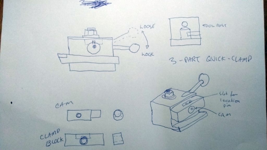

                                            Thoughts…
                                            • No height adjustment.
                                            • Those grub screws will have very little thread engagement and not be long enough to allow for different size tool shanks.
                                            • Unclamping will lose toolpost location.
                                            Sorry to be negative…
                                            Here's an alternative idea, if you don't need height adjustment – why not do away with toolholders, just provide a place for the tool to sit and clamp directly on top of the tool shank?
                                            Basically this with a cam instead of screws?
                                            #426479

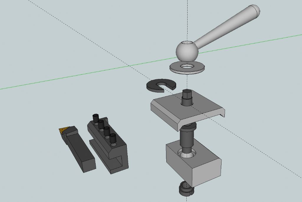

                                                      Wow! Where shall I start from!
                                                      First of all thanks to all who are giving me input – I take everything in, things that I did not foresee or didn't know about and try to improve on the original design, so don't worry I will not get offended or let down by criticism etc.
                                                      I'll try to add most suggestions where practicable but on the other hand as IanT pointed out this will not be a perfect tool post, but it will be good enough for my usage.
                                                      For better tool adjustment I may leave some space in the tool holder for shimming. As a side note, it is surprising how close the insert tips (height) of TN** holder and the GTN parting tool, are.
                                                      So to Version 3!
                                                      I reduced the width of the angles on the top plate and tool holder as suggested by David George. Doing this also freed up space for the tool holder grub screws which now have 14mm thread depth.
                                                      I also introduced a 5mm thick C-washer under the retaining nut – the purpose of this washer is to be able to remove the tool holder sideways rather than forwards (as pointed out by DC31k. This is done by releasing the top retaining nut and pulling the C-washer out. The top plate will then have enough upward travel to be able to retrieve the tool holder from the side without moving the crosslide or rotating the tool post
                                                      Another remark by Neil was the inability of the tool post to retain it's position when changing tool holders – I have modified the design of the central pillar bolt, and the tool post to achieve this. I have introduced an M16 nut under the top slide face – the centre bolt will be threaded on to this nut. The centre bolt is flanged which will mate to the tool post (which now has a counter bore to accept the flange on the centre bolt). The centre bolt top is finished in a hex shape – when this is tightened the tool post will be clamped to the top slide (but not the top plate) The top plate is tightened in turn by an m16 clamping handle – this will in turn clamp the tool holder down.
                                                      It's difficult to explain with words, and my drawings can be misleading – this is how the above mods should look like.
