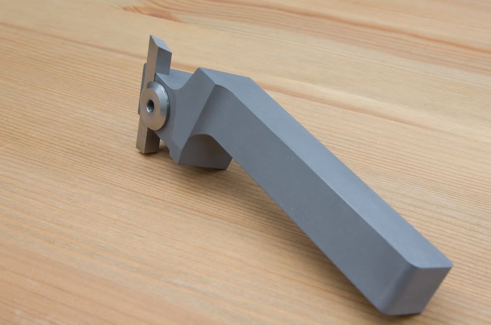

          This is the one I made about ten years ago.

            Thats a work of art for sure.
            something puzzles me here the tool doesnt seem to have any clearance angle either for side or centre feed, not like a convention horizontal tool for the same duty. its supposed to stop the tool edge rubbing against the work, pls advise
            maybe the phto isnt clear
            I think someone mentioned drgs
            Edited By brian jones 11 on 12/07/2021 21:47:12
            Edited By brian jones 11 on 12/07/2021 21:49:18

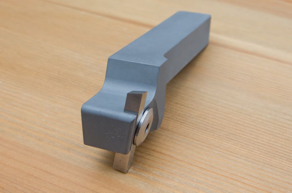

              Does this help?

                Yes that helps to get my head around the 3d geometry
                Notice how the clamp nut is not sitting square on the tool piece, needs a little land there on the other side to bring it level – in this CNC world? Those carbide holders within microns
                I am knocking up a 3d model to understand the concept better – purely jpgs no dimensions – not wishing to plagiarise, that compound angle on the top face is the secret and you would definitely need a purpose made grinding jig to maintain accuracy. Only one face to grind!
                but its a fascinating concept, I never heard of it before but £130 for the full English – I havent got my regular tooling working properly yet

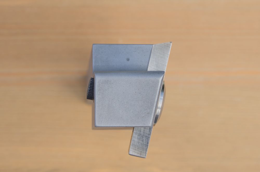

                  A couple more. People have asked in the past about interrupted cuts and whether the cutter moves – no, I’ve not had this happen so far.

                    Vic:
                    What is that beautiful finish?
                    #554002
                    Vic
                      @vic
                      Posted by ega on 13/07/2021 11:06:49:
                      Vic:
                      Ha ha, lots of folks ask that! smiley It’s just sand blasted then waxed to stop it rusting. I use the same finish sometimes on most metals including Alloy, Steel, Brass and Titanium.

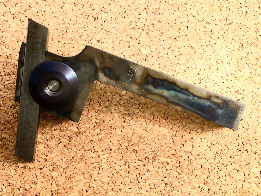

                                My contribution as well — I "borrowed" Vic's design — one of the nicest I have seen and made this a couple of years back – have a sketch somewhere !!!!

                                  Very nice John. I like the finish, one of my scribing blocks has that. What do they call it?

                                      Posted by Vic on 14/07/2021 10:41:27:
                                      Hi Vic, "colour case hardening" its case hardening using bone charcoal, to achieve the finish the case is not very thick but enough to be wear resistant — been practising and the tool was a prime candidate !
                                      #554056
                                      Kiwi Bloke
                                        @kiwibloke62605
                                        The mottled colouring is the result of uneven cooling of the case at the quenching stage – for dramatic results, quench in water which has air bubbling through it. Otherwise, you get a dull, fairly uniform grey. Popular technique in the gun trade.
