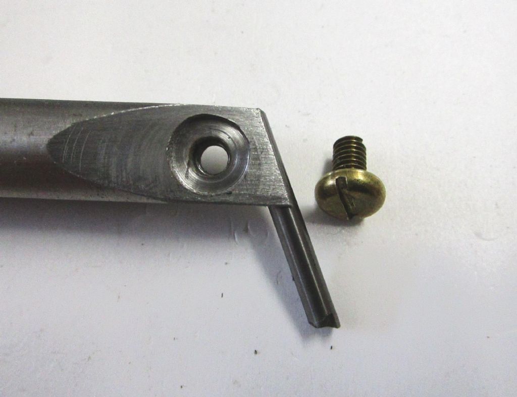

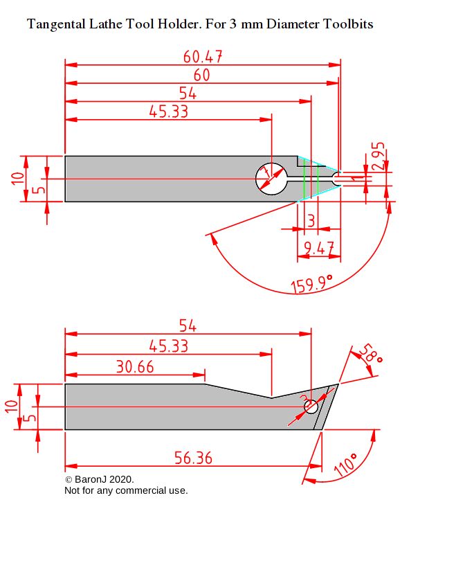

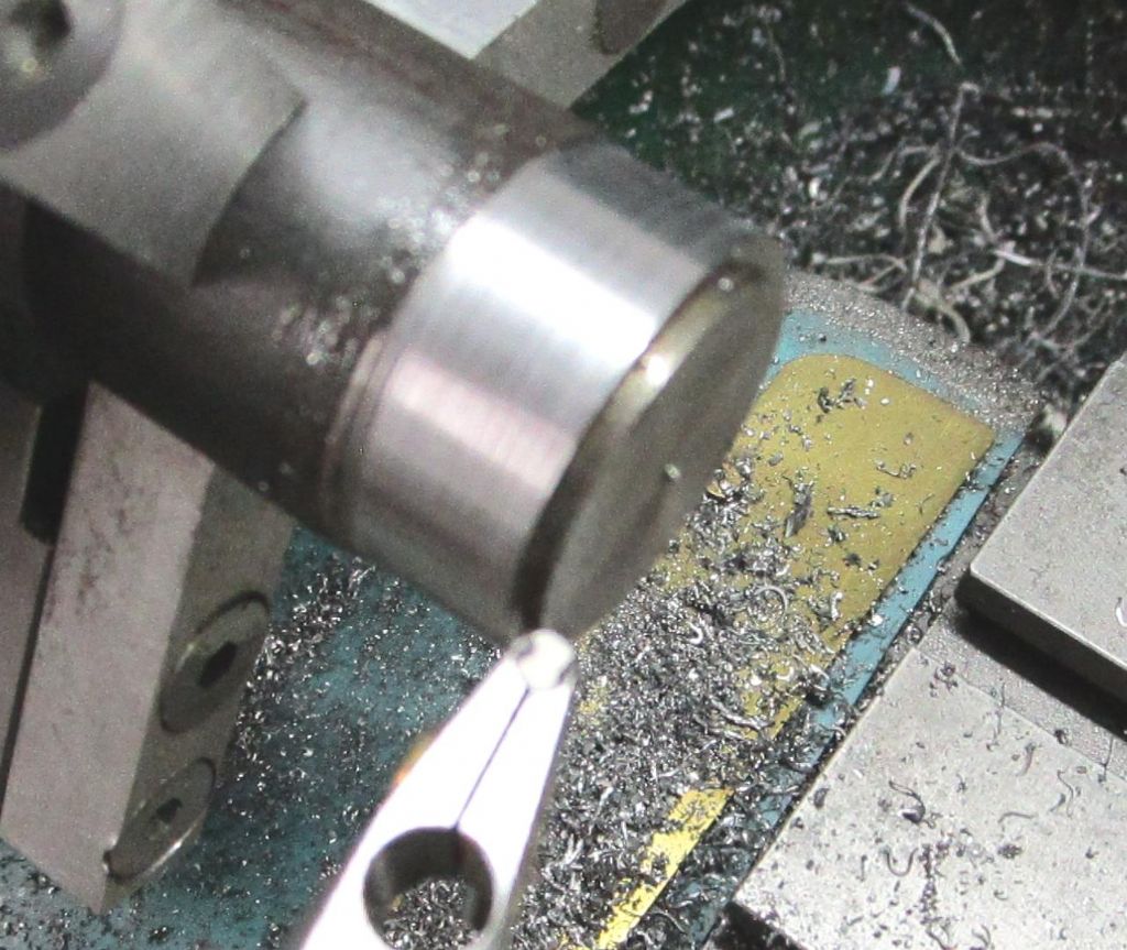

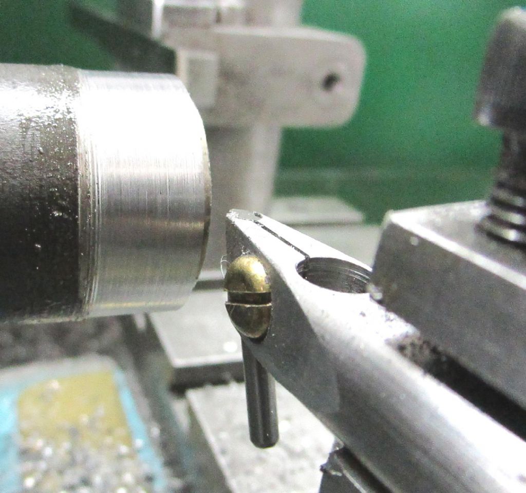

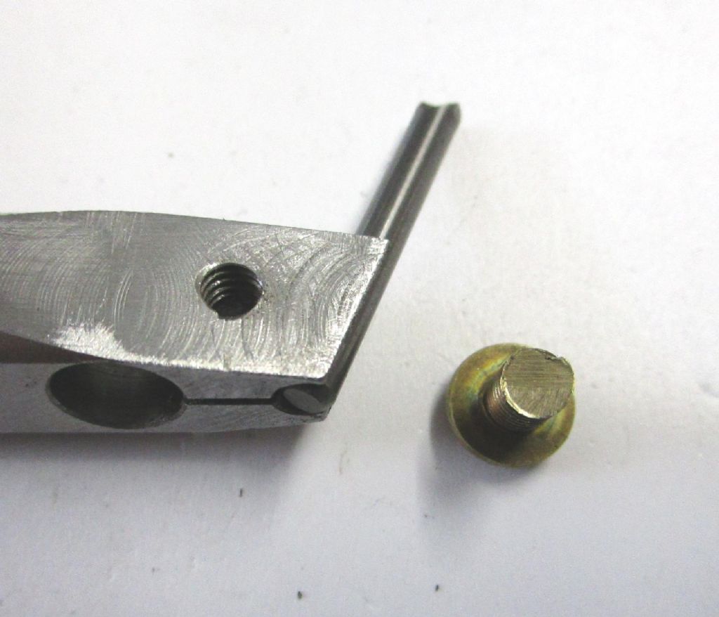

                                                    John Baron
                                                      @johnbaron31275
                                                      Hi Guys,
                                                      I agree with the comments that Tangential lathe tools are quite easy to male and use. I made one quite a while ago.
                                                      Easy to set up and easy to sharpen. You get a good finish too.
                                                      This is a drawing of one that I made. Just scale to suit whatever HSS or carbide you want to use.
                                                      As you can see the finish is not too bad.
                                                      Certainly better than my photography smile
