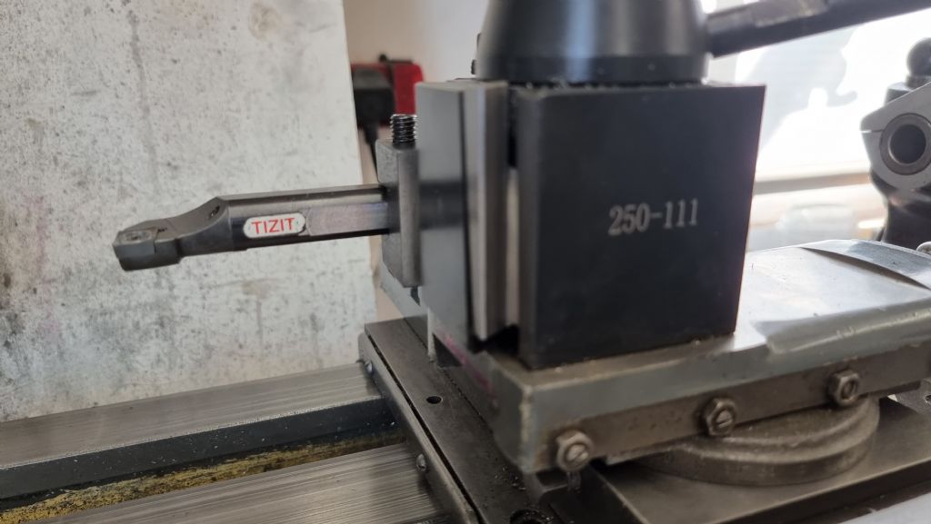

                      I think my little 8 1/2” x 14” is meant to take 10 or maybe 12mm tooling? I bought a 16mm TNMG holder and trimmed a couple of mm off the bottom and it works well. The holder is quite tough but it wasn’t too much trouble to trim it down with a carbide mill.

                            Posted by Vic on 08/07/2021 23:17:07:
                            wow that looks like the dogs………… ca $10 on Ali
                            looks like you would use that with a standard myford clamp
                            https://www.myford.co.uk/acatalog/TOOL-CLAMP–74-1409-1-1278.html
                            I'll go and check tool height and revert

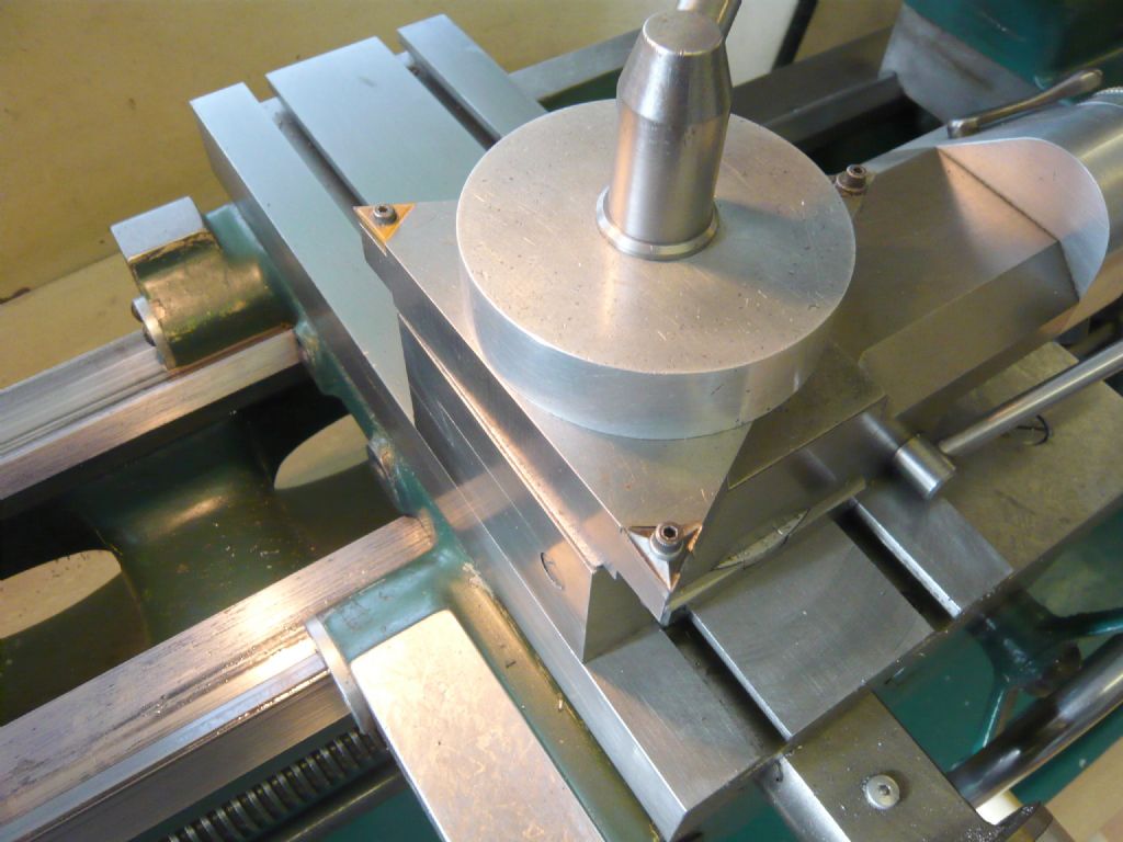

                                MLA version QCTP with no overhang
                                Alan
                                #553384
                                  Alan, unless I'm missing something the holder still has no direct line of support under the tool and is over hanging from the toolpost which is the "disadvantage" people are talking about

                                        Alan Jackson
                                          @alanjackson47790
                                          Posted by JasonB on 09/07/2021 11:22:31:
                                          Jason, You are quite correct but the cutting tool does not reach (cantilever) beyond the lower support so there is no moment created to make the topslide tend to flex or pivot. If I need a more solid toolpost I use a four way or triangular toolpost.

                                            brian jones 11
                                              @brianjones11
                                              that looks very solid to me, and simple. These triangle tips have a lot going for them

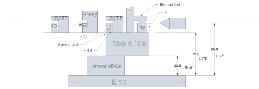

                                                    heres my take on the tool height dilemma
                                                    hope it make sense – for illustration only as you must check your own dimensions
                                                    so with the desirable and plentiful 12mm holder you can
                                                    a) skim 2mm off the holder base (or part skim as suggested leaving a step on the overhang)
                                                    b) Skim the top of the topslide – but then the 4 way block will be wrong and you will need shims for a 5/16" hss
                                                    c) Make up a 4mm shim piece to fit under the holder and use the elephants foot
                                                    d) buy a new chinese machine and stop dickering around
                                                    What do you think
                                                    Obtw I have made the assumption that a 12mm holder will also mean the height of the tool tip – is this always right?
                                                    Another member mentioned the use a  16mm holder and doing some skimming to make it fit.  According to my estimate it should fit as is under an elephant foot see below – pls advise as I dont have one of these yet and I was thinking of getting a set with  triangle pieces (in fact it was steviegtr as above)

                                                      Personally am averse to making any irreversible changes to the machine, so would advocate milling the underside of oversize tool shanks.. (But not enough to weaken them seriously. 2 mm off a 12 mm will not be as weakening as 2 mm off a 8 mm shank.
                                                      Stiffness is BD^3 / 12 , so keep D as large as possible in the interests of rigidity.
                                                      One or two tool shanks have been reduced in depth, but leaving the area immediately near the carbide tip at full section, for that reason..
