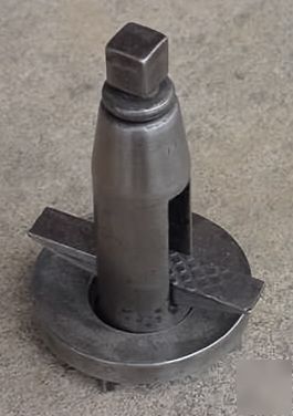

                        A real mans tool post Rocker or Lantern? Did Myford ever have one of these?

                          The early Myford rear tool post employed the rocker principle.
                          AFAIK, they never offered a lantern front tool post – best left to vintage American machines.

                                  Posted by brian jones 11 on 07/07/2021 17:08:49:
                                  good thinking
                                  Edited By brian jones 11 on 07/07/2021 17:19:56
                                  With those all you need to do is change the base for a flat ring to give you centre height on your insert tool and you'll never have to check insert centre height ever again even if you swap from straight to left or right handed holder in the set.
                                  The boat or rocker requires constant checking every time you move it.
                                  If you use Armstrong holders the same applies for HSS till you sharpen them.
                                  Sometimes the old junk is better than the new junk, depending on how much outlay you have invested in the new junk

                                    Give me a proper 4 way toolpost every time. (These earlier things were the best that they could manage at the time )
                                    Boat / Rocker posts don't keep the rake angle constant as centre height is maintained.
