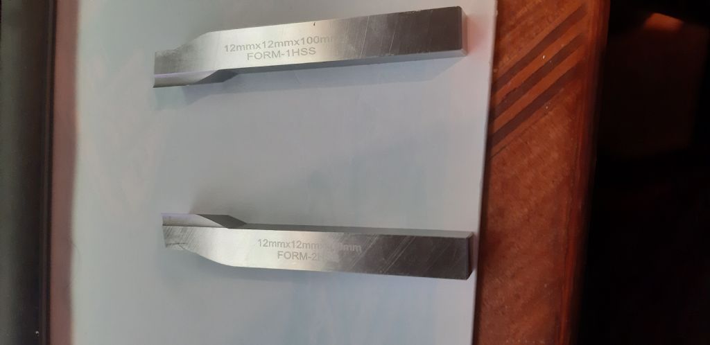

        Ive just got my first set of hss lathe tools and have a couple of very noddy questions.

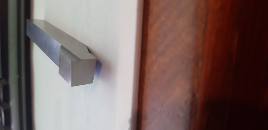

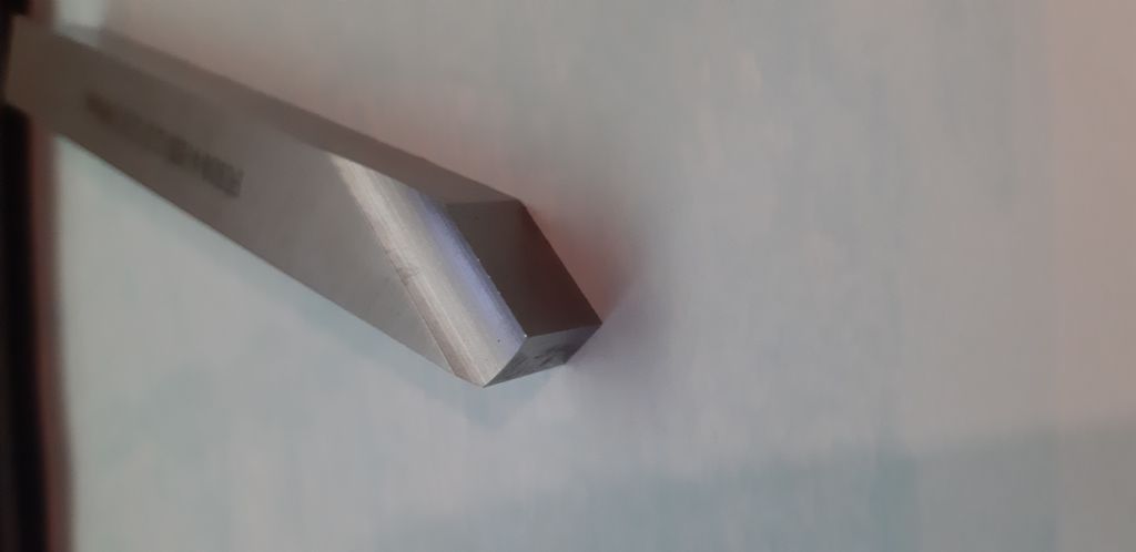

        It comes with a right and left handed turning tools. They have a groove ground into them. When mounting the tool does they groove go on the top or leading face? It looks, to me, like they would cut in either orientation. Photos below:
        And what is this for?
        Thanks
        Colin
        #567120
        Tony Pratt 1
          @tonypratt1
          Groove to the top, bottom tool is for chamfering.
          Tony
          #567121
          David George 1
            @davidgeorge1
            Hi Colin the groove is on the top of the tool on all three tools. I use this style on softer materials aluminium or EN1A steel for instance to get a good finnish and the third style I would use that as a roughing out tool for the same as the top groove acts as a chip breaker as well.

                Might be wrong but I've always assumed the groove to be a chip-breaker. It's purpose is to snap the long spirals of swarf that otherwise get entangled or form clumps. Chips are easier to clear than spirals.
                A swarf ball catapulted by the chuck once hit me hard enough in the face to draw blood. Since then I wear eye protection and clear swarf before it builds up.

                  Just back from trying out my new lathe tools. The turning tools in my first picture are ground to a sharp point. Can I put a bit of a round nose on it or does the chipbreaker groove mean this isnt sensible.

                      Hi Colin don't try and put a radius on the cutters with the chip breaker as they will rub and you can't get center height correct. Just grind off the end of the tool and a rub with a sharpening stone on the cutting edge. I use the corner of a grinding wheel along the groove and sometimes use a small diamiter grinding point in a dremmel to smooth it out. Don't use on brass, bronze, cast iron or similar materials as they will grab and chatter.

                          These look remarkably like tools that I bought from our favourite Leicester based supplier and come as a set in a neat wooden box.
                          When I attempted to use this knife tool I got a lovely finish when facing, but an appalling one when turning along the axis. Contrary to the advice above, I found that very slightly rounding the business end of the tool produced a near-miraculous improvement in finish.

                            If a tool is to cut properly, it needs to be mounted so that the cutting edge is on centre height.
                            A slight radius on the cutting edge will improve surface finish, but must extend down the edge to ensure that only the point contacts the work, to prevent the lower part of the tool rubbing.
                            With regard to describing the hand of the tool, when the tool is mounted, if the edge points towards the chuck, to cut, it is a Right Hand Tool A Left hand Tool faces towards the Tailstock.
