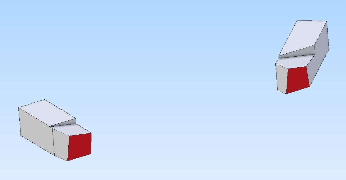

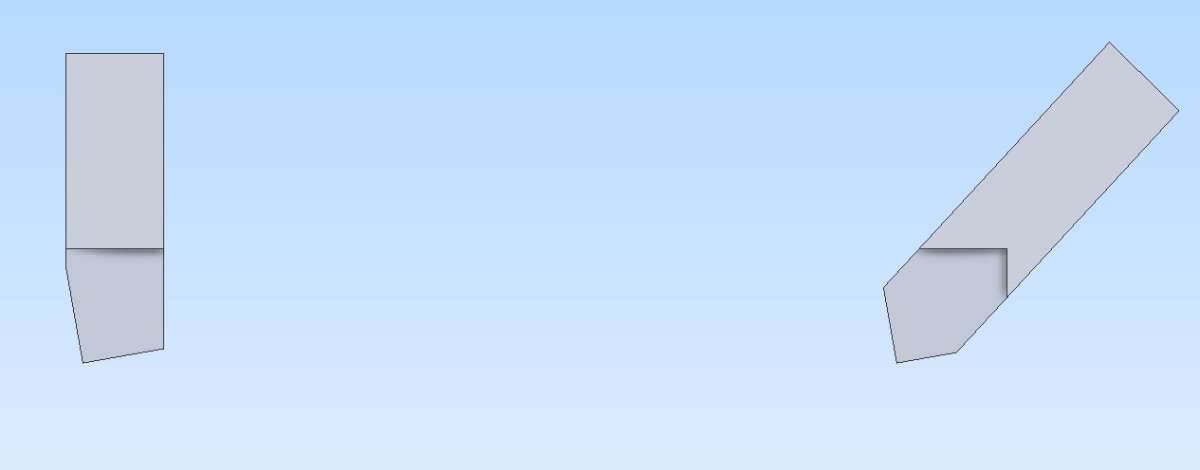

                  I am trying to find details on the tool geometry and shape for boring iron cylinders.  Does anyone have a picture of the tool that would fit into a between centres boring bar that is drilled to hold the tool at 45 degrees to the bar?  I am using a 1/4 inch circular HSS blank in a 3/4 silver steel bar and I need to bore the liner to 7/8 inch by 4 inches deep.
                  I have tried doing it on the lathe with the liner in the chuck but my boring bar is causing chatter and resonance with a dreadful finish.  I thought that a between centres bar would cure this but as I say I’m finding it hard to visualize the tool shape.
                  There also doesn’t seem to be many videos on youtube about tool shape either so at the moment I’m a bit stuffed.
                  I hope you guys can help.
                  Thanks
                  #694938
                    I think all my videos and photos show the cutting tool at right angles the bar but it makes no real difference to the bit that does the cutting , just adjust for the 45deg. I think I have one ground for 45deg in the workshop will take a photo a bit later.
                    Sketch shows the similar geometry for both mounting angles.
                    left has 10 deg and 10 deg so the cutting corner is 90deg, Right has 55 and and 35deg so again cutting corner is 90deg. 10deg top rake and whatever you need to stop it rubbing in the hole on the red edge.

                      That’s great thanks.  I’ll grind one up on Sunday and give it a go.  I am guessing that twisting the tool in the hole a little would put some rake on the cutting edge but it would probably also lift it above centre.
