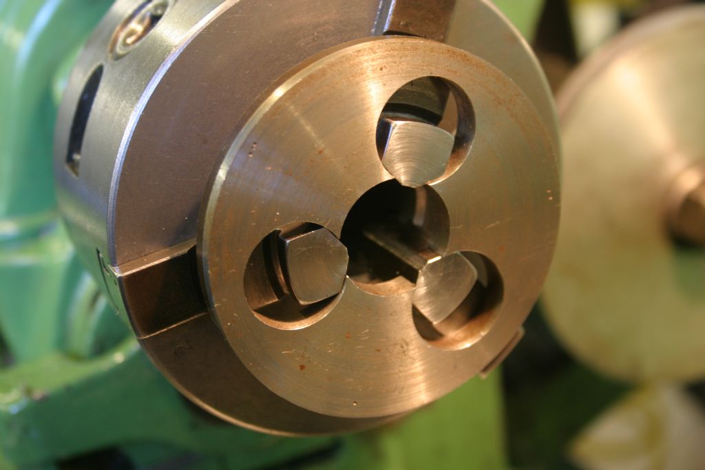

To digress: I bought an old Griptru chuck – something of a mistake because when I tested the chuck the inside jaws were completely useless. The outside jaws (and therefore the rest of the chuck) appear to be fine and hold true, but the inside jaws were so worn they weren't even gripping at the tips and you could see daylight at the ends

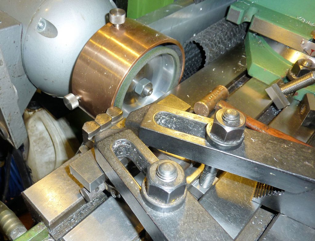

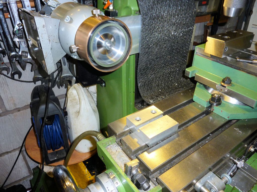

OK, accepting the jaws were toast (I will have to look out for a replacement set) I set about trying to figure a way of re-grinding them, and my thoughts turned to the diamond cupwheel mounted on the mill. I checked the squareness of the wheel off against the mill table and as far as I could tell it was nicely orthogonal – although it's difficult to be certain because the face of the diamond wheel is not a smooth machined surface. Nevertheless an 8" square placed against the front edge revealed no errors. Good enough for an experiment then.
I clamped the 3 jaws together and used a parallel to hold them in line, and two clamps to hold the lot down onto the mill table. The 8" square was used again to align them all with the rear edge of the table and overhanging a little.
I could only comfortably take 1/2 thou off each pass – the cup wheels are a bit fragile and I didn't want to break it. Grinding continued until the front of the jaws all looked the same, but by then I realised something wasn't right…
