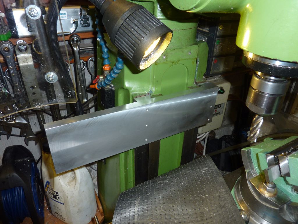

It would have been possible perhaps Ian, and a welded steel angle bracket might have worked. There were quite a few options but the solution I went for is as compact as possible, and it's very stable – but far from the easiest to make… I hate doing things the easy way (joke).

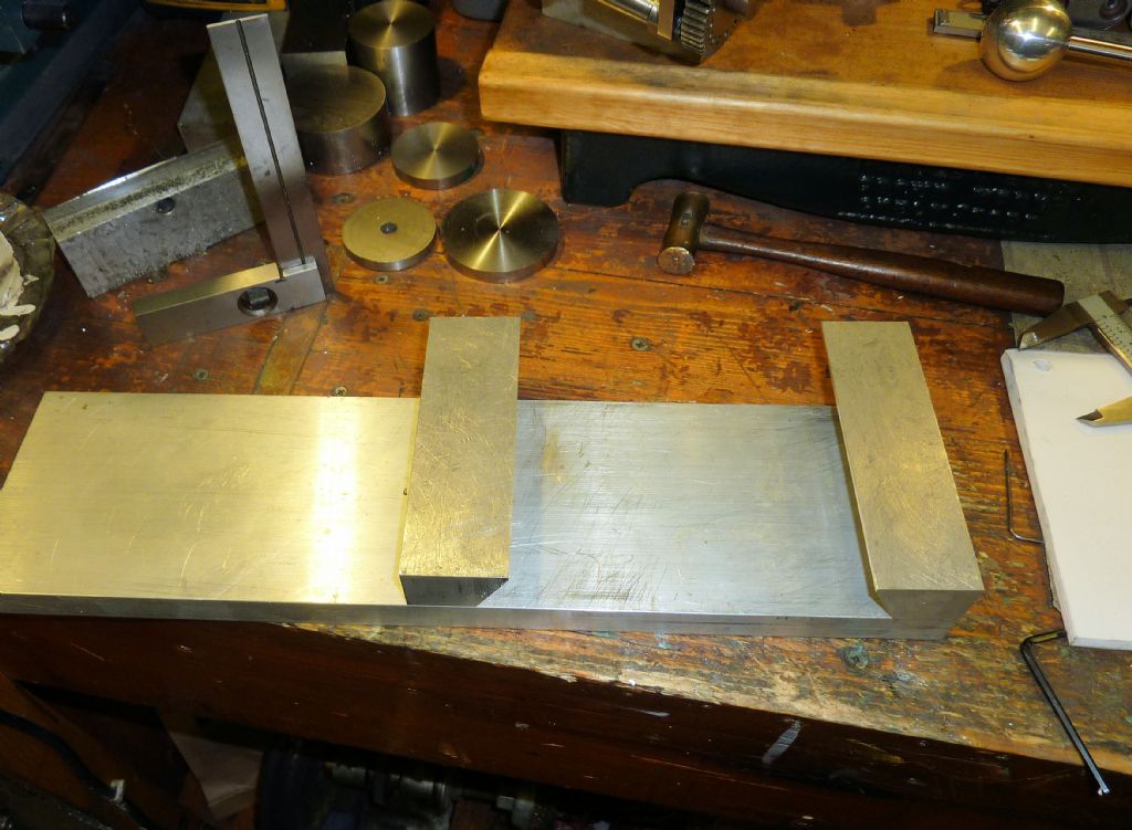

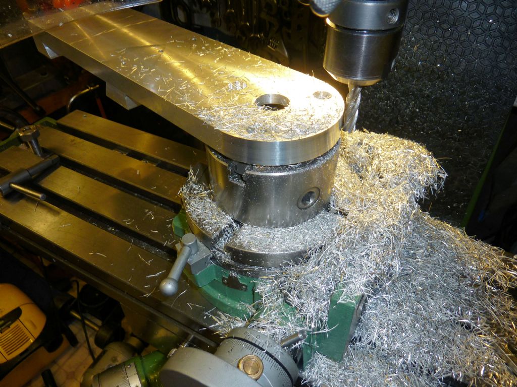

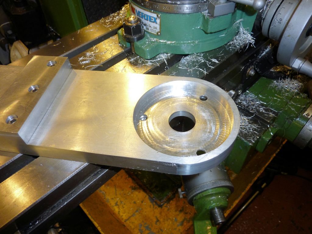

So, with the motor and flange turned to size I next looked at the plate and how to mount them. By the way – I should have known better but… when I machined the flange I made it a very close fit on the turned part of the motor casing, I intended to use Loctite 638 as the main method of holding it in place. So I take the freshly machined flange off the lathe and test fit it on the motor. Of course, it was aluminium, and it was fairly warm, and the motor was cold… you can guess what happened next. Push the flange on and it cooled quickly giving me a nice shrink-fit. Bit of a pig to get it off again. Moral: cool it down first then test for fit.

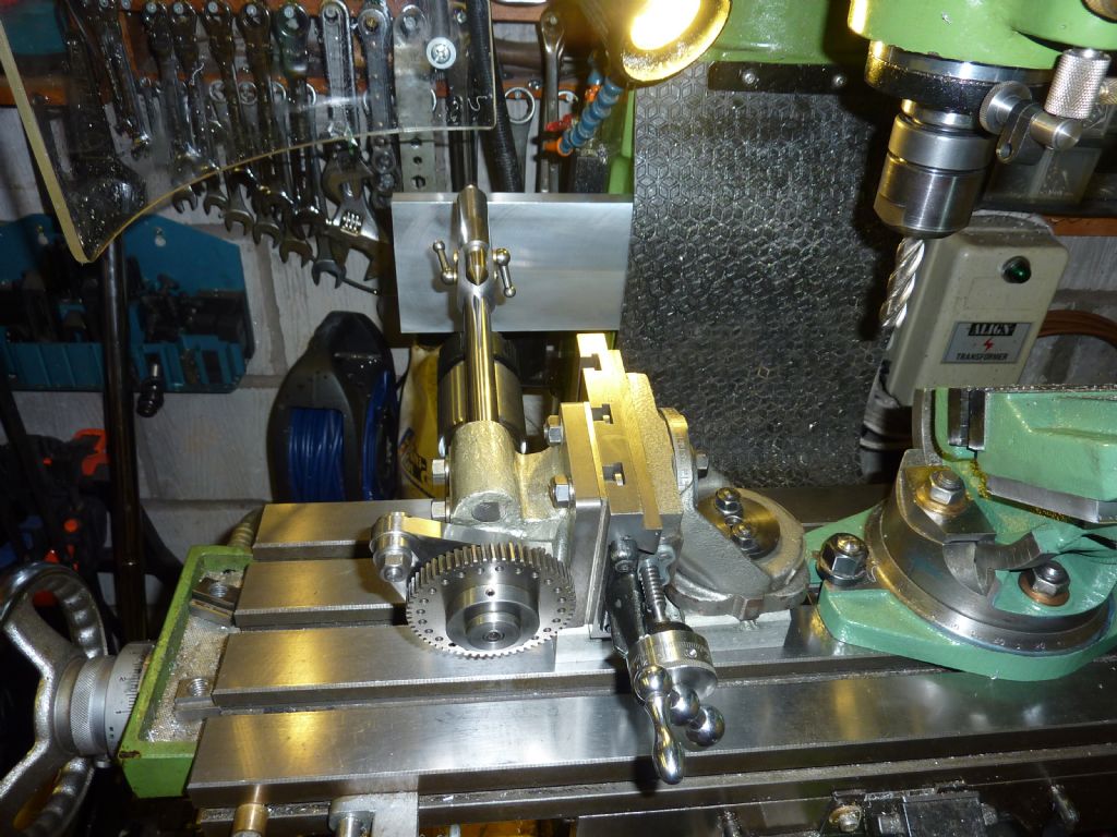

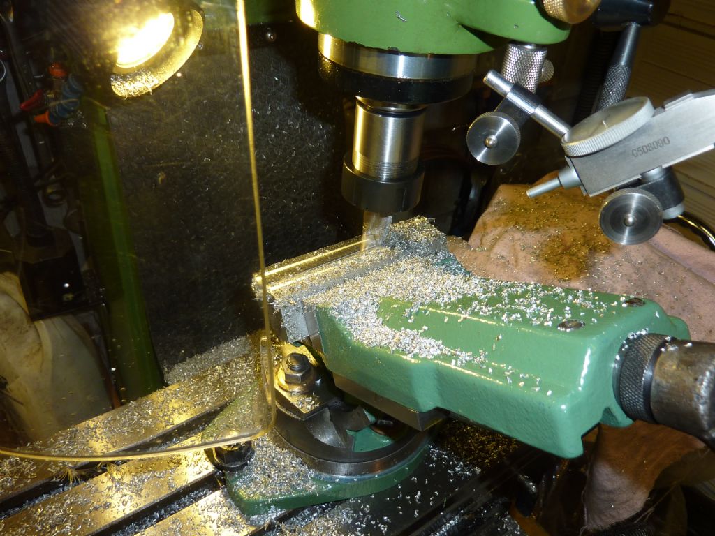

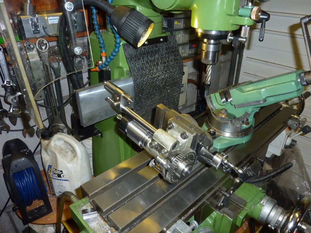

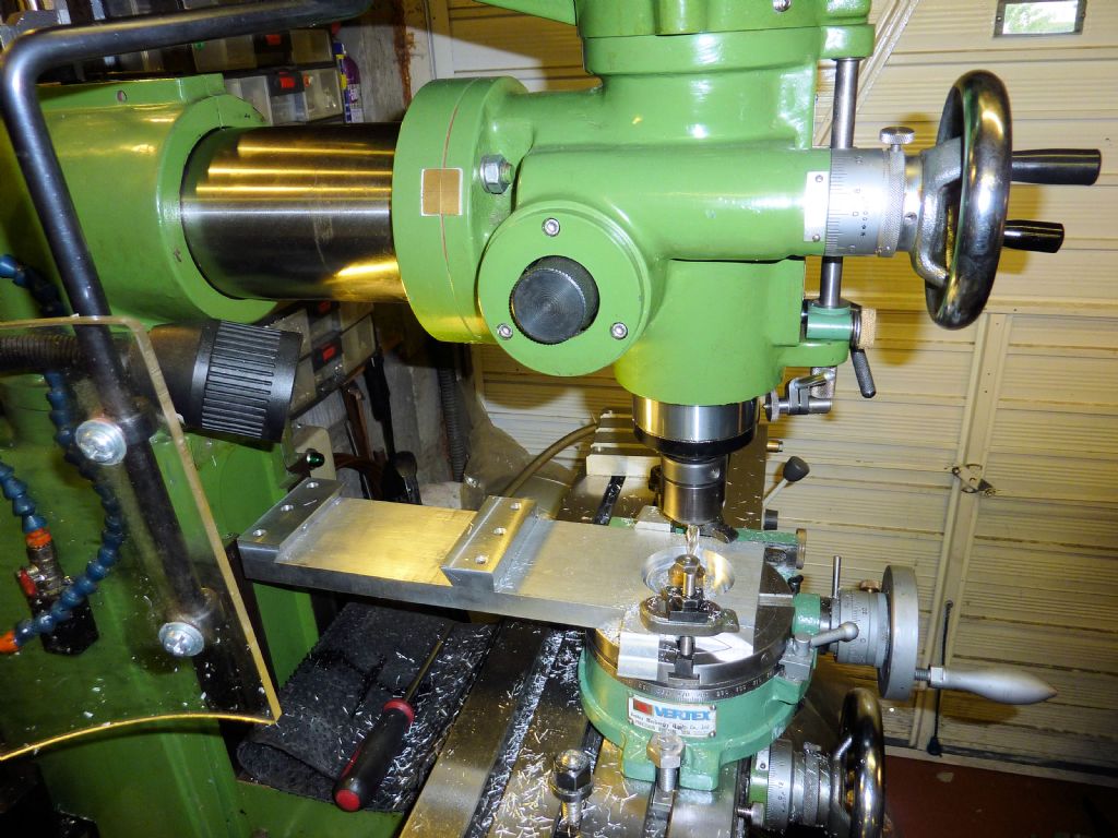

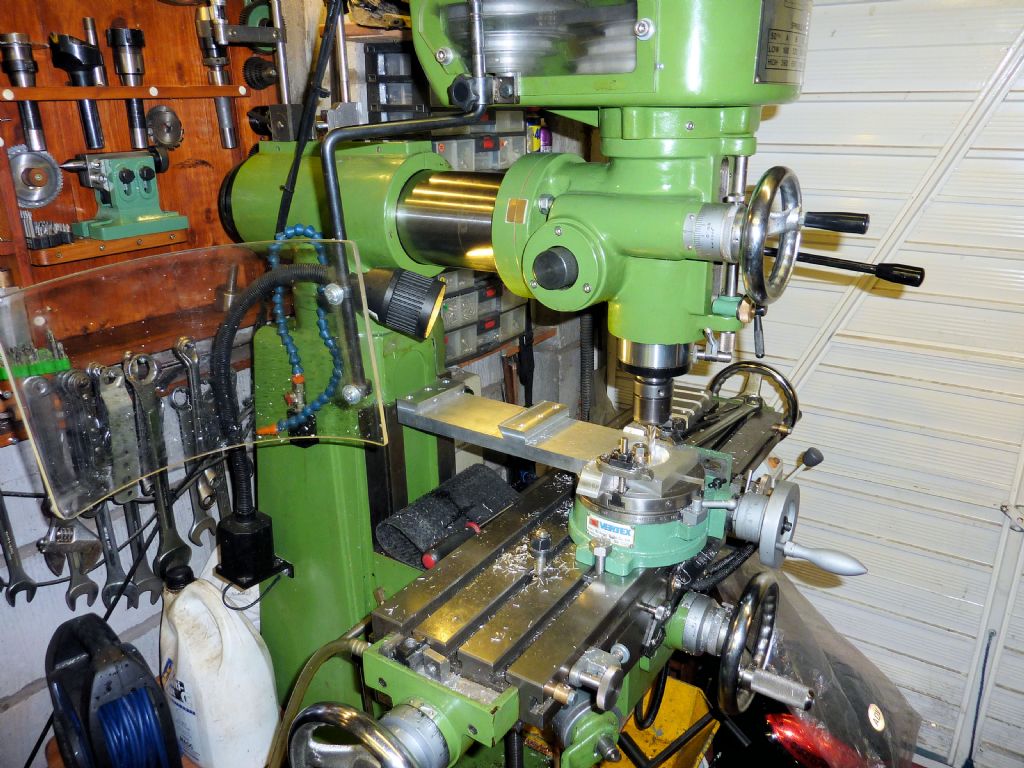

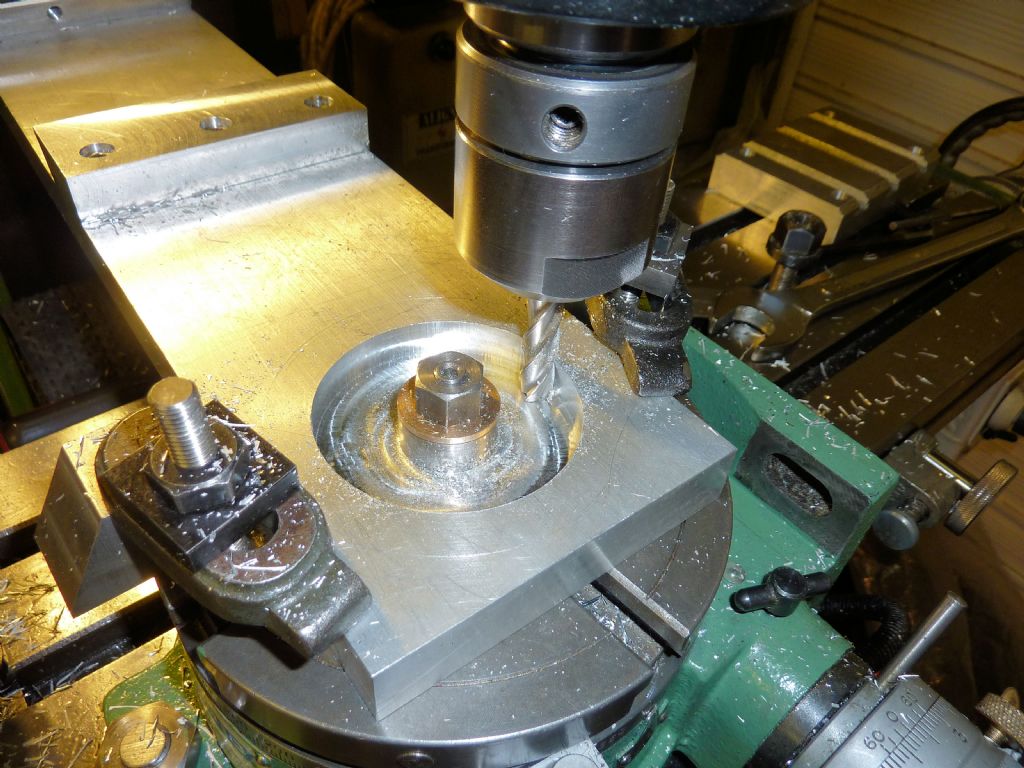

Anyway, I wanted to bore a recess in the back of the plate for the flange, and 3 bolts through the plate into the flange to hold it in place. I scratch my head trying to figure out how to do this. My boring head doesn't have the capacity (and it's manual not automatic so many stops and starts would have been required to use it). The plate was quite long too – far to big to fit in the lathe. Eventually I thought of attaching it to my rotating table on the the mill bed, and because it is a Turret Mill I could pull the head forwards and that gave me just enough clearance for the thing to rotate fully. The recess could then be cut with an endmill.
Setup for machining the recess in the rear of the plate:
Turret head is pulled out almost to its fullest extent:
I spend the next hour being a human CNC miller, I sure wish I had a real CNC machine…

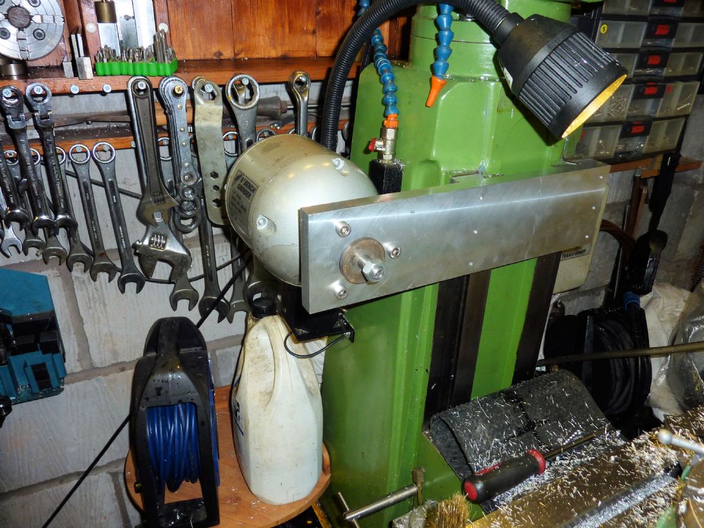

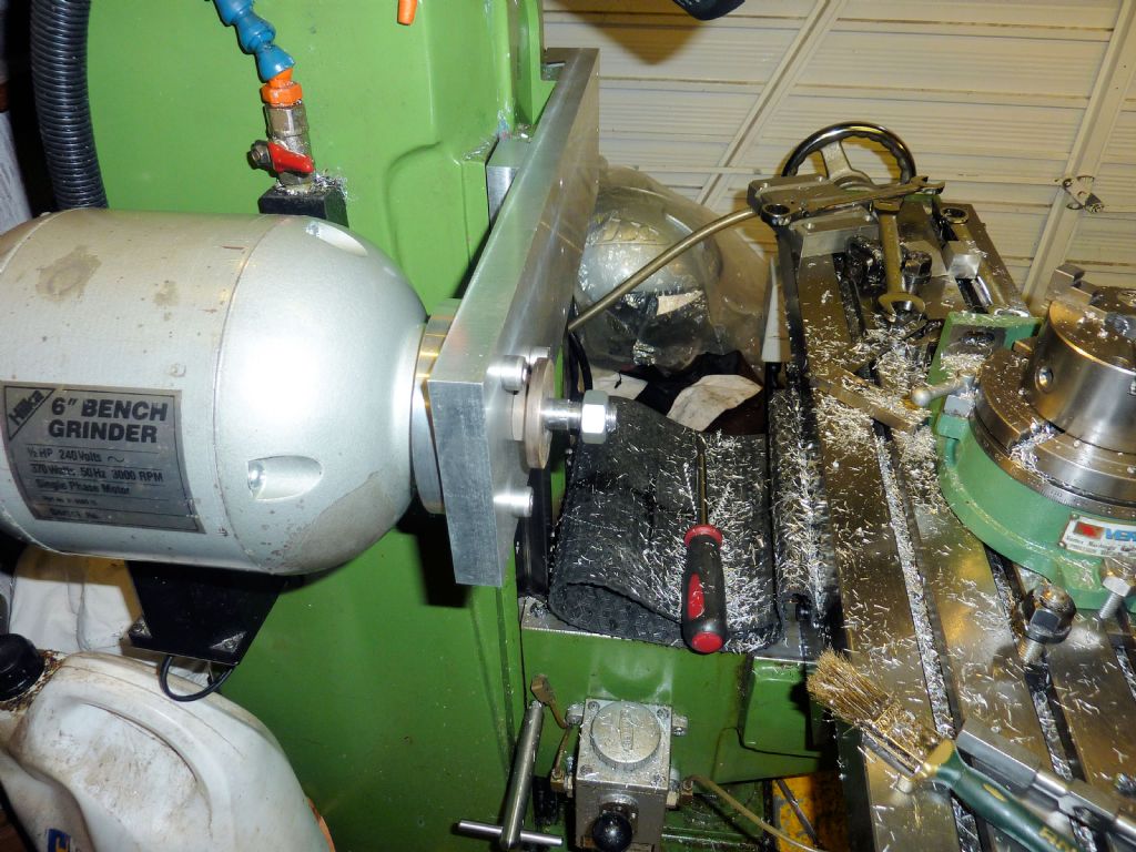

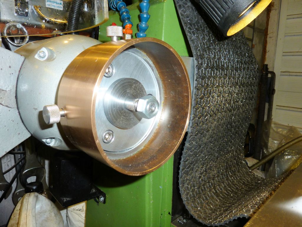

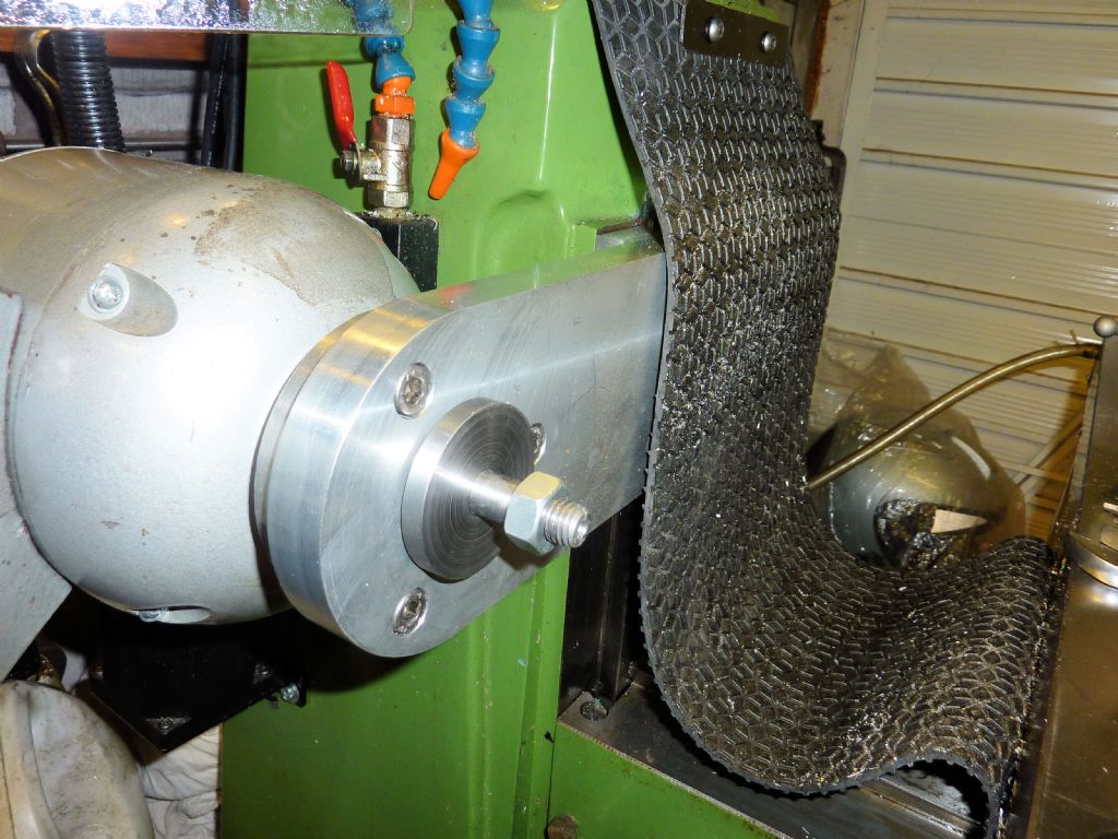

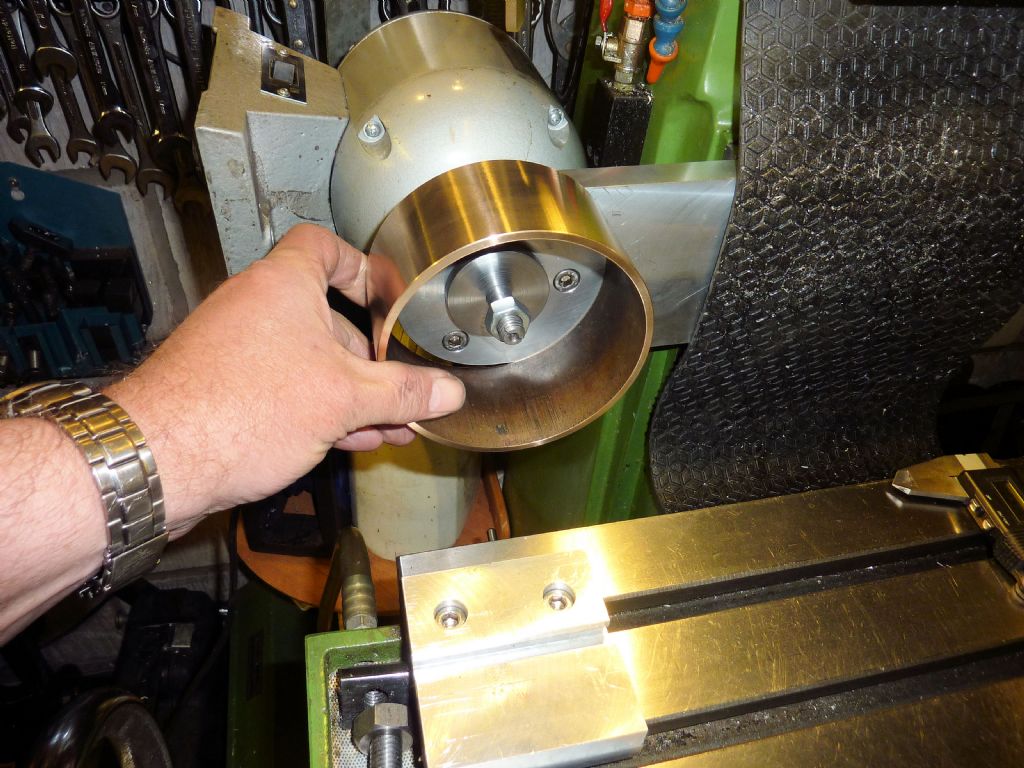

So there we are; motor is held very securely in place
I think I will change the cap-head 8mm bolts for some countersunk ones, then everything will be flush.
Now I need a diamond cup wheel and I'll need to make a protective shield. I also need a new bench grinder…
I was looking for an excuse to upgrade to an 8" grinder anyway.
