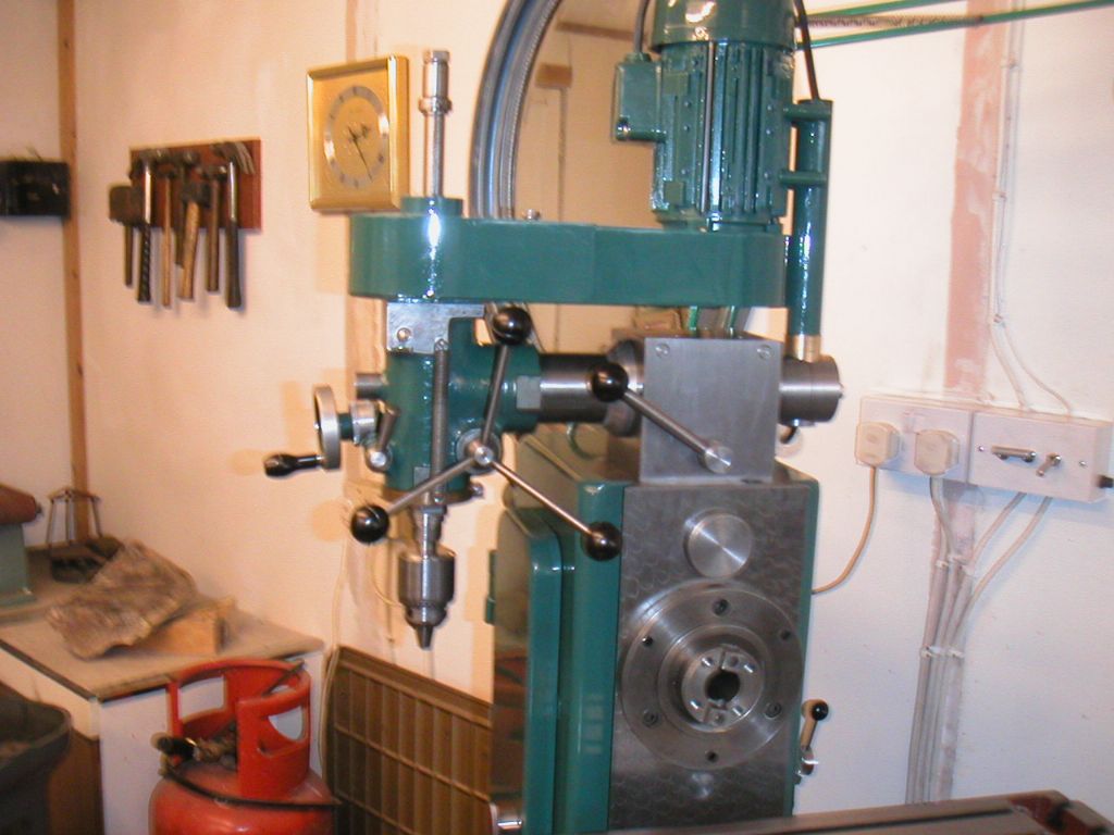

      Hi I am fond on the Tom Senior m1 but mine only came with the knuckle head, and though it works fine, it has limited clearance in use,I have seen bport milling heads grafted on, or the actual senior main column raised upwards, and various other ideas such as the Bartlett milling head which mounts on arbor support ( which is just not accurate enough due to droop!) nor has it a quill feed…
      I only do light work but need more clearance so any ideas appreciated! Has anyone tried these far east milling spindles? Senior heads are rarer than hens teeth, some people just buy a machine for one!
      The top of m1 is not machined? So any mounting on top is a bit hit or miss! I am not moving another mill ! Which would be the best solution….
      Any ideas appreciated! Or what you have done!
      thanks vic

            Alan Jackson
              @alanjackson47790
              I fitted a Dore Westbury head on my Tom Senior M1. It was covered in an article in MEW a while ago. It works very well and has lots of daylight.
              Alan

                The top of my M1 was machined and square to the vee slides.
                Alan

                      I did spend some time when I first got the machines. I stripped them down to basic parts and I think I spent some time cleaning them up. I do use them though they are not just like that all the time, and the photos were taken after a good clean up. I know what you mean about the dull brown look, but I love the look of these great british machines.

                        Hi Alan and Buffer, thanks for the great ideas! Alan great work ! Lovely Design idea, I shall track down the mew issue! Your swivel head design is most useful feature as well. Thanks for sharing the idea.

                                      Hi everyone , and thankyou for the useful suggestions! The overarm mounting is not a route I would go having tried that wth the Bartlett head idea, when mounted on the arm droop is present! Centec mk2 head looked possible, just the drive motor issues and mounts; even a cl500clarke mill head… as mounted ontop of the M1 machine column.
                                      Alan Jacksons work and solutions is outstanding; , and thank him for the pictures here and The mew article I now have!
