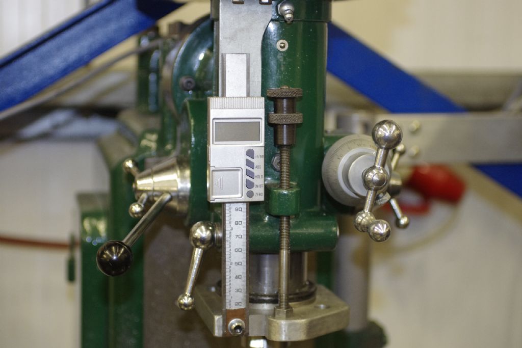

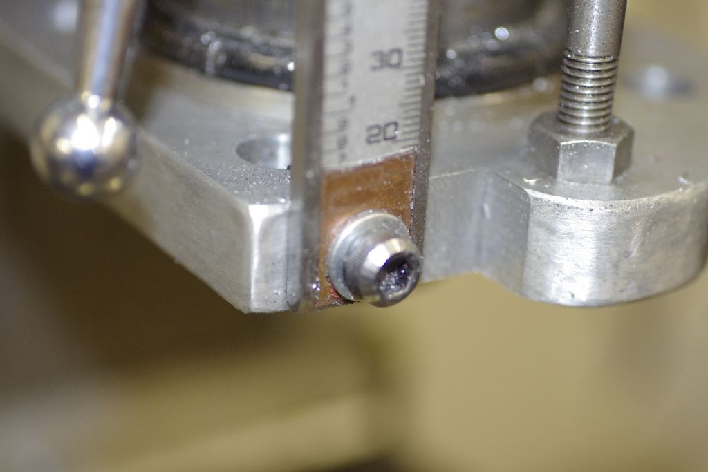

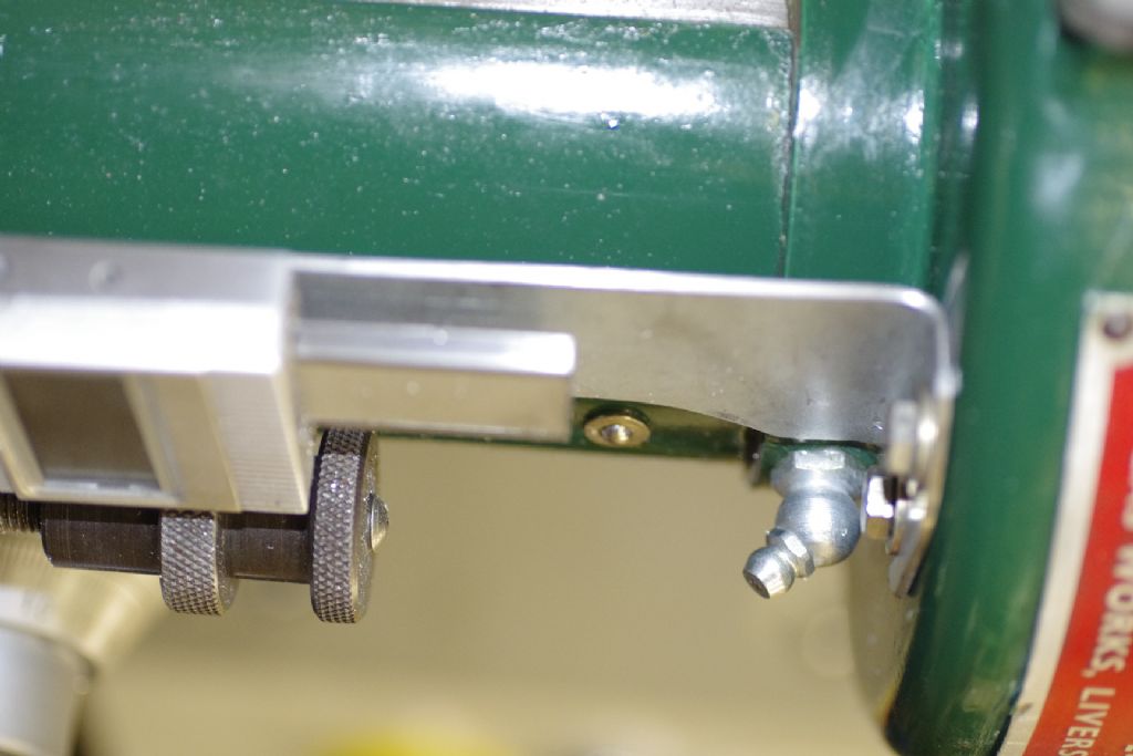

                          _igp2854.jpg_igp2853.jpgI noticed in your video that you were still thinking about a digital readout on the quill. The cheap and cheerful ones like I have on the museum's drill mill and TS vary in width, and the one I bought for the TS light vertical was too wide to fit without getting in the way of the quill lock. I was lucky to find that the one I had fitted to the drill mill was smaller. If you are thinking of getting one, the 40mm wide type can be fitted without too much difficulty, but the 48mm one was fitted to the drill mill which has more room.

                            Thanks for those pics Old mart. I have actually started making it now. On the right hand side. The one i bought is the 8" with the remote readout. I know there is only 4" of quill travel , but i got the extra length for mounting reasons.
                            Shame i had not seen your pics earlier. I would probably have done it differently.
