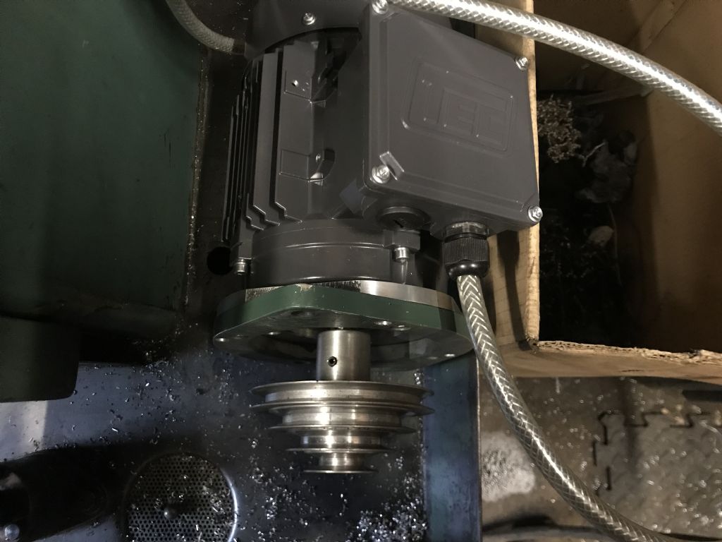

          I fitted a three phase 0.55kW flange mounted TEC motor to my 1976 light vertical and it fitted perfectly without any alteration.
          #626140
          Frank Gorse
            @frankgorse
            I fitted a motor/inverter package to my S type. (Newton Tesla,very happy,usual disclaimer) Had to open up the recess in the mounting plate a bit but it was easily done on the Myford faceplate,soft ally and no special accuracy required. Also needed to elongate the screwholes a bit,easier if you have access to another milling machine.

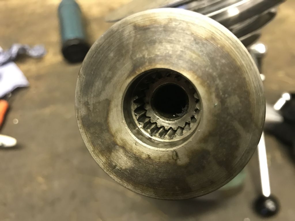

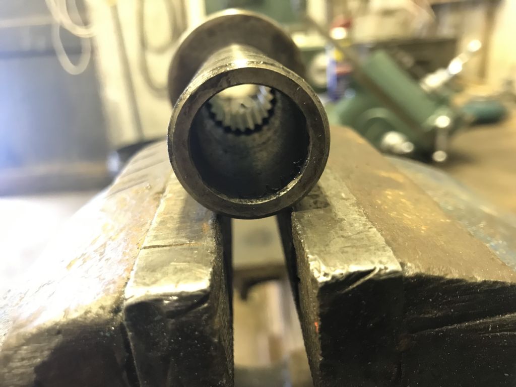

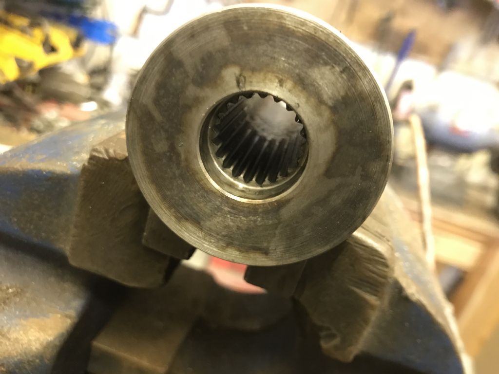

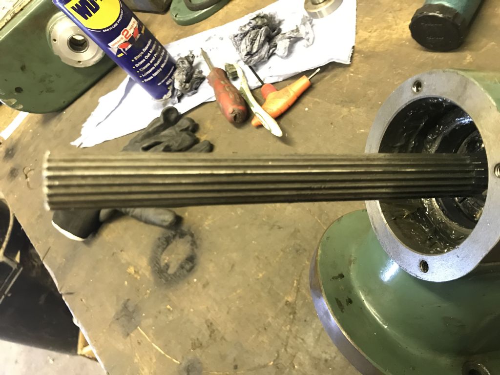

                                    Right, I’ve finally fitted a 1 hp TEC motor with B14 mount on ally adapter flange as per the advice above. Cheers for that.
                                    With the head stripped down, it appears that the play is indeed between the splined parts. The only slight ray of hope is that it’s similar all the way along the length, even the bit right at the top, suggesting that if I replaced the female part, that would make a big difference. I think the mill’s been used primarily as a drilling machine, given the awful state of the vice, which would have evened out the wear in the male splines,
                                    Is there someone out there who could make a new female drive part? I could probably turn the round aspects, leaving just the splines to cut, or even fit a splined repair insert.
                                    Since there’s no play anywhere else, I’m inclined to stop the stripdown there and reassemble with some new grease.

                                        The female part would be hardest to make, unfortunately, I was going to make a splined shaft, but ended up using the original top attached to the R8 bottom. I will find the drawing and show it to you, maybe somebody on the forum might be able to cut the splines for you.
