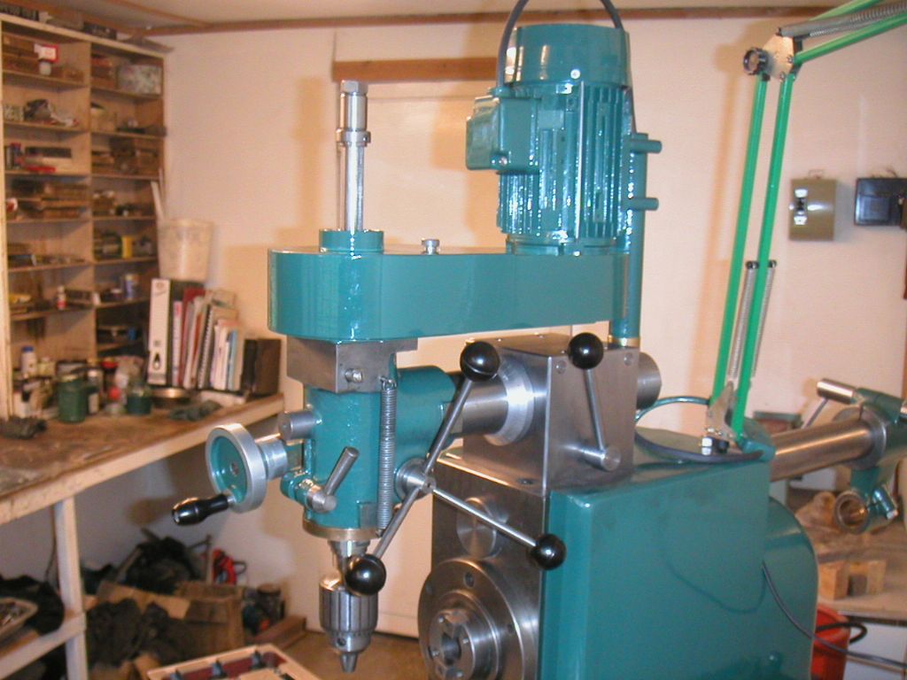

        Posted by Alan Jackson on 02/09/2016 09:56:08:
        A while ago I fixed up my M1. I did not have a vertical head so I added a Dore Westbury head. This gives plenty of daylight.
        Alan
        Thanks for posting Alan. It looks a very useful and well done addition.
