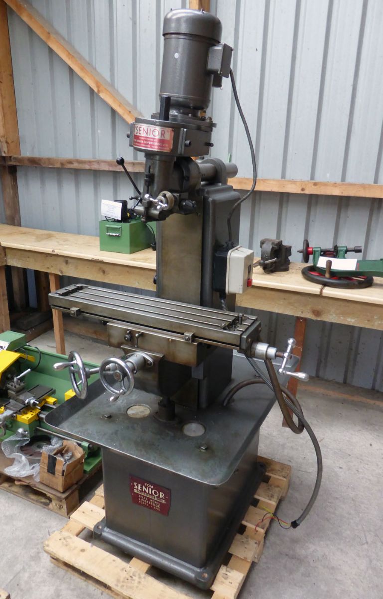

            Bit more cleaning today guys . Managed to strip back the suds tray.
            Is it supposed to have the large square hole at the rear. I know the small screw holes shouldn't be there and I was thinking of having them welded and ground back. Just wasn't sure about the square hole as the diagrams don't show the tray?
            #252165
            damian
              @damiannoble34800
              Hi all,
              The suds tray has had the small screw holes tigged up and have now been dressed back. A little filler and the tray can now be painted.
              I was going to initially use UPOL acid etch #8 as I've seen this done on another forum when restoring machinery but there are others and paragon paints sell various self thinned ones which will work out cheaper. Any other suggestions would be welcome though. I have access to a small compressor and spraying equipment so I intend to spray it up in the original colour enamel which apparently can be sprayed direct to bare metal although I have always used a primer.
              I think a few on the forums have bought from here.
              **LINK**
              The interior of the column and base I will go for the off white colour enamel again from paragon
              **LINK**
              I have already started to strip the S type head down to sand blast the parts for paint. I will then check everything before re-assembly.
              Cheers for reading and any help guys

                    This morning I stripped the S type head so I could paint the housing.
                    The whole assembly came apart quite easily but I left the clarkson autolock chuck in. I'd slackened off the draw bar and gave it a tap (as I've done on other machines) but the MT2 seems to be stuck in? Daft question but am I doing this wrong guys I've left it overnight until some penetrating oil seeps through. I thought I'd check back before damaging anything.
                    With it all stripped it was into the glass bead blaster, protecting the various orifices that hold the quill etc. It is only very gentle unlike the shot blaster that I used on the column door.
                    The results on the head below
                    I also did the end plates from the table screw
                    With a bit more cleaning and refining to do it will be a while before it is paint stage.
                    Damian

                                          Over the last couple of days I have cleaned up the door which is now ready for a coat of paint.
                                          Also the head casting as much as I could smoothing out the majority of the rough parts so I could use the bare minimum of body filler.
                                          One side was a little rougher than the other but all is smooth and ready for the paint. I have also been working on the base, suds tray and the column but with these being larger and a lot rougher in places I've had the angle grinder out to smooth off the worst bits.
                                          More work over the next few days and I've got to order the paint. Standard colour enamel and then white/off white for the inside.
                                          I'm really looking forward to the spraying as it will mean I'm moving on and can at least get some of the large bits assembled. Need to also order some anti vibration levelling feet.
                                          More soon
