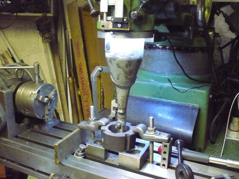

                                                  John Stevenson 1
                                                    @johnstevenson1
                                                    OK fellow bodgers.
                                                    Last one for a bit as got to nip over to China and show them how to bodge properly.

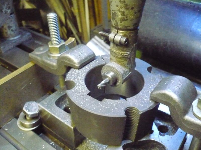

                                                    Got a taper lock coupling in for modification. It's off a big compressor out on site and the coupling has all broken up and really old style so they ordered a new coupling to fit the motor. Typical off the shelf 80mm bore taperlock.
                                                    They came to fit it and it's too loose and the keyway is wrong. Turns out that at some stage it's happened before and someone has turned the rotor down from 80mm to 78 to clean up and opened the keyway out from 22 to 23.
                                                    No way are they going to pull this rotor out off site to build back up to standard when noting else is wrong with it so it's mod the taper lock. 78 into 80 won't go so cheat and but a 75mm bore taper lock and open up to 78.
                                                    That's the easy bit.
                                                    23mm keyway is definitely non standard and no one lists a broach and if they did £300 for one keyway is a bit OTT.
                                                    Now we can make a tool and slot it or bodge even further and mill the slot out.
                                                    Mill an internal keyway with square corners I hear you ask ?
                                                    Well go on – ask.
                                                    Ok..
                                                    Bridgy Quillmaster head with right angle attachment.
                                                    Close up.
                                                    Bridgeport has some stupid shank fitting like 7/32" diameter but I have bored mine out to 6mm so it now uses standard FC3 throw away cutters.
                                                    Result, about 15 minutes to set up and then opened out very accurately because you can use the DRO, in another couple of minutes.
                                                    Also works on large internal splines.
                                                    Keep bodging until I get back.
