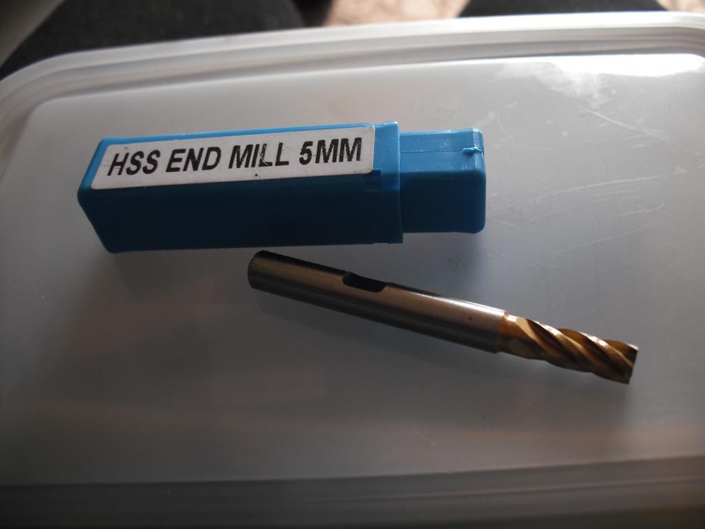

      If the usual way of using these is to cut using the flutes(i.e. on the side), why are they called "End Mills"

                          old mart
                            @oldmart
                            The photo does not show the end of the cutter to determine whether it is end cutting or not. The way to tell is that an ordinary non end cutting mill has a central plain portion, probably with a centre hole in it. An end cutting mill has one flute extending right to the centreline so that it can plunge, which can be useful for counterbores, or to then move sideways. The end of the hole produced by any end cutting mill or slot drill is slightly conical, shallower in the centre, which does not matter most of the time, but is a factor to be remembered.
