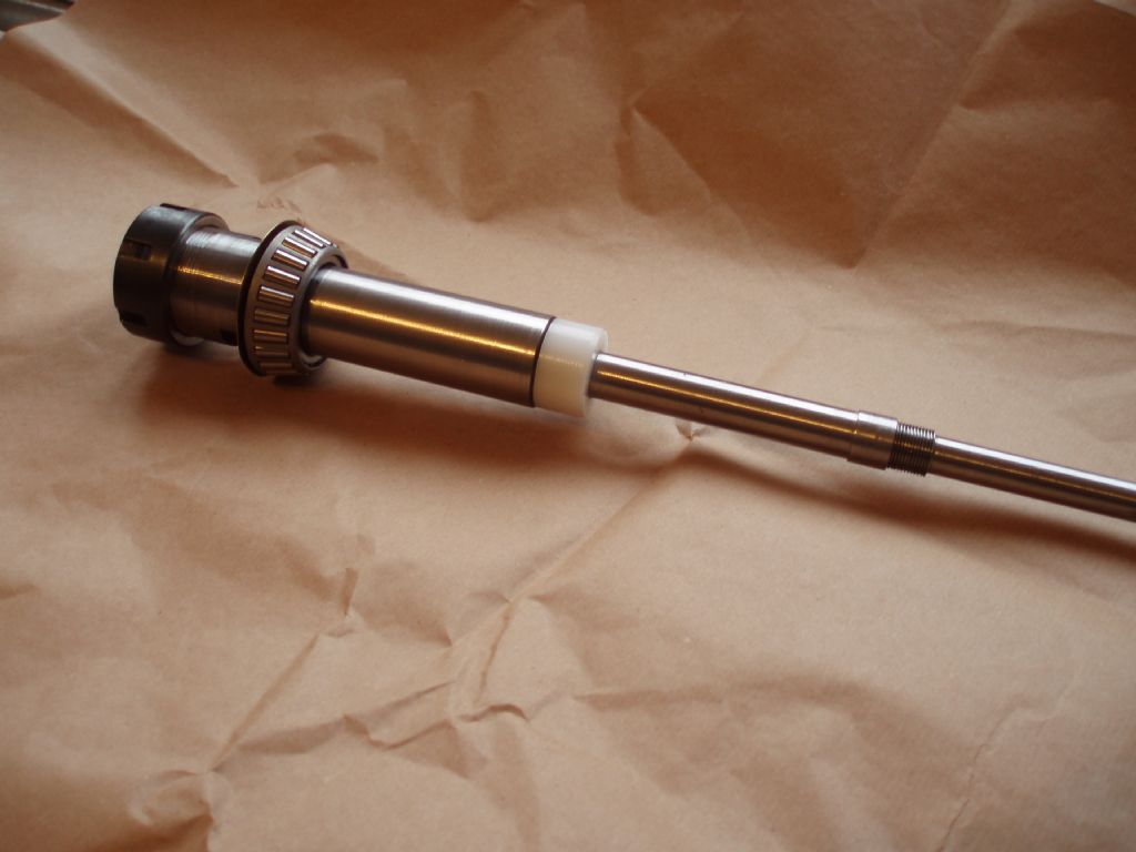

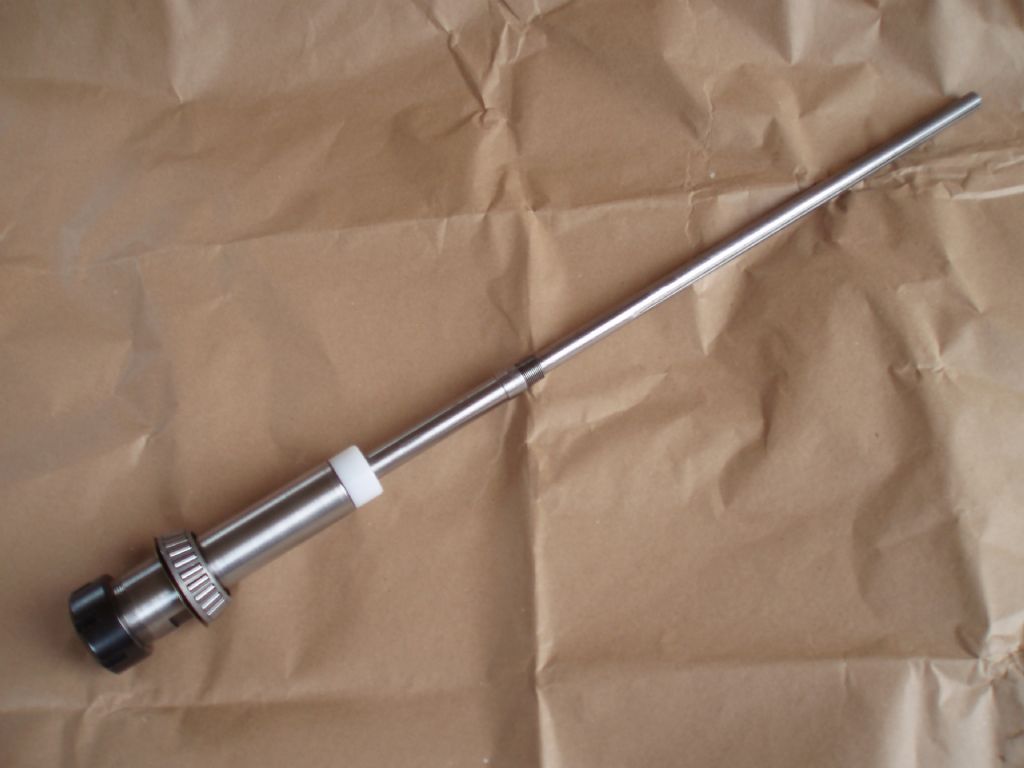

I have decided to go belt and braces anyway. If the spindle were to come to a sudden stop through some unforeseen circumstance (finger trouble) there just may be a remote chance of the joint failing or weakening to let go on some future occasion. To avoid weakening the spindle by drilling through and pinning, I am going with radial grub screws into dimples in the shaft.
As an aside, I am also wary of the claim to be "resistant to lubricants". I machined a tight-fitting nylon cover to fit over the top of the joint as can be seen in the accompanying photos.
