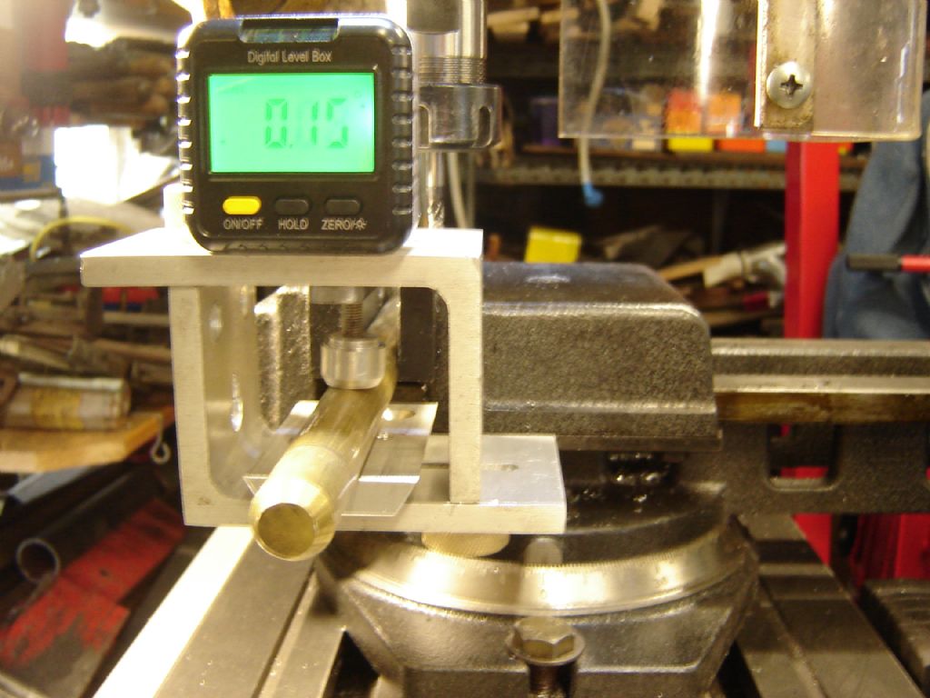

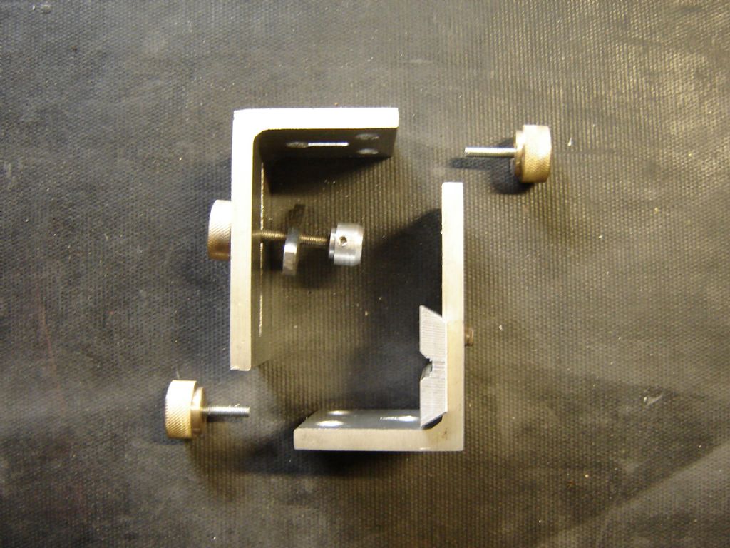

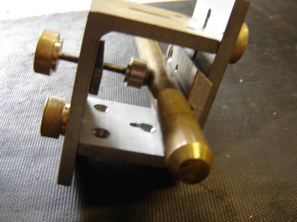

        dsc01495.jpgdsc01494.jpgdsc01493.jpghello, first: sorry for my english; I have made this device because I must divide a circle in five parts. Maybe you know something better, but for my job, it's good.
        I let the pictures talking for me.

          As long as the divisional accuracy obtained suits your application and it works for you then it is OK, however there are many ways to hold a part and make divisions but not many as simple and low cost as your device.

                  Depending upon the degree of accuracy required, you could use a simple plastic school device to set out the angle necessary. Divide 360° by say, 5 in this example, get 72° per side. Mark out carefully on piece of thick cardboard, plywood, hardboard, almost anything, then carefully cut out the wedge. Mill a small flat on work then rotate work to rest flat on your wedge and mill another flat. Keep going til jobbie done. Many, many more ways to achieve end result but above assumes a lack of better equipment and also very dependent upon the degree of accuracy required.
