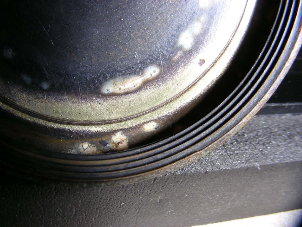

      MichaelG:
      You may yet be right about the solder.
      I've tried to take a better photo having first cleaned part of the area you highlighted:
      I recall learning from a recent post in another thread that solder comes in colours other than the usual silver-grey and if it is indeed soldered this may account for my not being able to distinguish solder from parent metal. I believe I took the possible joint line visible in the photo for the point where the boring tool stopped.
      I take it that even a grossly-overheated radiator is not going to melt solder!
      I haven't done the same with the outside surface as I didn't want to disturb the patina.
      #560202
        Posted by ega on 28/08/2021 22:57:55:
        Many thanks for taking the trouble to check … I’m intrigued by the production methods for items like this [not least because some of my ancestors were brass-workers].
        Regarding the ‘grossly-overheated’ point : I did wonder if this might be a rather unsophisticated attempt at a safety valve !
