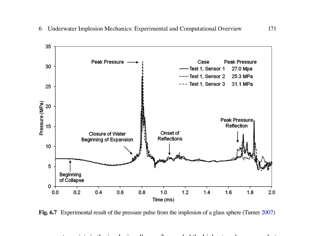

                Of course, I couldn’t resist having a quick skim through
                Unfortunately although the relevance to deep sea exploration vehicles is mentioned, all of the reporting concerns experiments at much shallower depth.
                I am, however taking the liberty of posting this one graph, which I think tells us a lot !
                Whatever clever analysis we might hope to do, or see to be done by others … I think the X-axis pretty-much says it all.

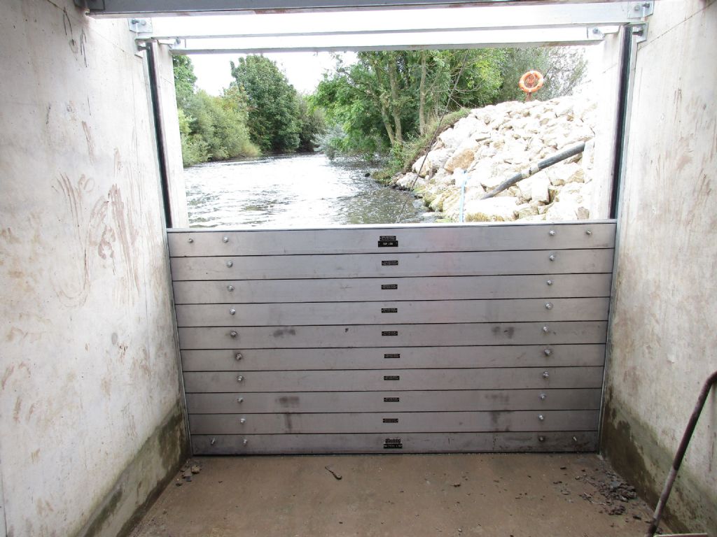

                    Hi, there is a lot of this above my pay grade, but of course the highest pressure is at the bottom of the water column, which many of us had probably been shown by the simple lab experiment at school Old School Experiment so I suppose the implosion could have started at the bottom of the tube, assuming that is what had failed, but of course the actual pressure difference between the bottom and the top of the sub, wouldn't have very much at that depth. Unlike a compressed gas, there isn't an equal pressure in all directions in a column of water. During some of my day jobs, I've been involved in lock gate and stop logs, and the hardest part to stop leakage is at the bottom of them. Below is a photo of one set of two that a workmate and myself, were contracted to install the frames and the logs, in a brand new eel pass on the River Dove, near Stoke-on-Trent. Being brand new, we didn't get any leakage problems thankfully.
                    Regards Nick.

                      Useful input, from a man who knows rather than just ponders !
                      “Unlike a compressed gas, there isn't an equal pressure in all directions in a column of water.”
                      … Thanks for sharing your practical experience, Nick yes

                        Hi, having a quick look through the book Hopper linked too, and seeing how those tubes have flattened out in Fig 18 section 4.2., in my old job, they had a submersible dewatering pump, which weighed about 3 Tonnes, and it would pump water for about two miles, however the 10" PVC pipeline was going uphill for a short distance before dipping slightly and then a very sallow downward long slope to the outlet, this was across a quarry, all was fine and dandy, but when the level of the water got low enough, the pump automatically cut out, which was fine. The problem was when it cut in again, and it pumped for a short while and then tripped several times for no apparent reason, the electrician was called to look at it but found no problems, so it was assumed that something had got into it and was causing to much of a back pressure. So to cut a long story short, we had to look inside the pipeline, and it turned out that where the pipeline reached the highest point, which was a little below ground level for about 20M back towards the pump, about 6M of the 10" PVC pipe had been suck as flat as those tube in Fig 18 mention above. No thought was given to allow air to be drawn back into the pipeline when the pump stopped during installation, I had no involvement in putting the pipeline in, I might add, as it was a contacted out job, but it does show the power of our meagre 14 psi of Air we live in, and a somewhat small amount of water running downhill.
                        Regards Nick.
