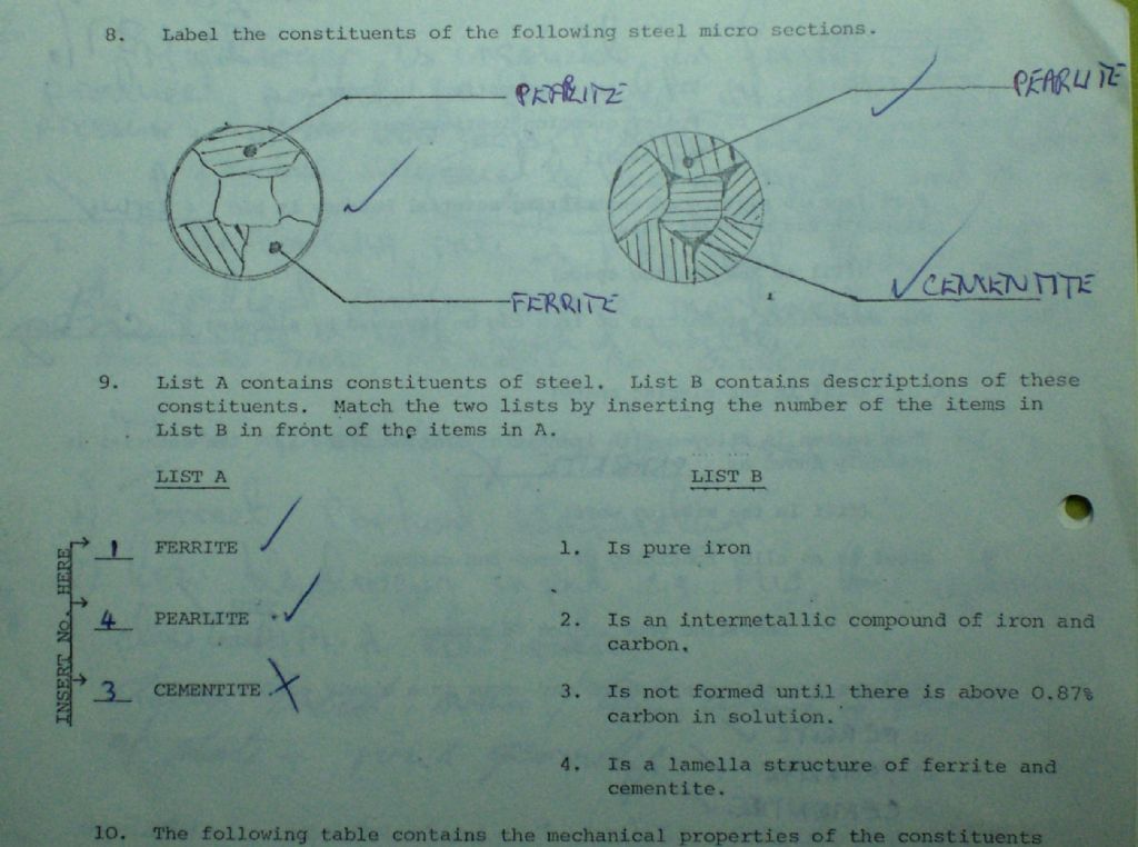

                Hi, my colledge notes seem to becoming more interesting now than they were back in the seventies, when I was studying.
                I have to agree with mgj on iron carbide on the grain boundaries. My dictionary defindes a carbide as; A carbon compound consisting of carbon and a more electropositive element. Well the only electropositive element in steel other than carbon is iron.
                Below is shown part of a phase test in my colledge days.
                Cementite forms on the grain boundaries, and as can be seen my answer was wrong, the only other answer in the list that could have been correct was number 2. i.e. Is an intrmetallic compound of iron and carbon.
                Sounds like an iron carbide to me.
                Regards Nick.

                    Hi, I looked up the meaning of Cementite in my dictionary today (don’t know why I didn’t yesterday) it defines it as ; A hard britle iron carbide Fe2C formed in steel with more than 0.85% carbon.
