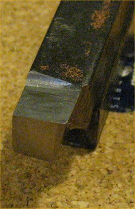

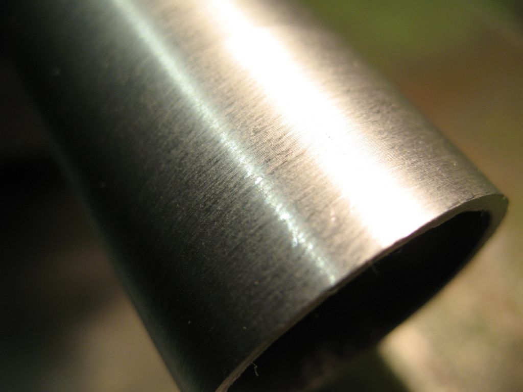

      Hi folks,
      Come across something, well er, different – different to me that is, and I could do with some ideas as to what’s happening. Suspect I know, but am not sure.
      I’m attempting to turn down some tube, provenance unknown. It responds to magnetic strip so would seem to be ferrite based. But I’m having a lot of trouble getting a smooth finish. I ground up a new HSS tool – that didn’t work properly so suspecting an odd (peculiar) bit of HSS I went back to a known HSS tool. And discovered a build-up on the tip, bit like aluminium only the tube is some sort of steel. Actually, the original HSS did work and did cut, but wouldn’t produce a smooth surface. FWIW, it had a steepish back rake, but no side rake wheras the known tool has no back rake to speak of, but does have side rake..
      Photos below.
      This is the tube and as you can see, it’s hardly what I would call smooth.

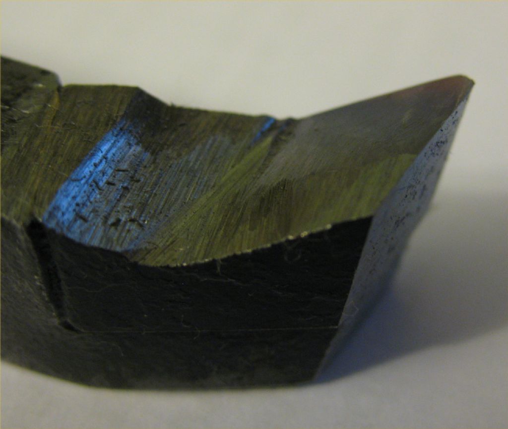

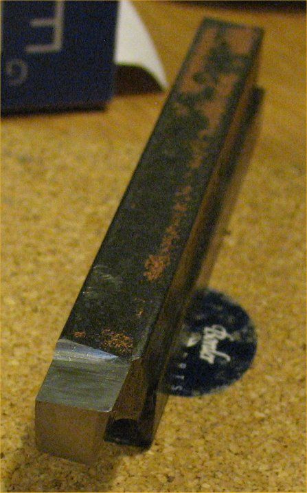

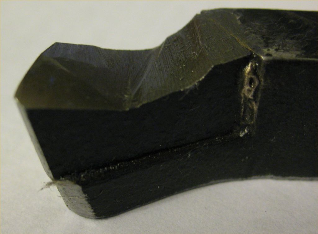

      This is the known good HSS tool.

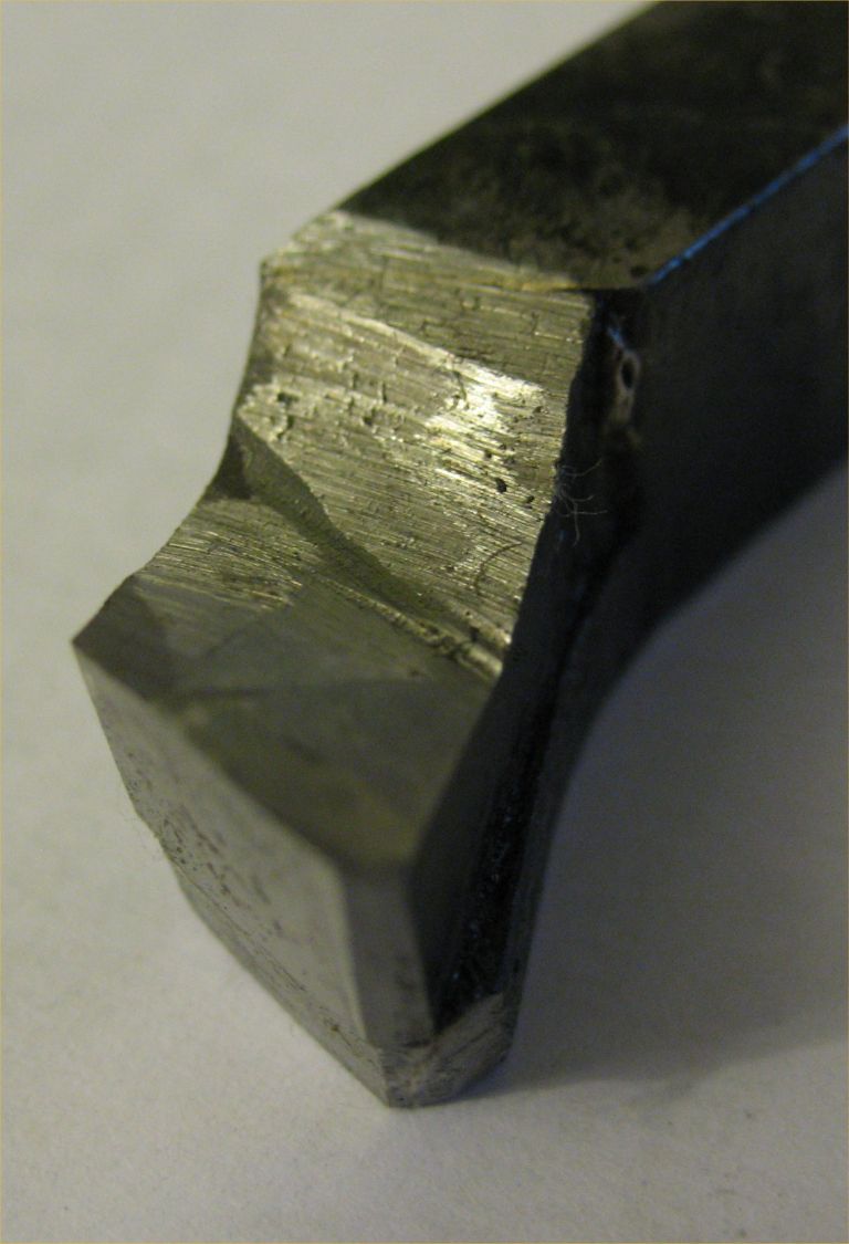

      A closeup to show the actual shape of the tip. Note the slight flat on the front to get a smooth finish.

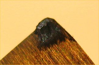

      And finally a closeup of the build-up on the tip. Colours are’nt correct as it’s actually shiny steel, but at least you can see the buildup.
      So, any ideas as to what’s happening? Or should I simply scrap it. I have tried TCT as well, but no difference.
      Regards & MTIA,
      Peter G. Shaw

          Hi Peter
          From my own experience and other’s that I’ve read about on here as well as elsewhere, tube, especially stuff originally intended as water pipe can be a right pain to machine and get a good finish. My only suggestion would be to get the tool as sharp as possible, hone it and get as good a finish on the tool tip as you can. If you’ve tried with suds or cutting oil then, might as well try without as well – and vice versa – covers all bases! If all else fails, get as near size as you can and them resort to emery cloth.
          I don’t know what it is about tube that causes the problem but I do know that the manufacture of solid drawn tube is a pretty brutal process, so I’m not surprised at any stresses locked up in the metal, and I doubt if it gets heat treated after forming unless it’s by special order at a special price.
          Keith

              Hi Peter,
              Steels will produce a built up edge to a lesser or greater degree as well as aluminium, and this will cause the tearing of the surface as obviously when the material builds up on the tip of the tool it is no longer sharp. I won’t go into detail about the way in which material is removed while turning except to say that it is a shearing process, not like the cutting process we commonly think of. The sharper the tool, and the better the rake angle, the smaller the shear plane will be and the better the finish.
              The surface finish is related also to the shear properties of the material. The softer and more tenacious the material (like annealed copper) the more likely is a poor finish. You can improve your finish by having a sharp tool with a rake angle at the higher end of the range for steels, or even a bit greater.
              The built up edge will quickly make the tool effectively blunt, increasing the length of the shear plane and tears the material more than it should hence the poor finish, and any build up must be removed frequently, (ideally before it forms). You can hone it with a diamond file. Help to prevent the built up edge by using copious amounts of cutting fluid to keep the tip lubricated which will delay the formation of the build up. Small cuts, slow feed for the finishing will help but you’ll never get a mirror finish as with free cutting steel but it can be made quite presentable with care.

                  Hi Peter,
                  By the way, I forgot to add that it helps to reduce build up of the tip of the tool by keeping the top surface as polished as possible. I have been known to use the finest wet and dry I had, used wet (1200 grit) on a flat plate glass surface and then final polish on a polishing buffer using a fine crocus compound or similar.
                  I would expect to be able to cut paper using the tool like a Stanley knife.

                    Hullo Peter
                    I don’t think the problem lies with your tool so much – though I do agree it could have a bit more side and back rake but with the tube material itself. Is it welded or drawn?
                    Are you getting any chatter or ringing as a matter of interest – that won’t help the finish either.
                    Most ‘tube’ is notoriously ‘awkward’ to machine – it tends to be rather ductile and very ‘claggy’ (local term) to machine – a bit similar to machining sheet steel. I’d say that’s the cause of the build up.
                    If that is the case then theres not a lot of options, you could spend a lot of time trying to achieve a finish on it even with all the suggestions – personally I would bite the bullet and use some better material.
                    Sorry to be so negative but never found a real solution to this problem other than has already been suggested – messing around with rakes, speeds and feeds and cutting fluids. Quite time consuming and not always successful.

                            I suspect that the hollow tube flexes as the tool passes over it, as I mentioned in another thread, if its water pipe, its a right pain, yet given another bit of pipe and it cuts like a dream. The biggest trouble i’v had was boring a bit of two inch water pipe, cut out the weld bead and started into the pipe propper, and “pop”the pipe opened up 1/4” as the weld let go. Took it out of the lathe, squeezed it up and ran a weld down the outside with good penitration, put it back in the lathe and finished boring, then I lapped it, and it became one of my better hot air engines. The weld’s still there, looks pretty good compared with my normal welds.

                                            My first instinct would be to try coated (any coating for iron metals) carbide bit and run the heck out of it. Least 3*rpm you are using now. I probably would try pretty deep cut as well even on the expence of feed.
                                            My reasoning is that more ofthen than not I have got rid of build-up by increasing the speed.
                                            Another thing: Some HSS/work material combinations seem to more prone to “welding” due to HSS composition I guess….different tool material might help when geometry/speed/feed trinity does not manifest any appreciable improvement.

                                                  I did initially use a TCT tool, but not very good. I do suspect I wasn’t cutting deep enough anyway, but I was conscious that I didn’t have that much thickness to play with. Agree about using higher speeds, which I did try – I seem to think about 710 rpm.
                                                  178rpm is only as advised by Tubal Cain using HSS on tougher steels. If using TCT, he does recommend using 50% to 75% faster.
                                                  ‘Good’ tool versus ‘bad’ tool are purely descriptive. The ‘good’ tool is one that was bought ready formed and whilst it has been re-ground, as far as I can tell, the angles are more or less as bought. The ‘bad’ tool is an attempt to make a tool as per Tubal Cain’s sketch ‘E’ on page 5.5 of his Model Engineer’s Handbook Third Edition. (Different page nos in earlier editions.) These photos show what I ended up with. It’s a piece of HSS brazed onto a MS shank. Sorry about the slight fuzziness of the photos. As you will see, it’s hardly a text book piece of grinding, and yes, a tool & cutter grinder is on the ‘want’ list. However, despite the ugliness of parts of it, I did hone the relevant parts that do the actual cutting and swarf removal.
                                                  Strangely, it does actually work, and there wasn’t that much difference between the two tools, except that the good tool developed the tip build-up. Which perhaps suggests that more rake would have been better.

                                                  mgj
                                                    @mgj
                                                    I’m always interested in htis comment that carbide likes going fast. Because of the geometry and heat/wear resistance it will certainly take going fast – feed most tipped tools don’t like much compared with high raked ground HSS. I just chomp away at ordinary HSS speeds and feed simply because that is the speed I’m most comfortable working at.nor am I under production pressure, nor do I have a desire to beat the c++p out of my lathes.
                                                    Somehow my carbide tips work extremely well, give a (very) good finsh and last a long time.
                                                    Carbides in there. Doesn’t all steel contain iron carbide at the grain boundaries – well all non stainless anyway, and even stainless does so long as it is not in its normal austenitic condition? Yes? Isn’t that what steel is?
                                                    HSS seems to cope pretty well with cast, and there is a LOT of iron carbide in that. Thats what all the black stuff is. – yes?.(Not the cheapo tool steel around lately, but proper stuff with a real brand name and price on it)
                                                    Some materials do not shear well, particulary these bendable ductile metals – for very obvious reasons. It isn’t a matter of quality usually, if supplied by a reputable dealer to a spec, its just the property of the material.
                                                    Be careful of large rake angles in stuff like ERW and CDS and other pipe type .
                                                    steels, because they are very prone to grab.
                                                    What does cut them pretty well are negative rake (tipped ) tools, again for very obvious reasons. You are not getting a tendency to dig in and increase the depth of cut within the backlash of the feed screw, because they generate an outward vector. A suitable tip would be one of the W series. Tipped toolholders suitable for small lathes are hard to come by, so you could grind up a negative rake tool (and use it later for brass bronze copper, like we all should but never do!). Polish – if you are grinding on a tool and cutter grinder with say 100grit, you would be pushed to beat such a surface, and you’ll be there awhile. And its very difficult when polishing to hold angles correctly – so I might skip that approach.
                                                    Because of that outwards vector, on a smaller lathe a travelling steady would be good to stop push off.- low speed, lots of coolant, negative rake tavelling steady and you should get an acceptable result which can even be quite good with the application of a bit of emery afterwards.
                                                    If you get a bit of singing – a collar along the length usually will alter Fn of the bar adequately, but a better answer is usually, given a sharp tool, to increase cut or feed, or the pressure of the travelling steady. Singing is usually a high frequency/small movement phenomen, so if you can do something to alter either the frequency or the small movement bit, it often goes away.
                                                    The best thing of all is to understand why it’s tearing – usually (but not always of course) a soft material and something allowing mini “dig ins”. Rake angles and a touch of slack in the mechanism. Do the opposite and mostly the problem goes away. But unfortunately not always. Sometimes the material just doesn’t want to help.

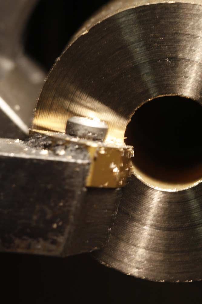

                                                      Our posts crossed. Wonderful piece of grinding Peter. Possibly unrepeatable, and good to hear it did the job.
                                                      For info this is a carbide insert specifically for that sort of task – note the rounded nose, and the negative rake. The cutting angle is just the thin rim round the edge, the rest is the chipbreaker which is not essential of course A flat surface in HSS at that angle would be fine of course, but the chipbreaker is handy with some materials.
                                                      Perfect for the bronzes/brasses, because it won’t grab or tear.
