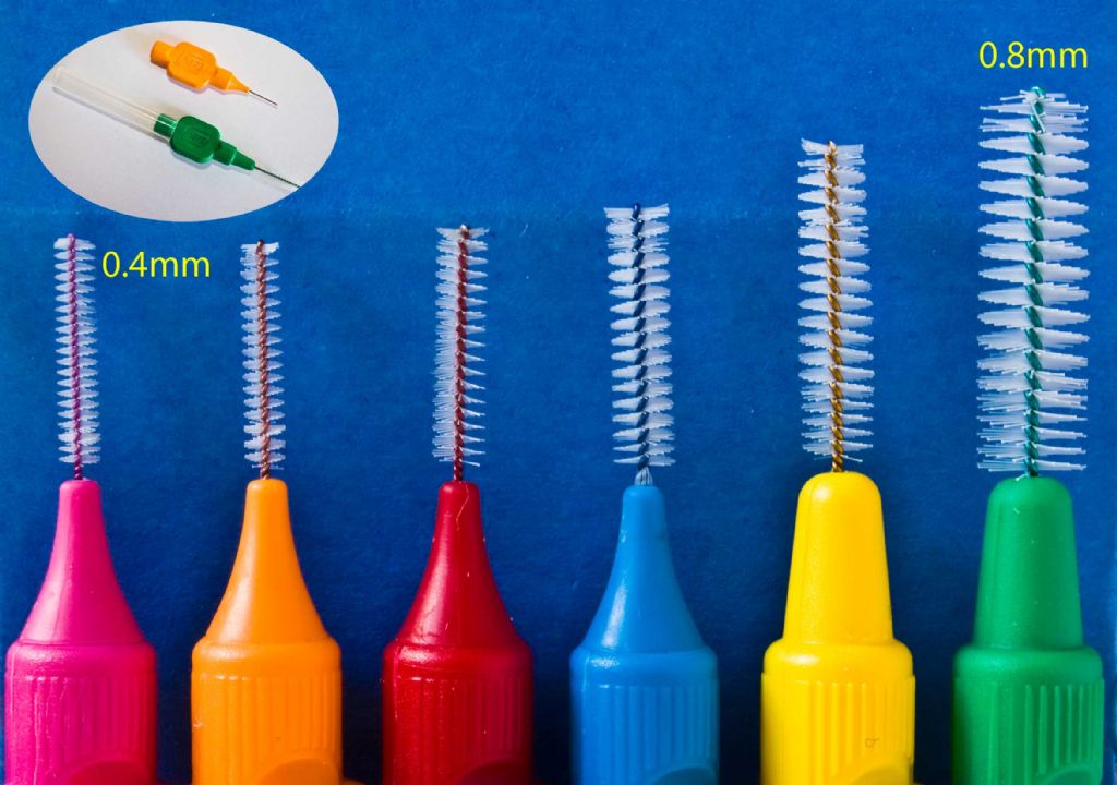

      Approaching completion of my clock, I have at times resorted to using toothpicks, BBQ skewers, cotton buds, and various other `household’ implements.
      I found these at the local chemist.
      They are called Interdental Brushes, and have proved most useful in poking out dirt from the smaller pivot holes in my clock frames.
      A `mixed pack’ of six cost about AU$8, and their size range is noted as 0.4mm to 0.8mm. However, that appears to be the size over the twisted wire, since the largest (0.8mm), is 5mm overall diameter measured over the bristles.
      The inset shows their full shape, and a handy little extension piece.
      Regards to all,
      Sam

          Hi Sam
          Absolutely brilliant Sam.I am doing a ‘wheels up’ rebuild on a Douglas 10″ Shaper at the moment and these will be perfect to clean out the oil holes.
          Wondered how I was going to do that
          Problem solved.

            Hi Phil,
            I’m pleased to know someone else can find a use for them.
            The packet is marked `Made in Sweden’, and there is a recommendation on the back of the packet that the brush itself should not be bent back and forth.
            Although I haven’t determined what material the bristles are made from, I suspect that they are Nylon.
            There’s a fair degree of (relative) stiffness in the twisted wire, but clearly, it would be wise to take care to avoid breaking any in your oil holes.

              Thanks Sam,
              the plan is to first use a drill bit by hand then spray some ‘Tool Cleaner’ in the hole, blow this out with air then a final sweep with the brushes. Shafts out of course. The ‘Tool Cleaner works well but there always seems to be something left.

                  Then you probably won’t like my suggestion for perhaps slightly larger brushes. For some years now I’ve been using the ladies’ mascara brushes for cleaning tapped (and plain) holes from around .100″ dia up.

                      I keep a mascara brush in the container of Copper Cote anti sieze. Three sizes of bottle brush, I think the smaller of those is a test tube brush, and its a good idea tohave a tooth brush in with the taps and dies.

                            Cotton wool buds are good for getting swarf out. Dip in grease, insert into offending orifice and withdraw along with swarf.
                            The interdental brushes work well for dilodging jammed bits. By the way- always be nice to your dentist-
                            1 It hurts less !
                            2 The have old dental probes which are great for extracting things from holes, cleaning small internal threads etc.

                              On the subject of brushes, i use one of the brushes that women use for putting on hair dye, for lots of small cleaning jobs. They have just one row of bristles,about 1 1/2" wide, and are great for cleaning "T" slots ,and lots of other small cleaning jobs

                                The interdental brushes always struck me as being of use in cleaning injector cones.

                                    Brushes in general: don't forget those round bottle brushes. You can shove them down holes that are a fraction of the brush diameter and they wil scour the hole clean (especially dipped in solven first). Great for cleaning out a long bore on the lathe. I have a 2" dia one that I use to clean chuck bores with. I must have several dozen in various sized hanging on hooks around the shop.
                                    Dollar stores (Pound stores?) are a good source or hardware stores, surplus stores etc. I think one or two of mine came from Wal-Mart. I never turn down the chance to buy one.
                                    As well as bristle or nylon you can get them in brass in some places. As with all "brass" brushes though, make sure you know what you're getting. Many are brass plated steel (which will affect where you want to use them). Check them with a magnet.
